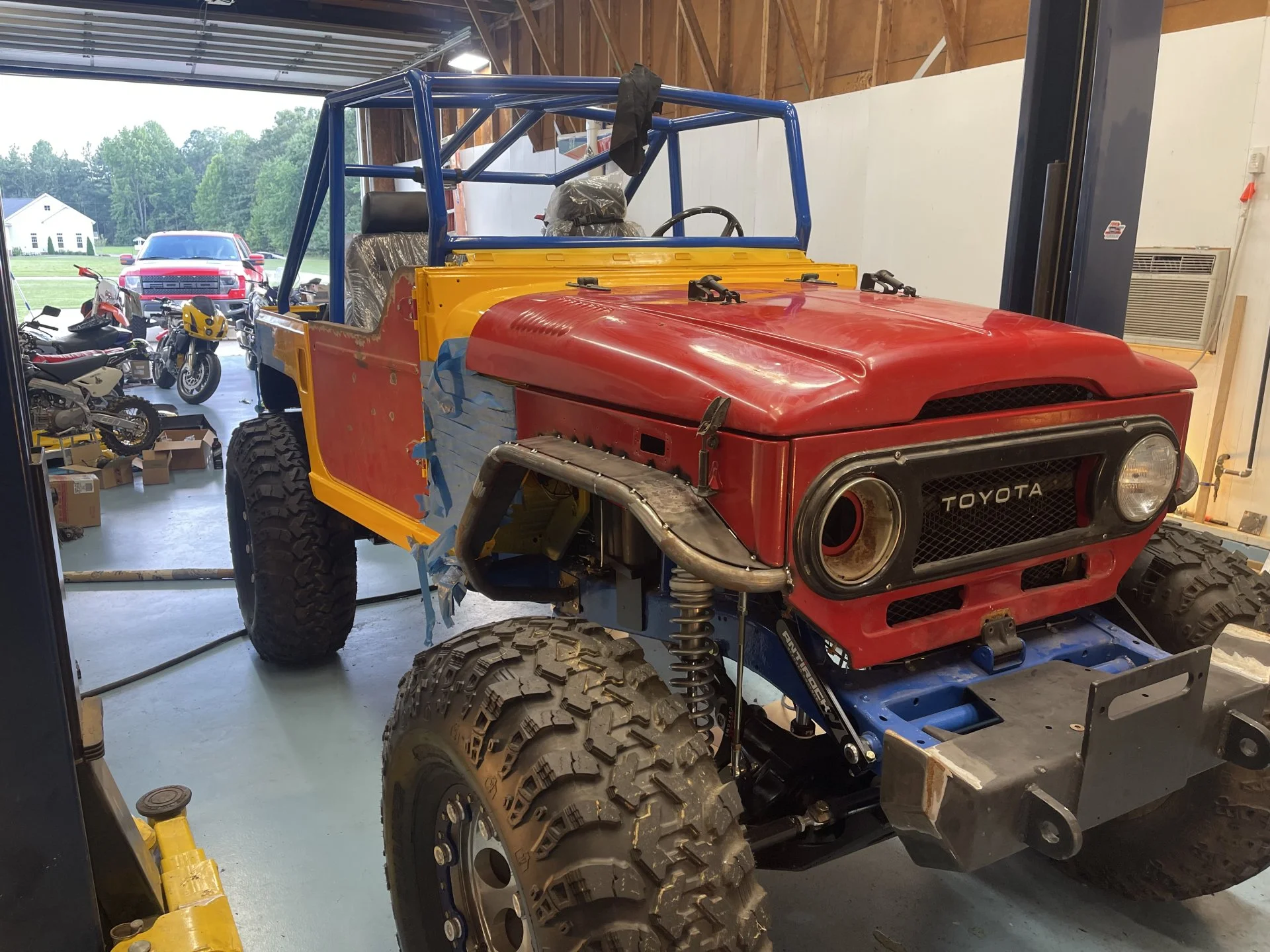

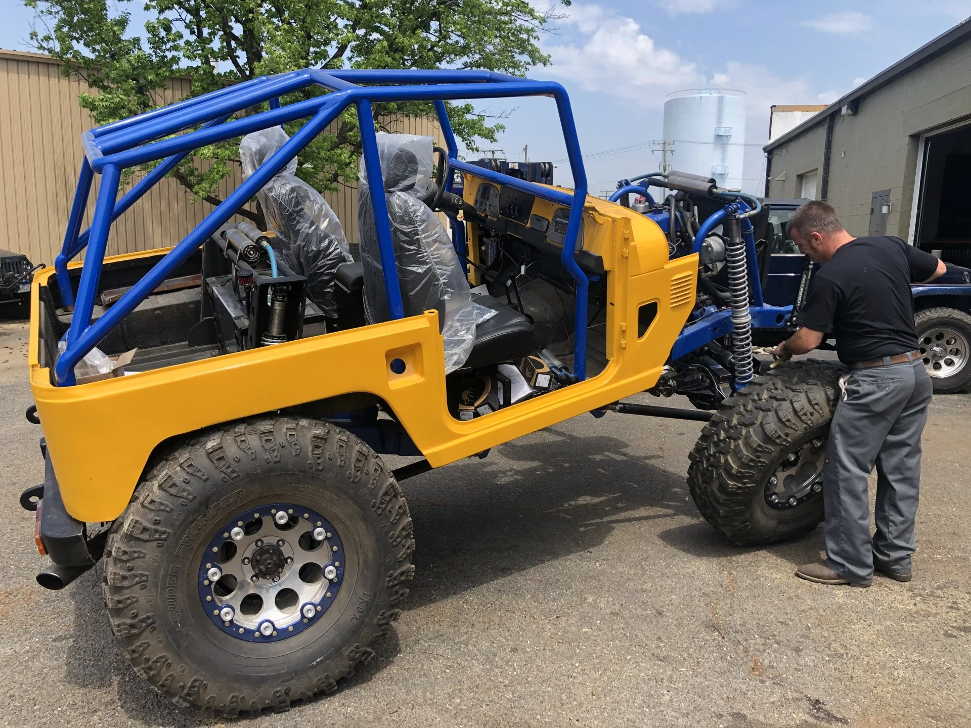

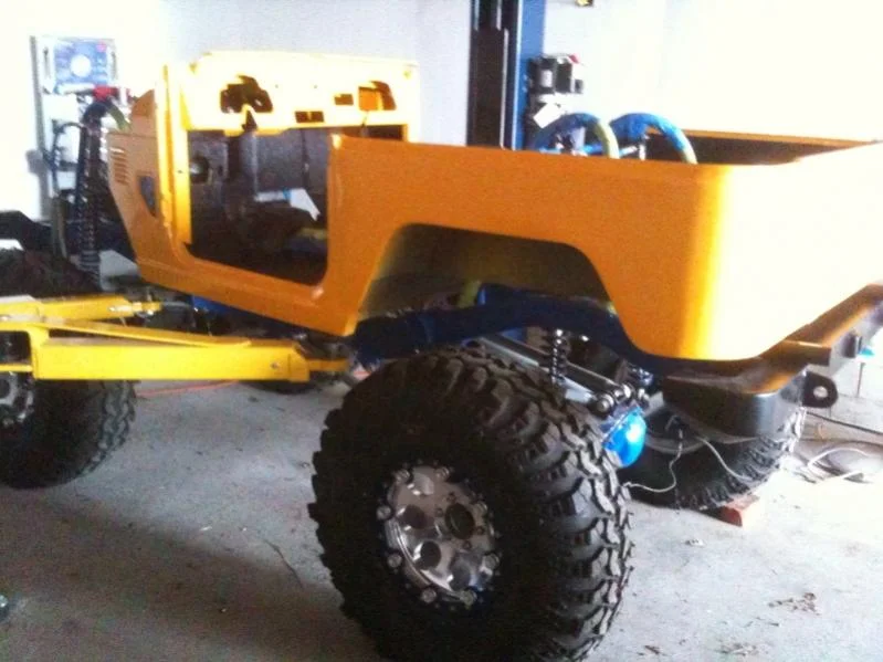

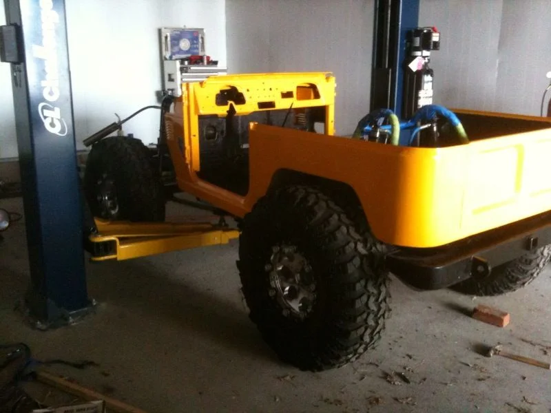

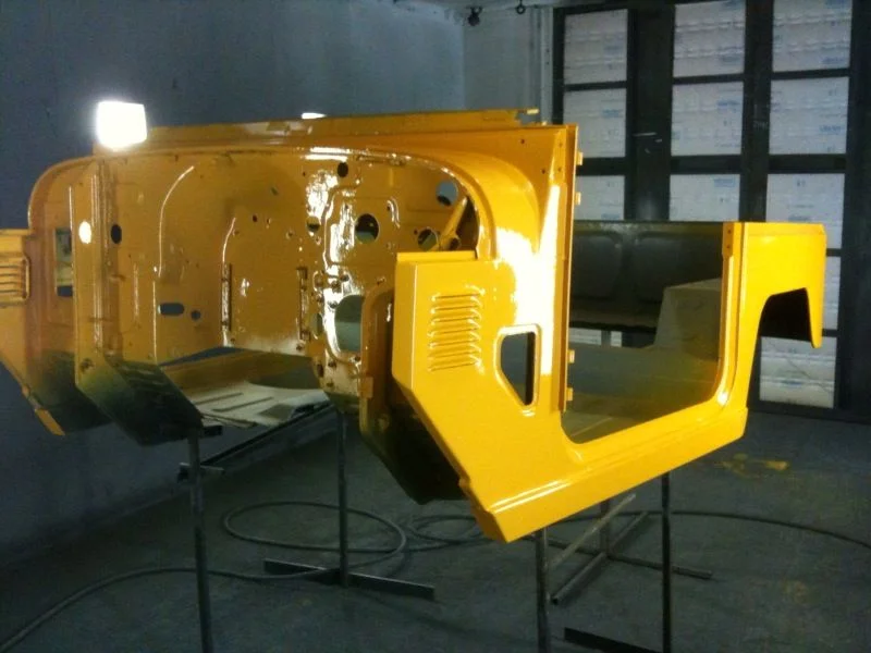

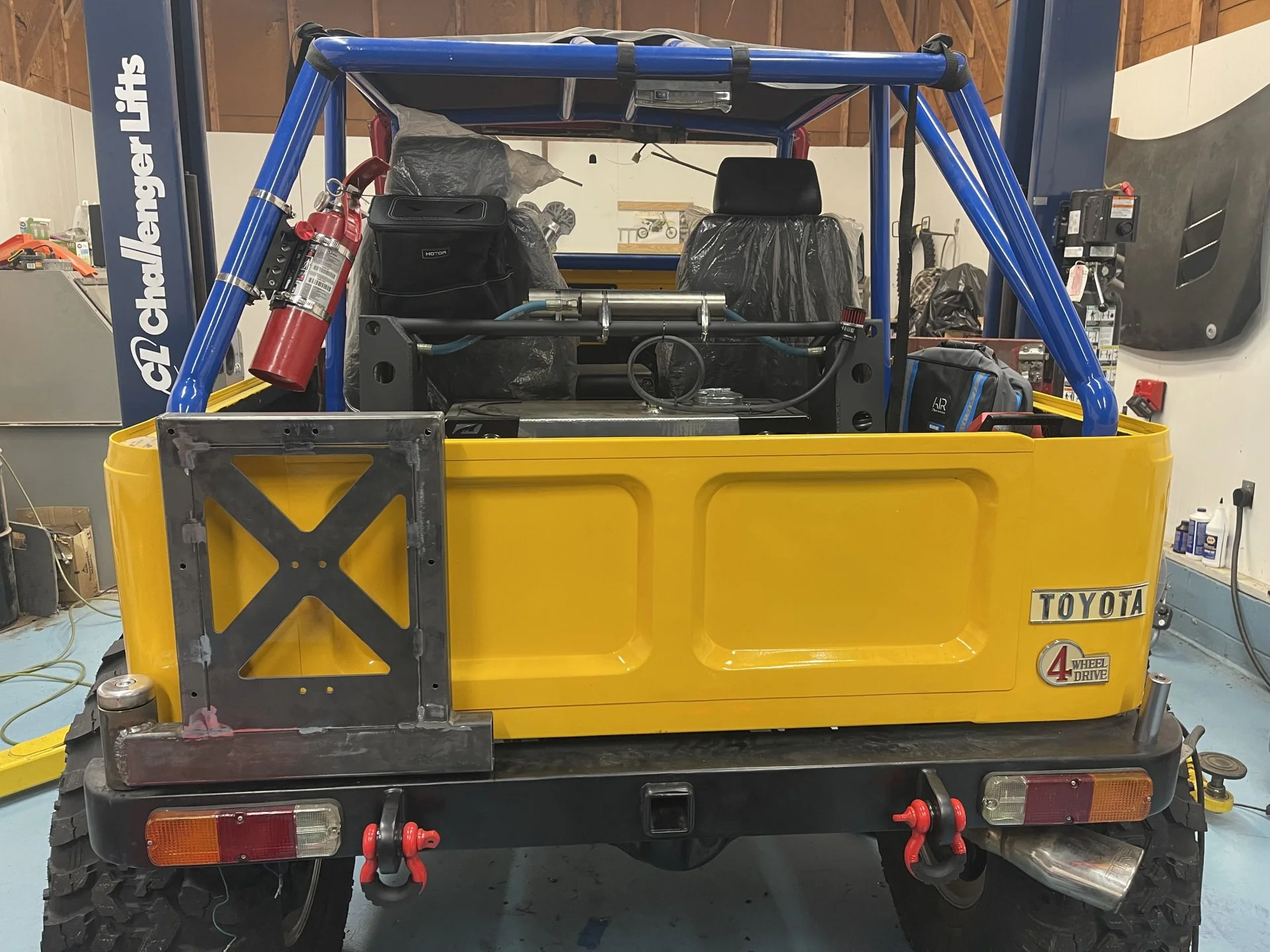

well its been a long time sence i posted anything. I finally got all the body work done and stuck on the frame.
DROOOOOOOL!
Looks effing great man!

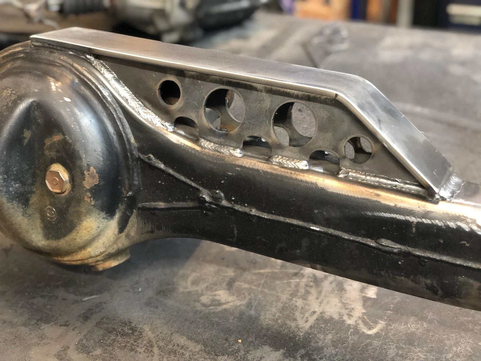

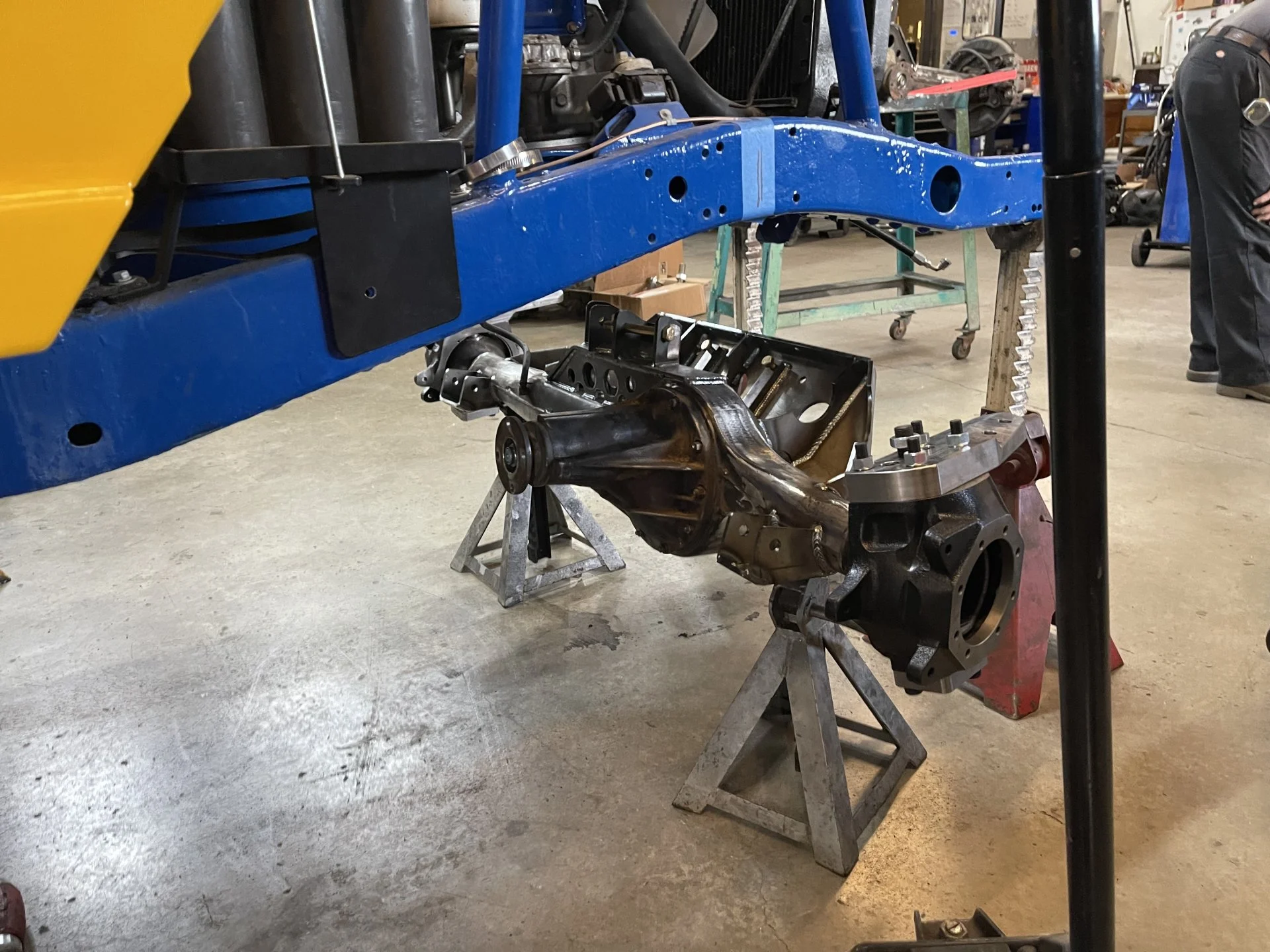

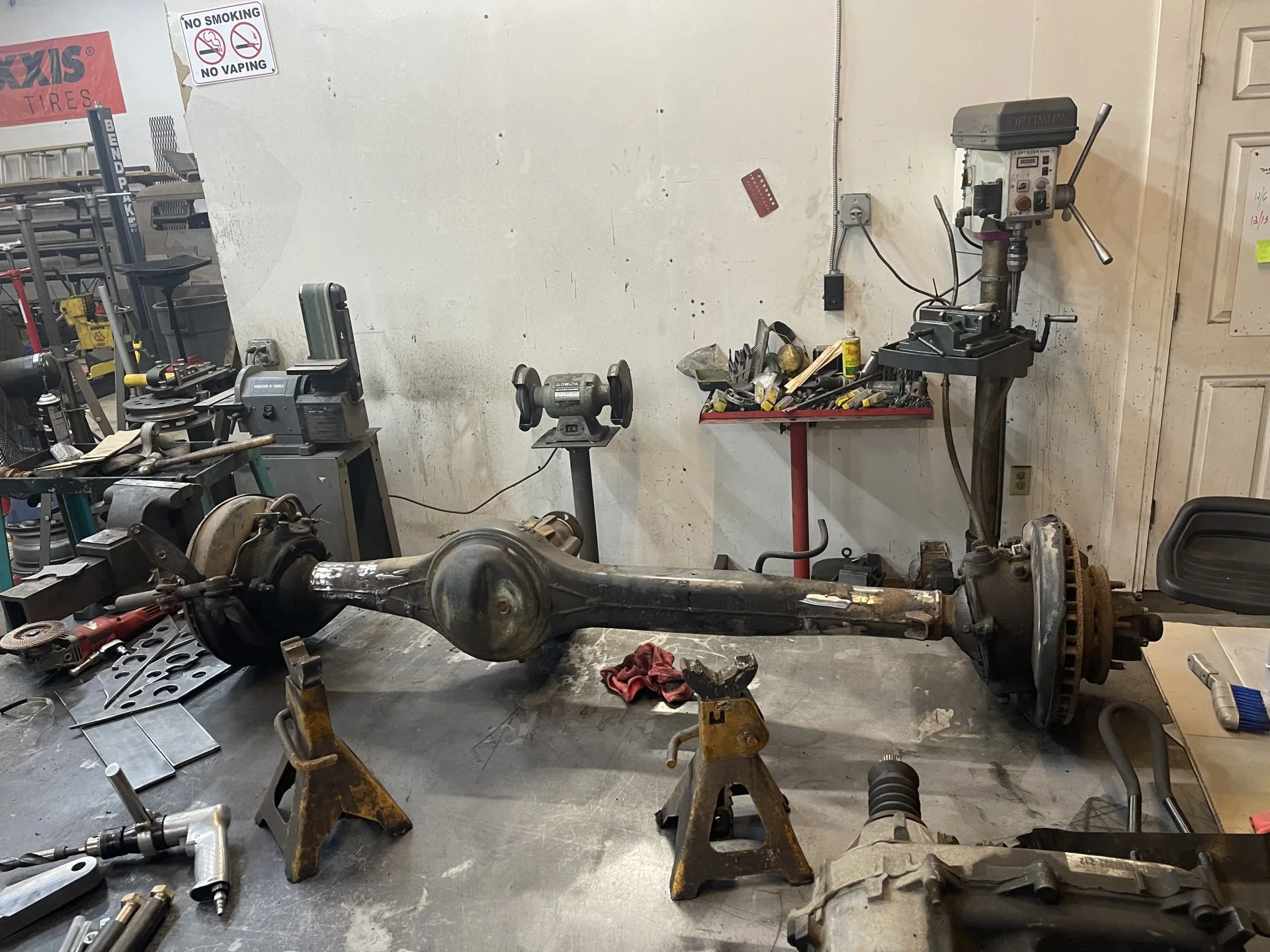

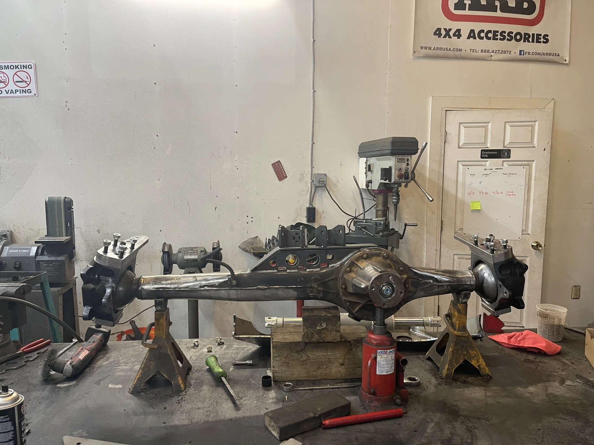

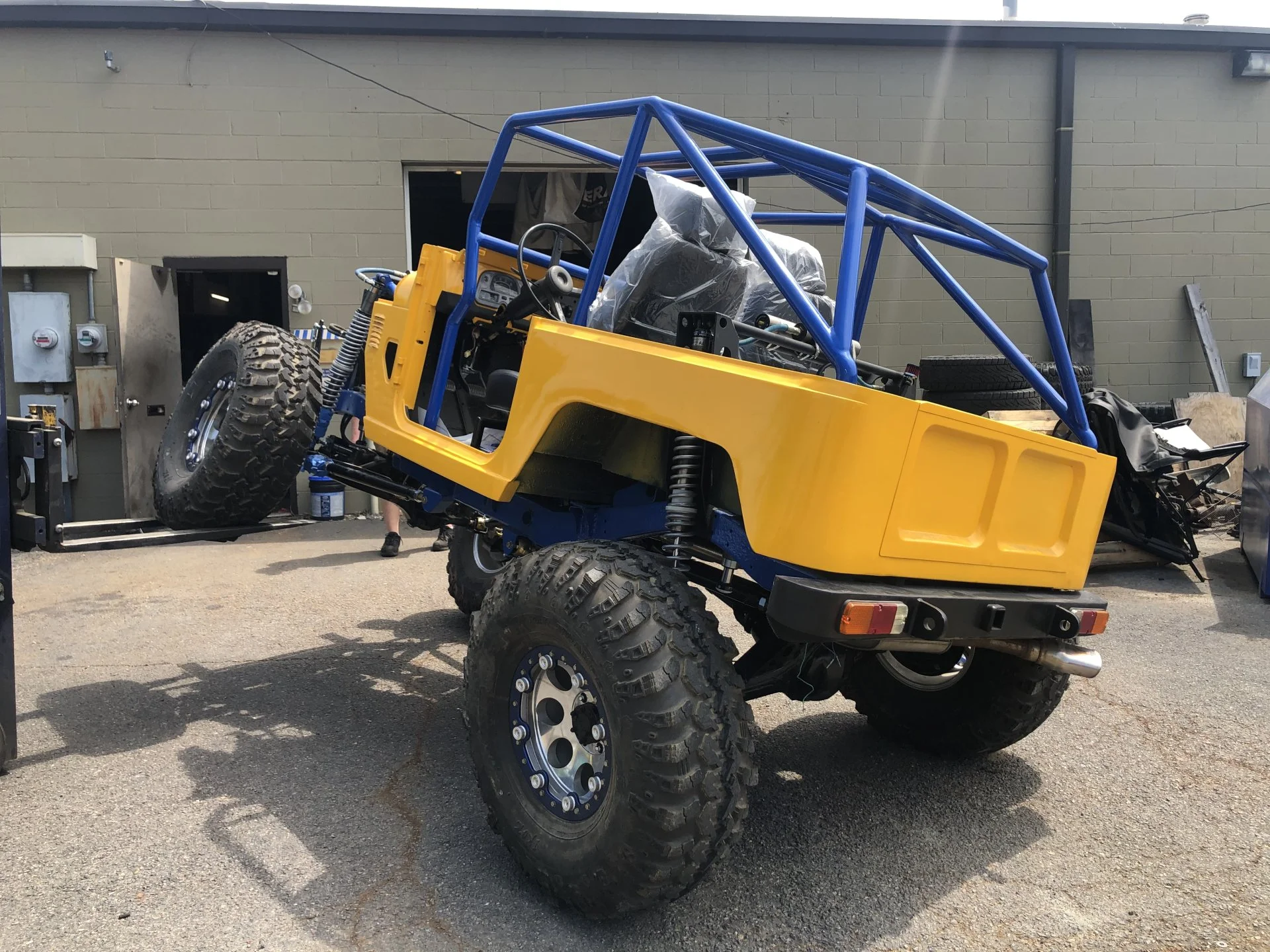

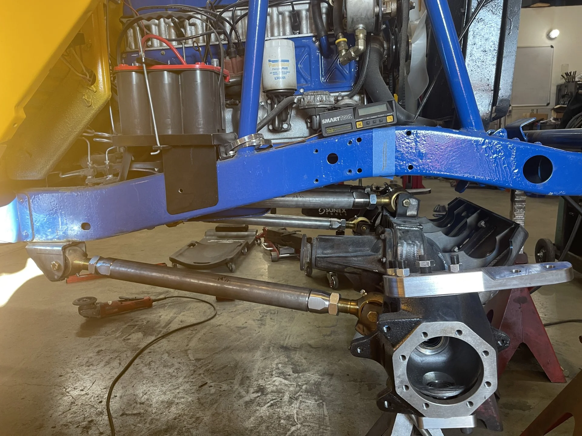

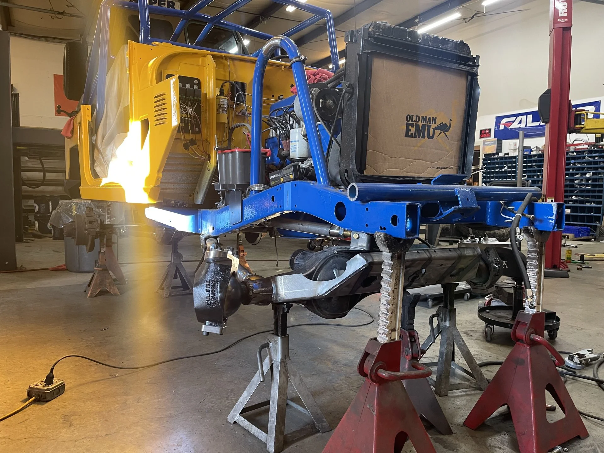

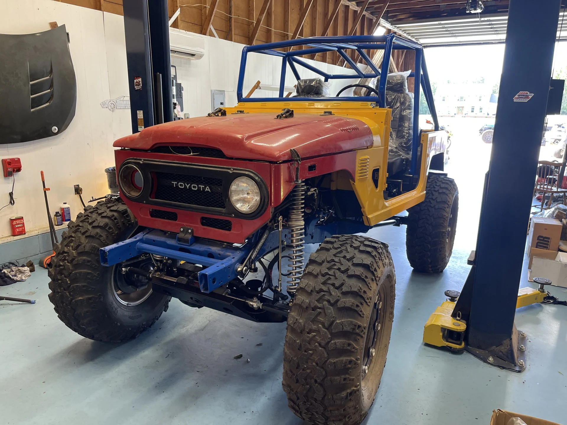

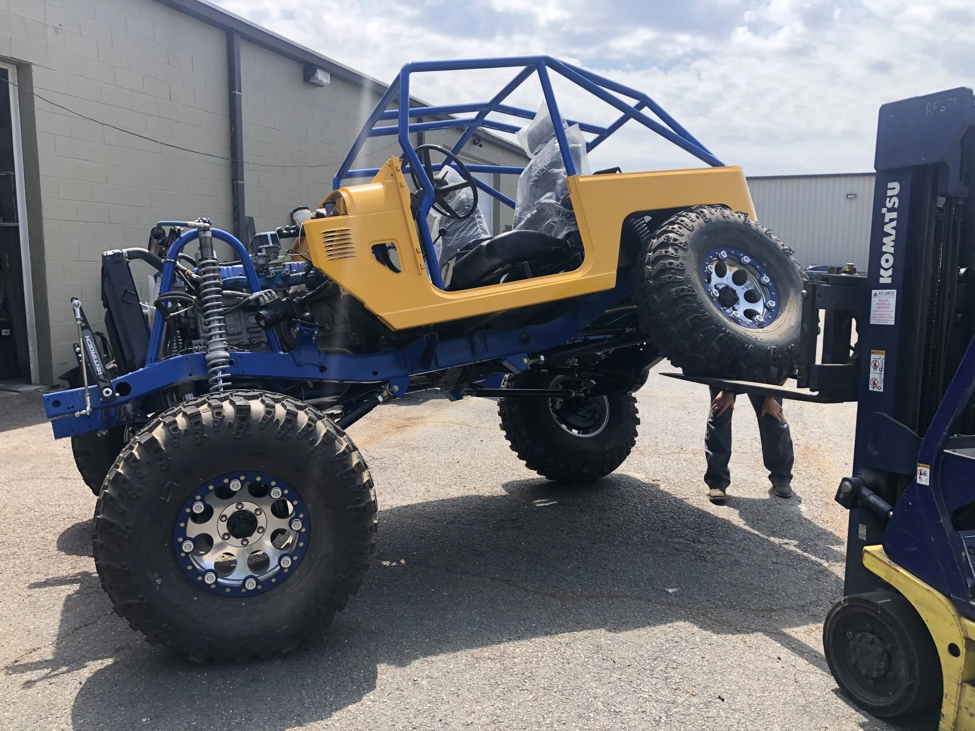

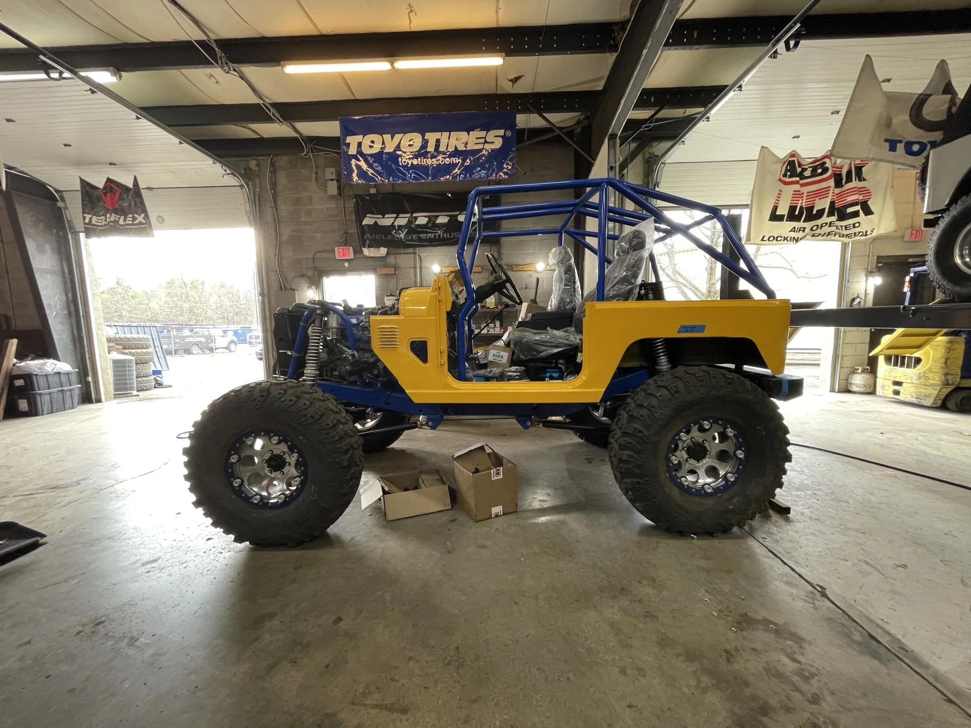

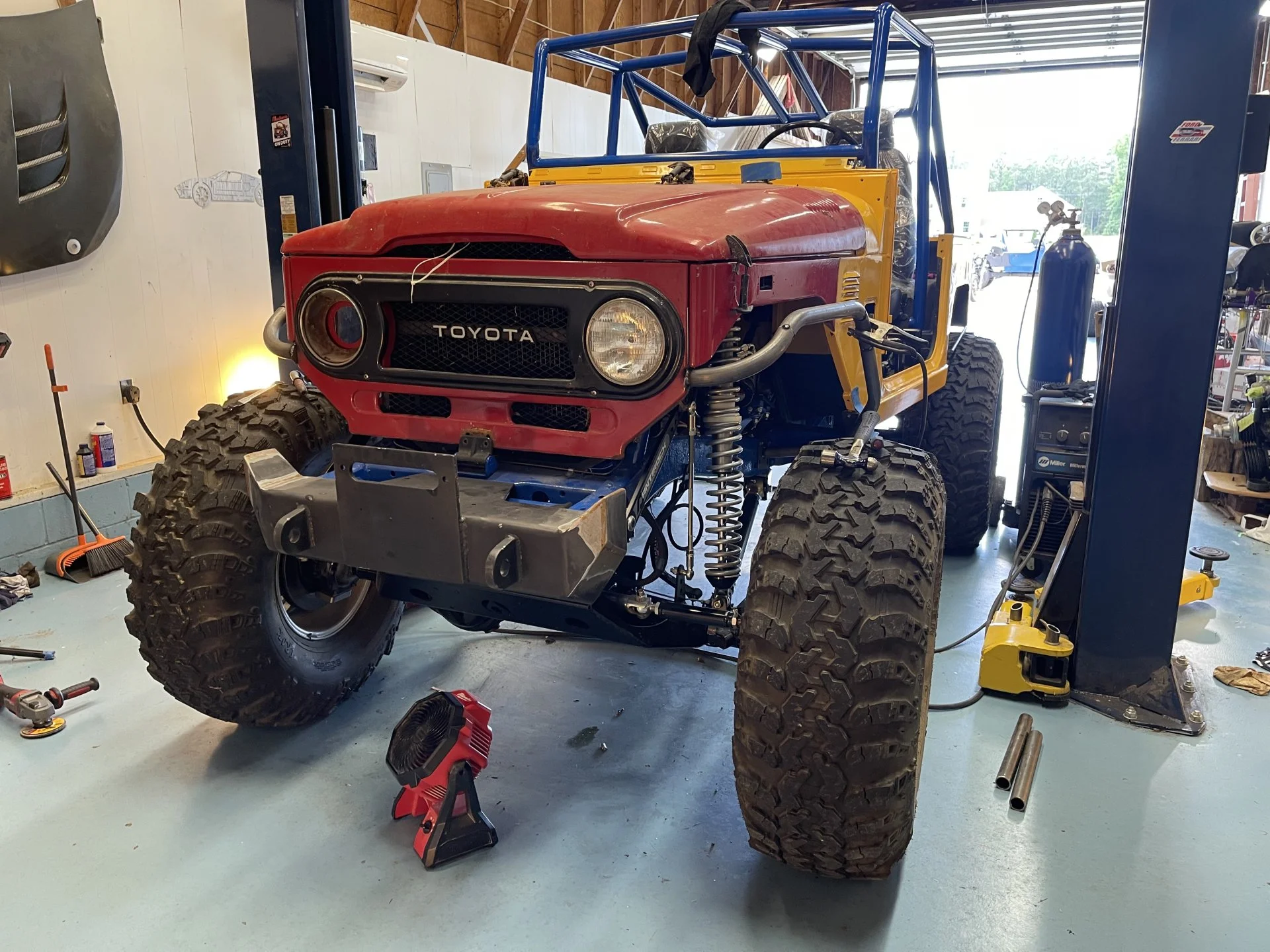

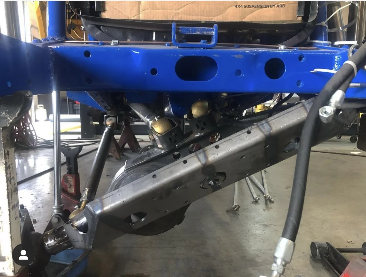

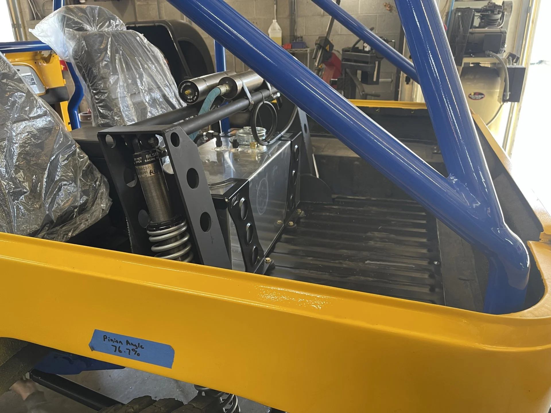

Well it has been years sense I posted anything about this build. A ton has changed. I swapped to 80 series axle, 5.29 gears and ARB air lockers added. When the axles were swapped I had the 4 link re done front and rear.

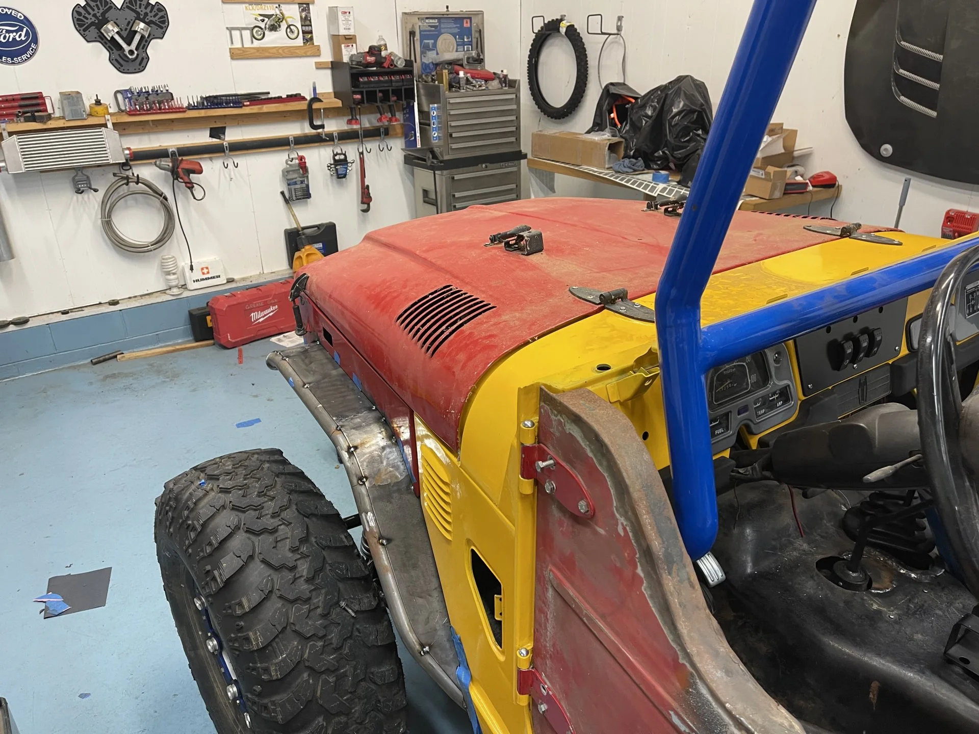

Lowered the ride height and Added a sway bar to the front axle. Testing out the flex. The rear wheel wells have been trimmed again to allow more tire clearance.

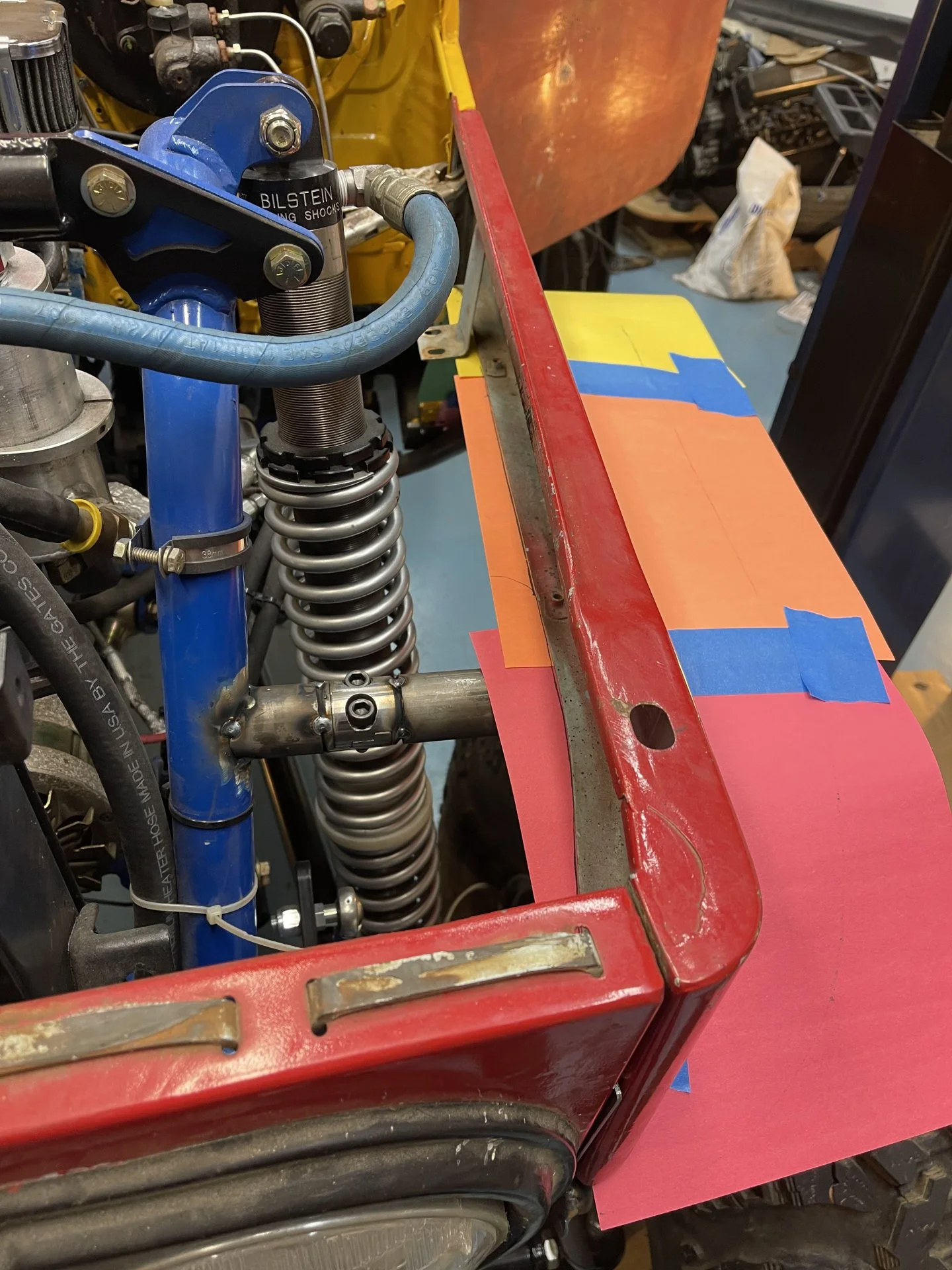

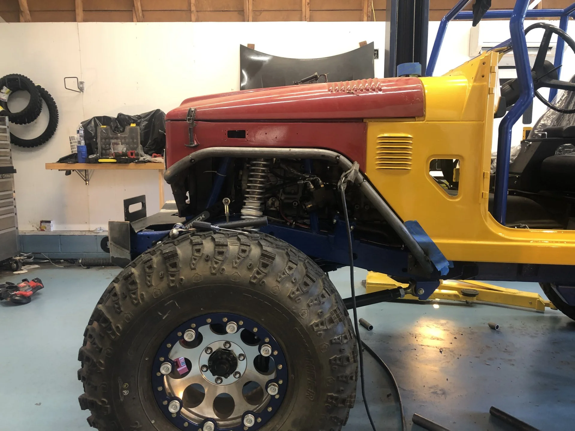

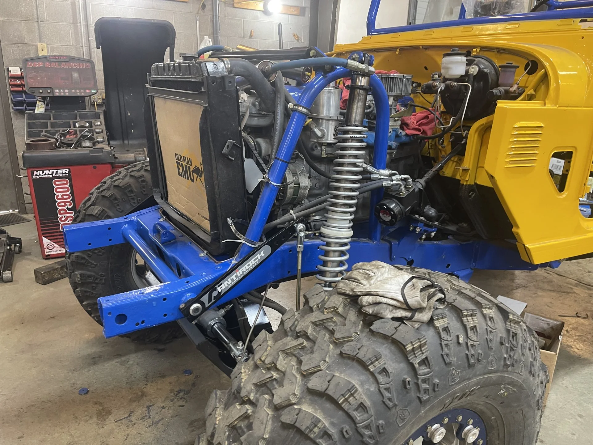

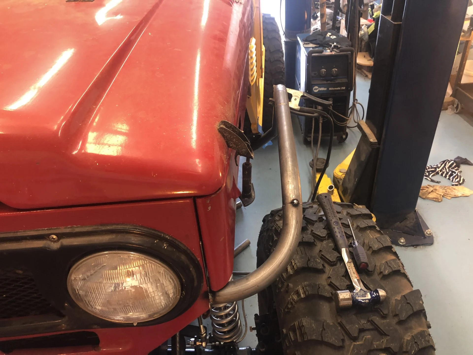

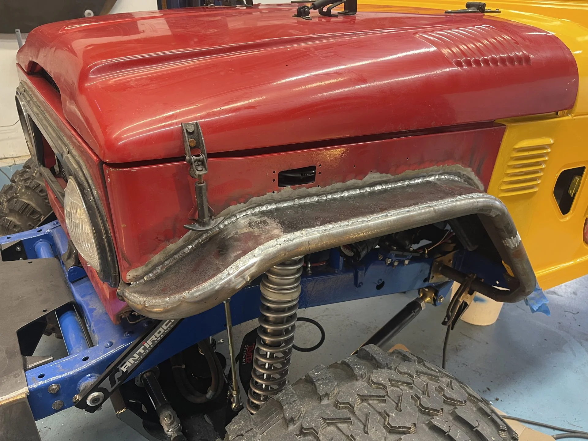

Assembled the front end so I could start making new front tube fenders.

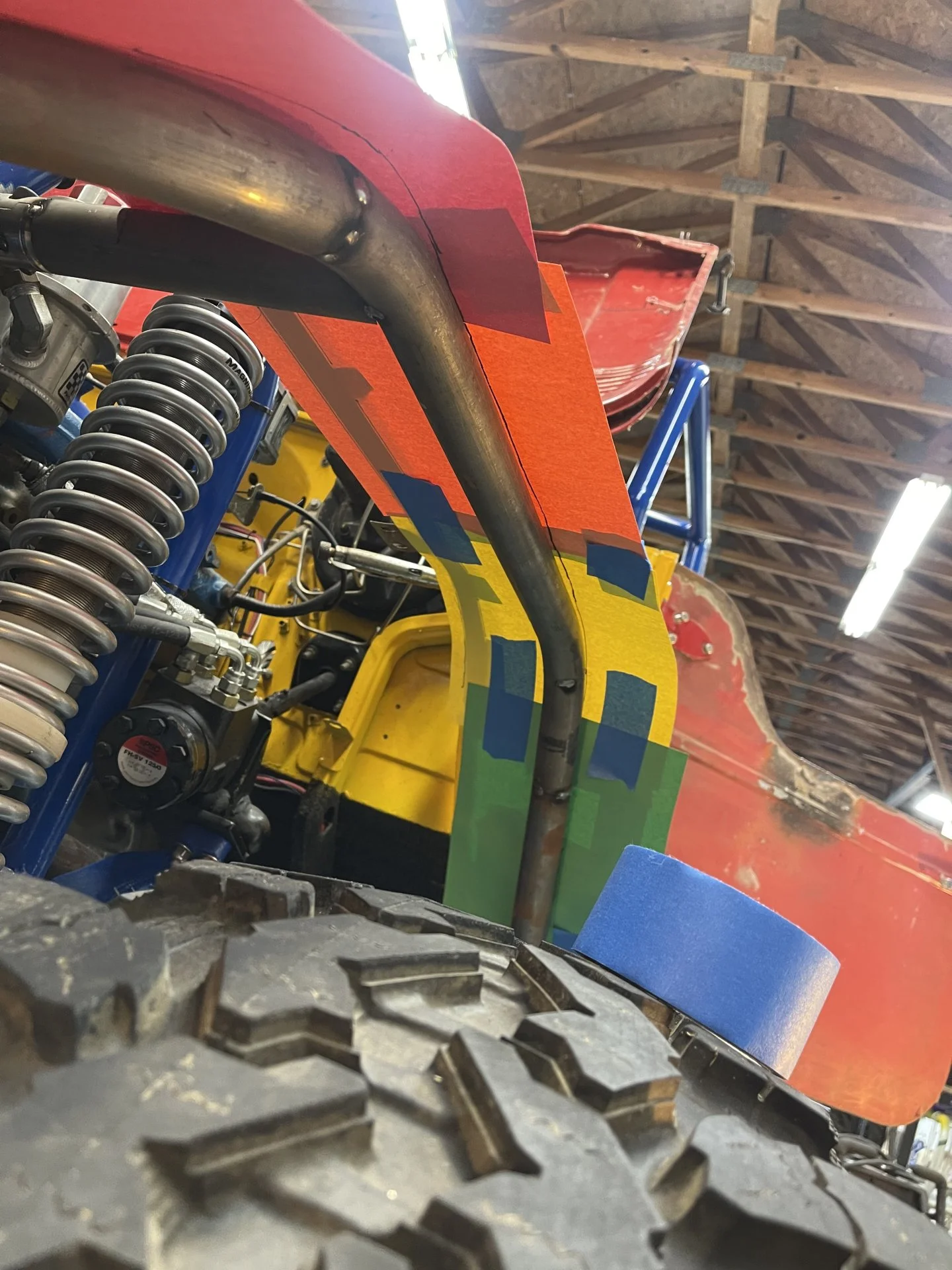

Made a paper template so I could cut out 1/8th steel plate and pre bend it before trying to fit it on the tube fenders.
