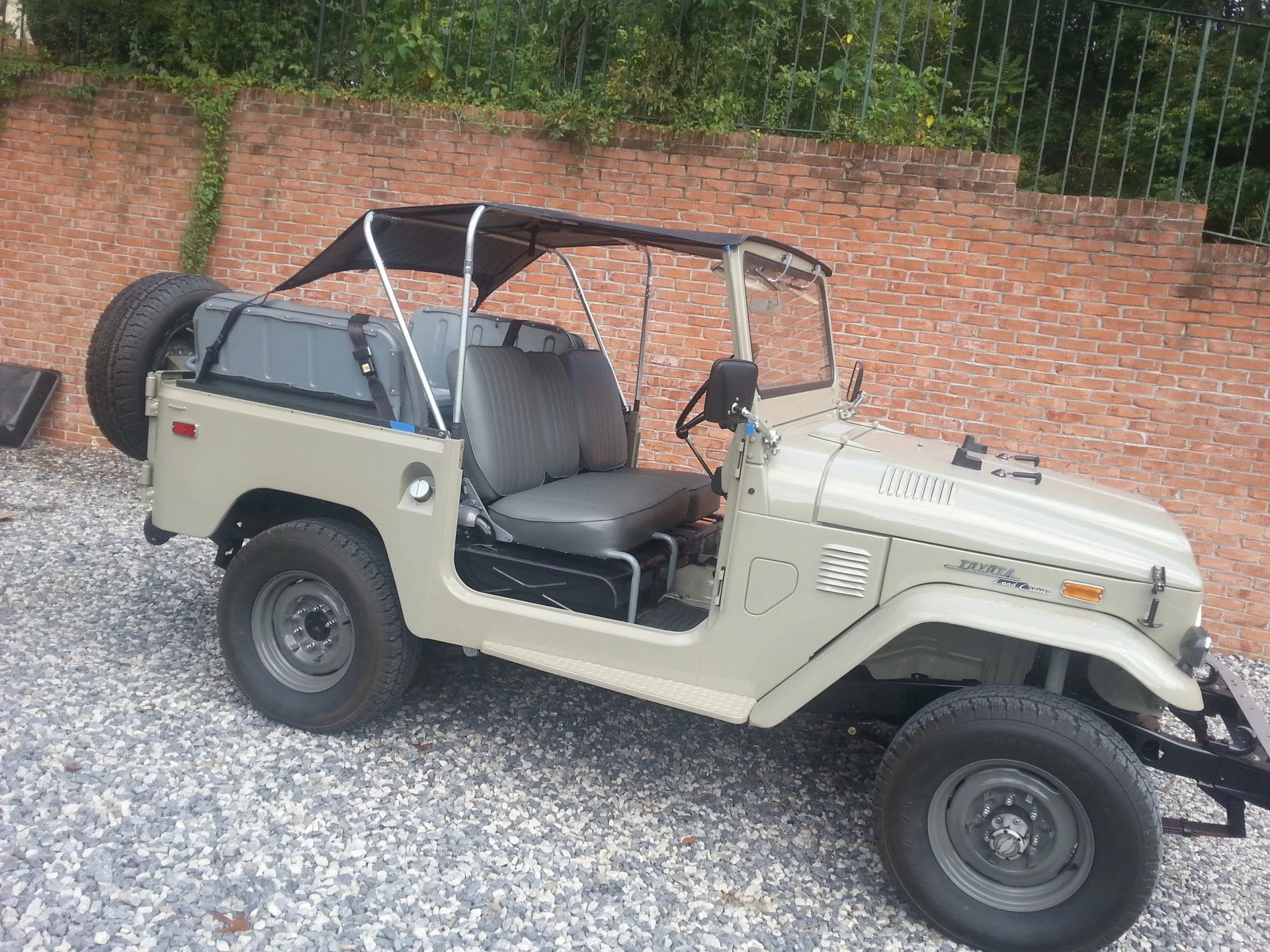

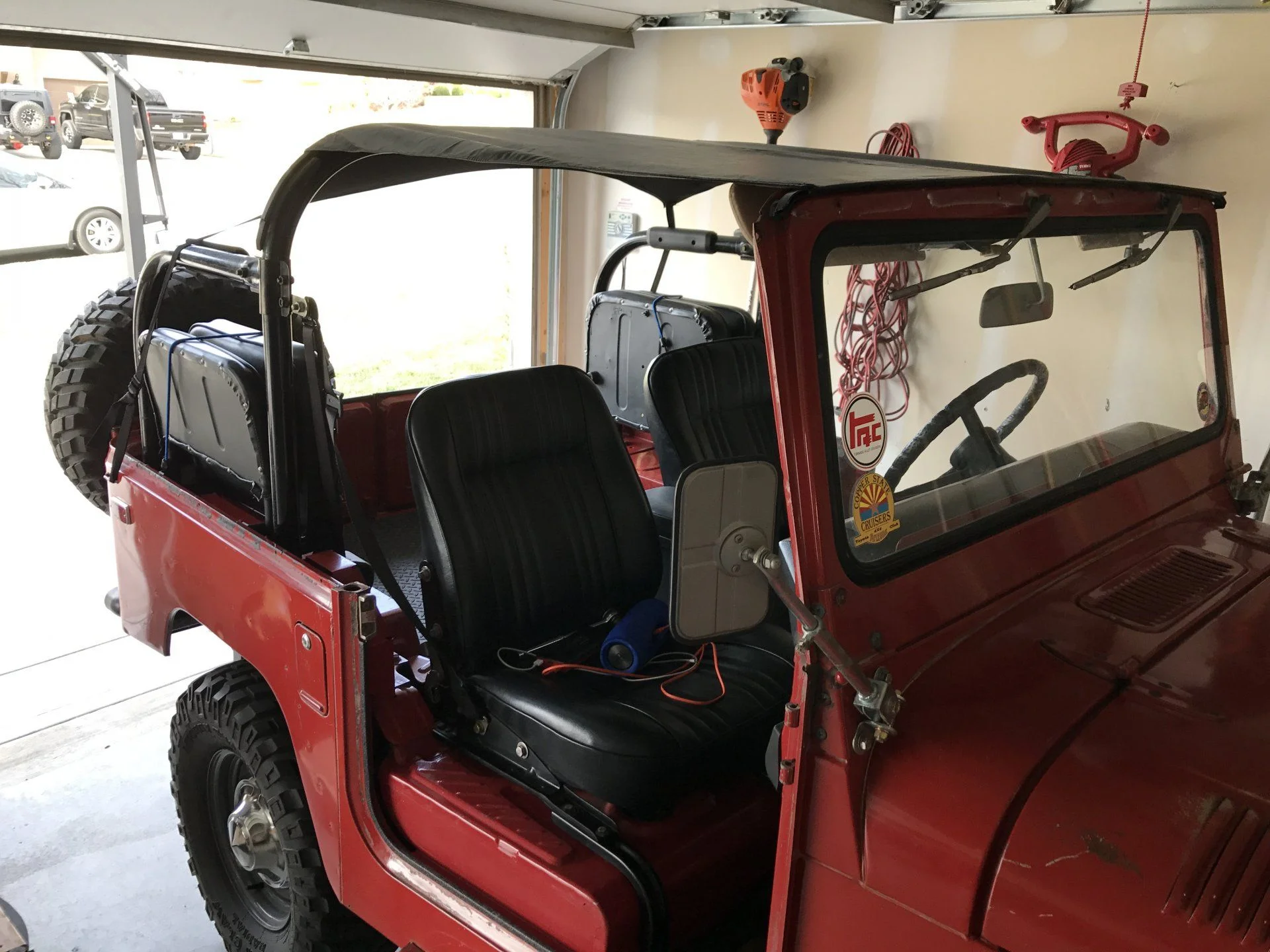

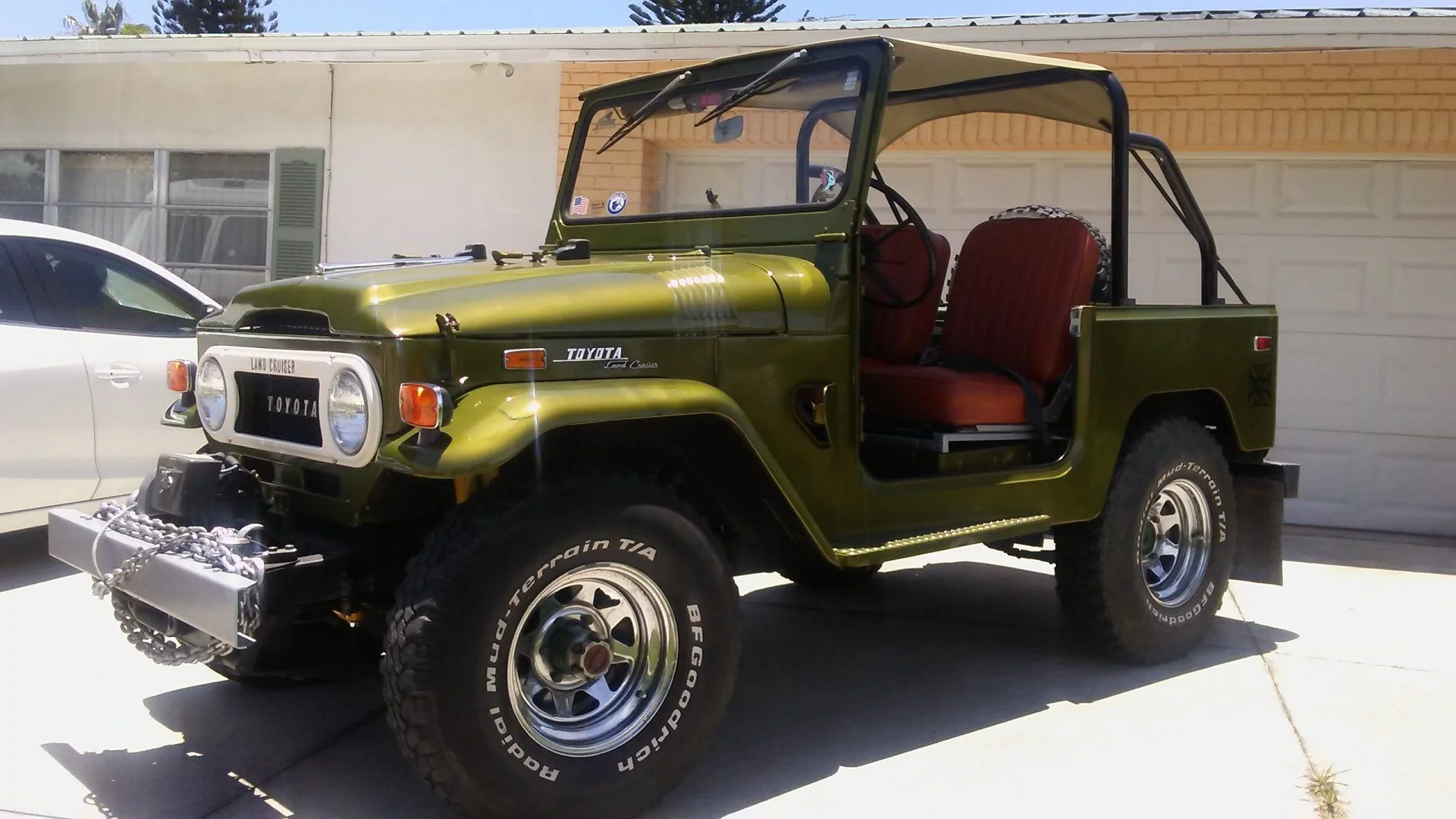

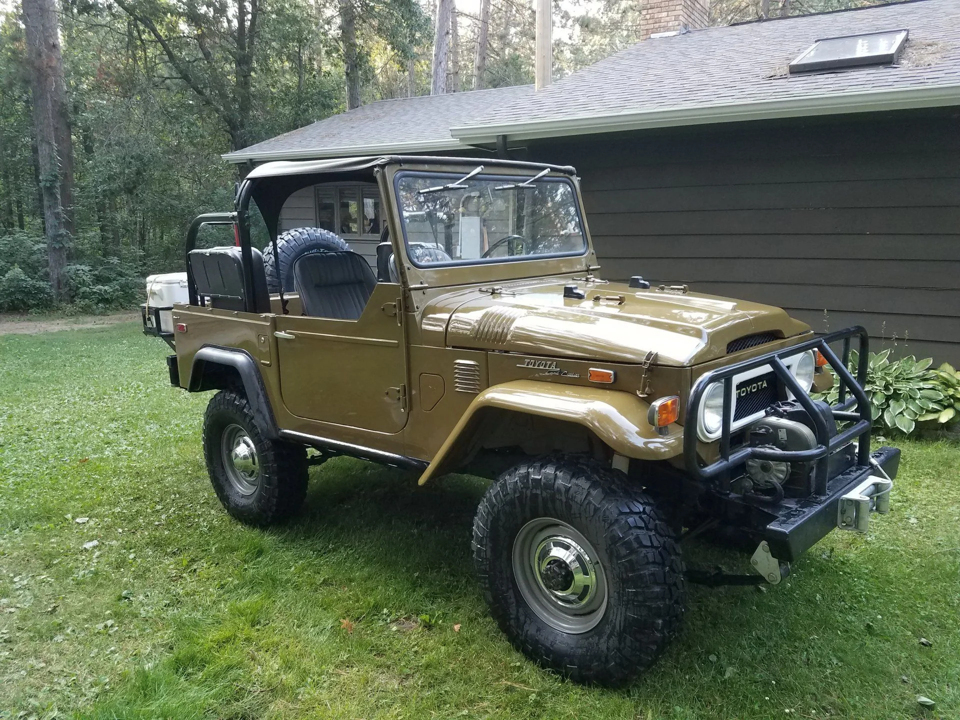

My '74 has 3 factory threaded holes on the top. I did have to drill the piece that attaches to the windshield frame so it would line up. No issues on the highway either. I have 3 (PO provided) and the best top is my least favorite (first pic). The Spector Off-road (second pic) would be my choice.

This SOR Bikini top with sunroof I bought in about '06 still totally solid, used until last year here in Florida, Safari top with the net sunroof.Before my rehab. The other new, sans sunroof, same material after my rehab.

Best top for me also. Meh whats 4 extra holes. I put a shot of silicone in each before screwing in
I always run a bikini top when my hard top is off. One from Spector Off Road came with my 40 and is still serviceable after 9+ years, though it's starting to wear where it rubs on the roll cage.
I got tired of the wind pulling on it and vibrating the windshield and rear-view mirror, so I screwed the front channel onto the front spreader bar of my MetalTech roll cage instead. Now I can see what's in the mirror, and as an added plus I can drop the windshield on a trail and still leave the bikini top on.
