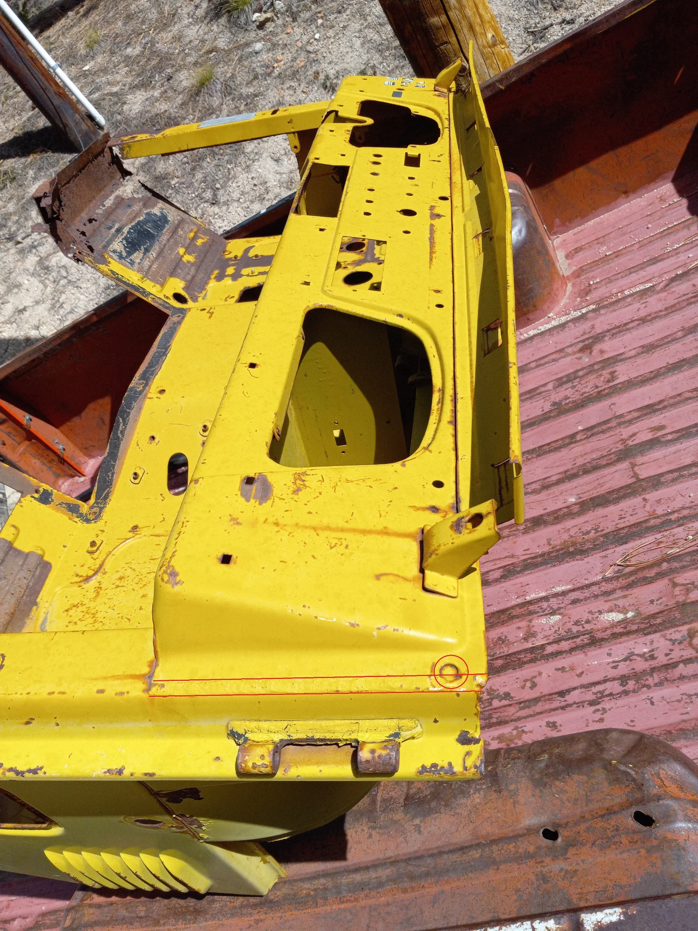

Reviving this thread: This is a '78 donor dash for my '76-ish project.
I understand cutting along the edge (marked in red at the bottom of the first pix) and the spot weld, along with the glove box welds (I will re-use my glove box), but my question is whether there the seam in the 2nd pix is just crimped, or is it also welded (see long red lines). I don't see any evidence of spot welds. Do you just lift and 'unhook' the dash face from this edge? (seems too easy...)

I was thinking there were spot welds along the windshield frame area, but it has been a long time.
IIRC the welds were on the cab along the top edge, as other markets didn't get the dash pad mount, not on the outside edge
I would cut both sides and the glovebox and see if it gets loose and can slide up

I saw these welds (see below), but they seem only to hold the dash pad bracket to the dash face, not the dash face itself to the cowl. I don't think there is cowl metal behind them.
@3_puppies advice of I would cut both sides and the glovebox and see if it gets loose and can slide up - seems like the best plan. It's gotta come off somehow, and much of the ugly of this can be hidden and/or repaired later.

1st I gotta say, I'm no body work guy. I think 1st I would remove the dash pad bracket. There's just a handfull of spot weld holding it on. It's attached to the dash panel. Maybe you could cut the dash behind where the bracket was, then have the replacement dash weld seam behind that bracket. Weld and grind smooth and reattach the dash pad bracket. I recently repaired/rebuilt my windshield frame and ran across the same type of folded seam at the bottom of the frame. I tried to unfold it on a junk frame for testing and realized it was going to be a PITA to unfold and refold and I would not be able to do it and have it still look good. I decided to cut the sheet metal at a spot where I could easily weld a replacement panel in and grind the welded seam. I laid down tape for a straight cut line.
@Engineer8000 - sounds like I'd need to remove the dash pad brackets (flimsy sheet metal) by drilling out the spot welds. This would allow access to the next set of welds. Then, I would locate and drill out the welds all along that top edge (as shown in your photo). At that point (with all the other welds cut), you can slide the dash off the top flange. Sound right?
@pb4ugo - your approach is to remove the dash pad bracket, and then just cut and 'seam' (weld) the new dash to the old dash, where it won't be seen behind the re-attached dash pad bracket. Admittedly, a lot simpler.
I would take @Engineer8000 lead on this one. How tight is the folded edge of dash to the cowl sheet metal edge. Will the dash's lip slip off the sheet metal it hangs on if you just cut the spot welds?
