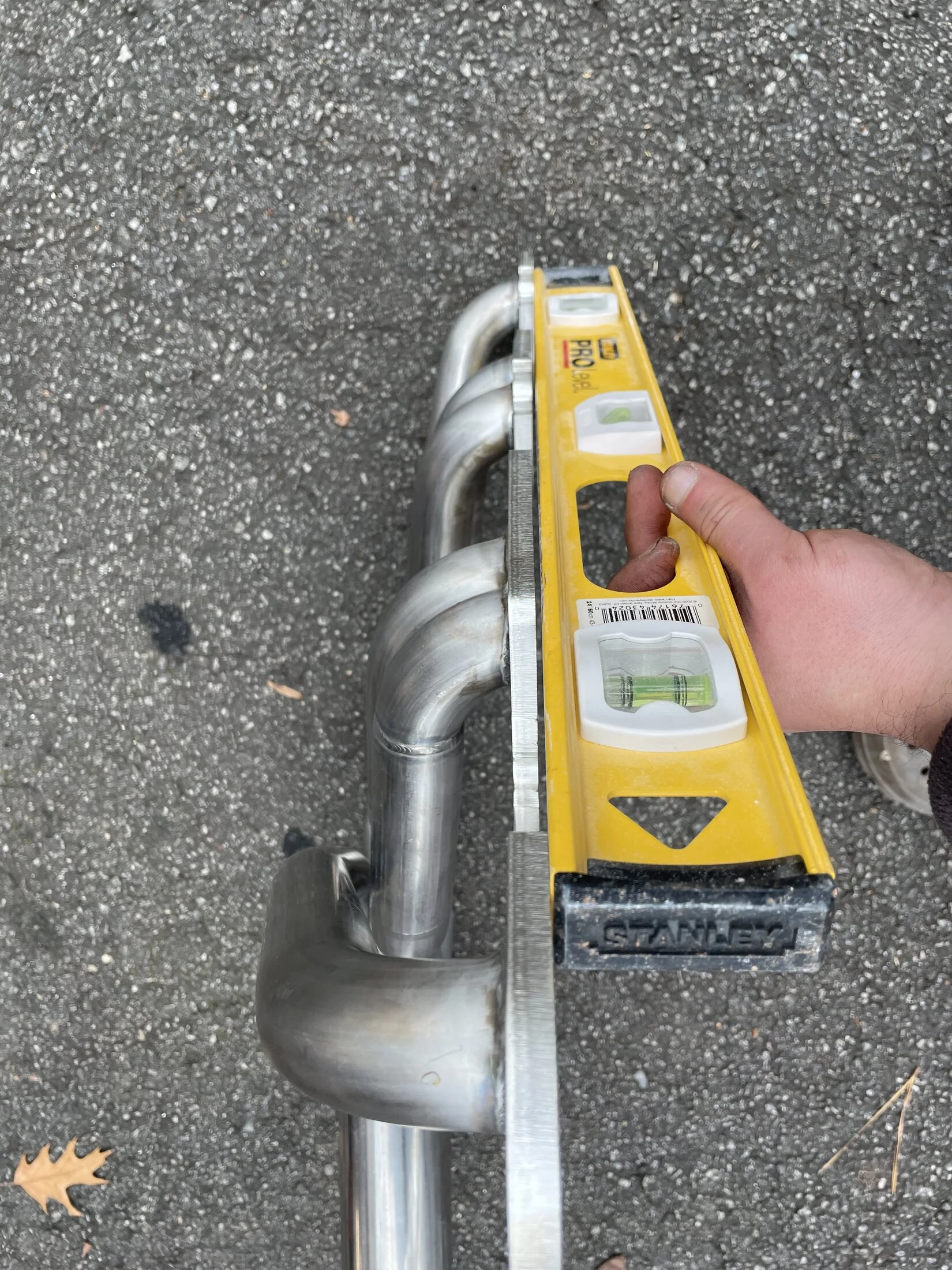

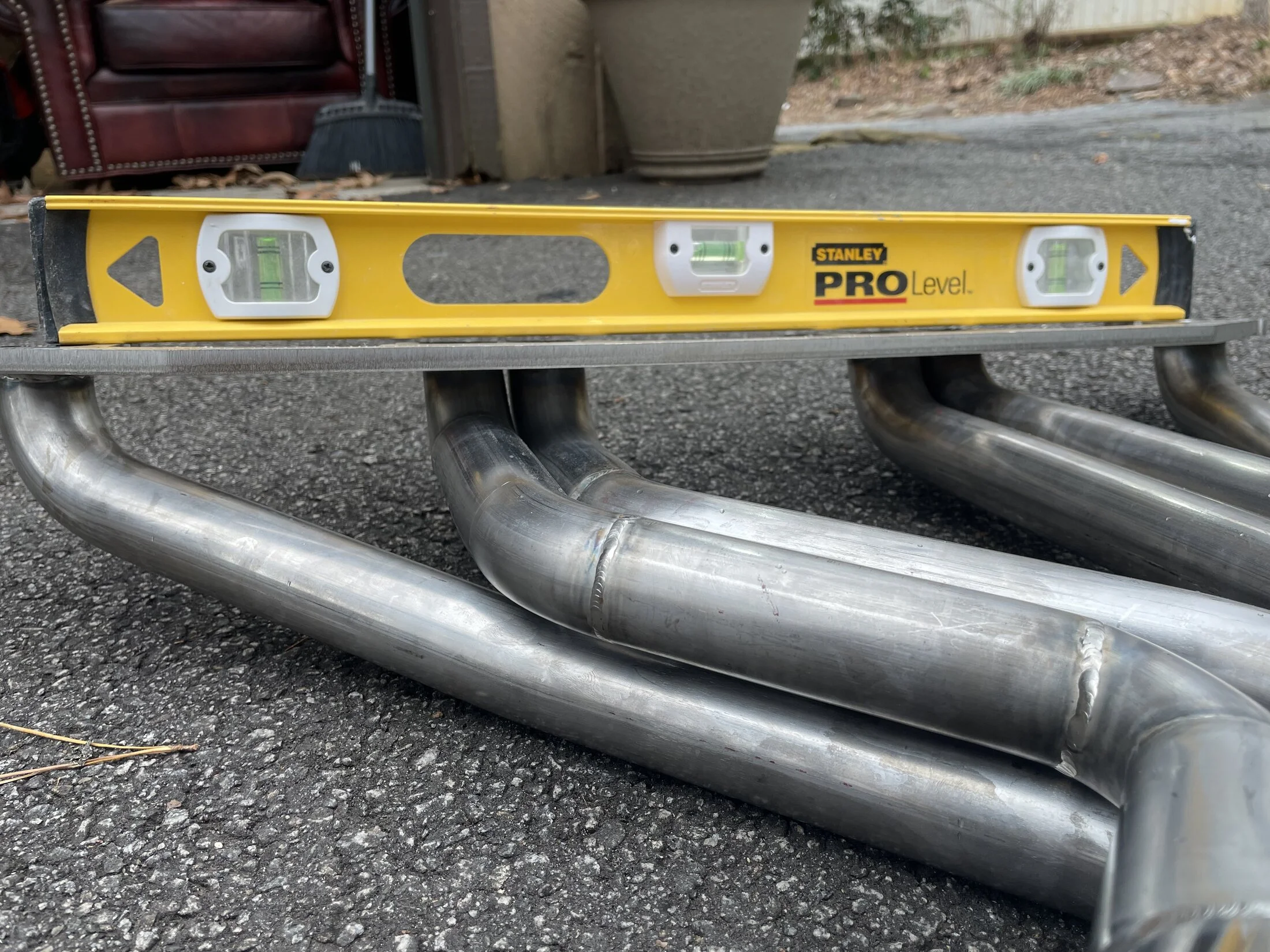

I am at the installation portion of my header replacement , just pulled mine out of the box. These have a very visible bow across the flange. This doesn’t seem right to me. The four inner tubes are not inline with the outer two.
Thoughts?
Who made that? Looks like warping from the welding to me. What is that gap 1/8"+. Have you ask the manufacturer. It may be fine after a few heat cycles with retorque every time. Snug it up hot, then again when its cold. Can't see the difference in outer and inner tubes.

It is not untypical to see warping that results from welding. It is welded-construction, not cast, so it barely matters, as it will likely yield to flat upon torquing the nuts on the studs. Local warping could be more problematic, like if the curve is welded in place by the header pipes - use a shorter straight-edge to see it. What is more important is equal thicknesses of flanges, header and intake manifold. Measure both with a micrometer or calipers. An exhaust leak at the head is dangerous, so depending on how it is warped, you might change your approach to gasket material, and gasket-maker vs no glue. One header flange that I had was thicker than the intake, so sealant on the intake manifold is going to be essential, Remflex gasket, using a custom stepped-washer, etc., it kinda depends on the geometry that you are trying to correct.
Without any further research, I'd trust the header and assemble. I like anti-seize and a torque wrench, thread file or equivalent for prepping the head studs.
Confirmed with mfg today that these are in spec. Very nice outfit. Installation will resume tomorrow.

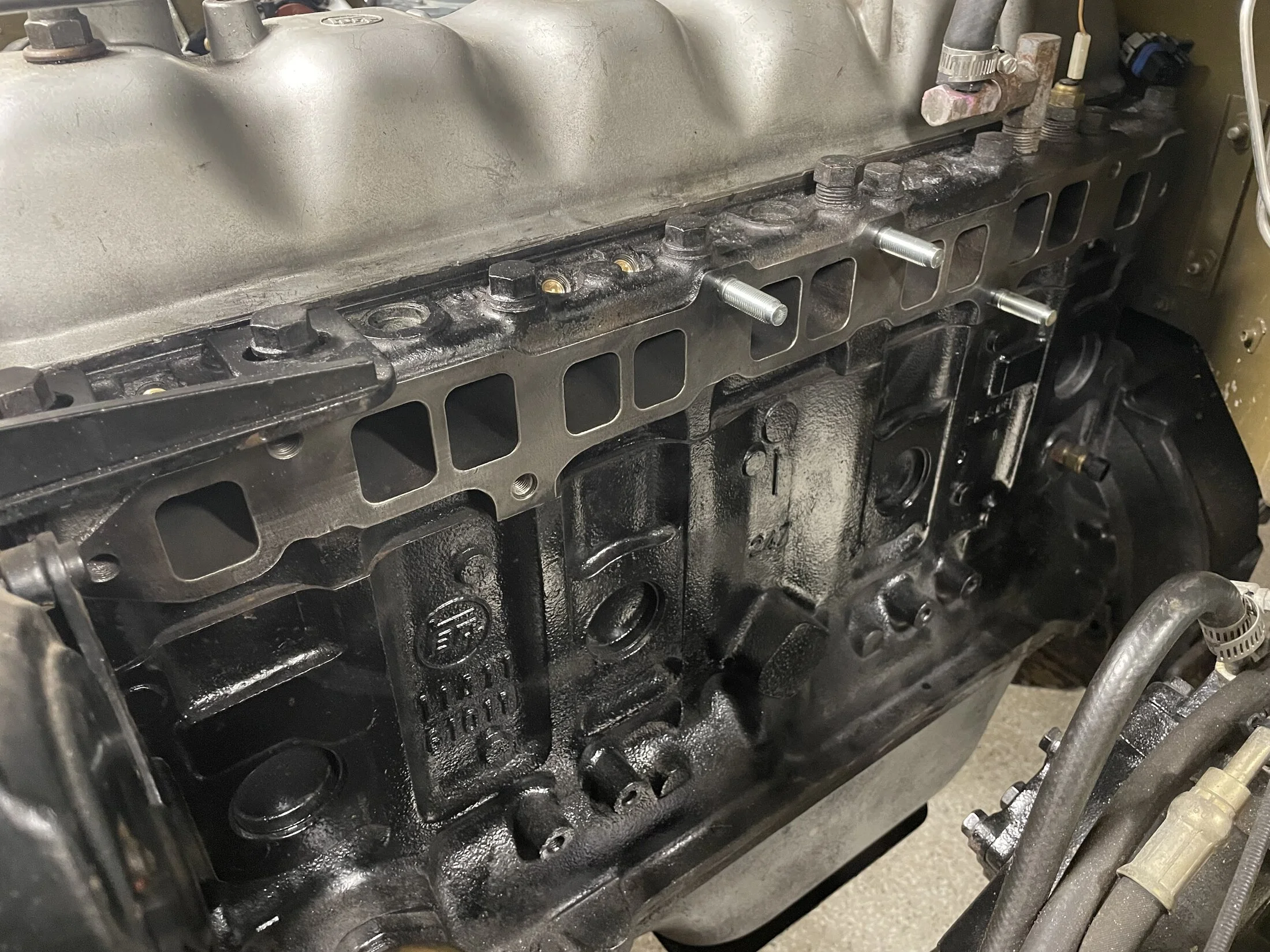

As advertised, these do include a remflex gasket and the flange thickness matches the intake manifold. No need for half moon washers.
Yes I know I am missing a stud - waiting on tap to clean up threads.
Awesome. I did my header in 3, like 10, then 20, then 28? or what ever the spec's said. Then I heated them up good and retorqued them in pattern at 100% after the cooled I checked them again or was that backwards to the plan, after a few cycles I checked them again - they didn't move. Oh and I used high temp anti seize and stainless steel nuts. I used 2 man-a-fre header gaskets applied wet with my custom made step washers and extended studs. That set up has been on 2 different engines at least 3 times total and has never leaked. I did plane the header on a big piece of glass with sand paper once.
When Downey Off Road Mfg. built Headers 1,000 years ago the Header flanges were always warped when pulled out of the welding fixture. The good news is the flanges straightened out while still tightening the nuts with finger pressure, soooooo wrench pressure certainly finished the straightening job in a flash.

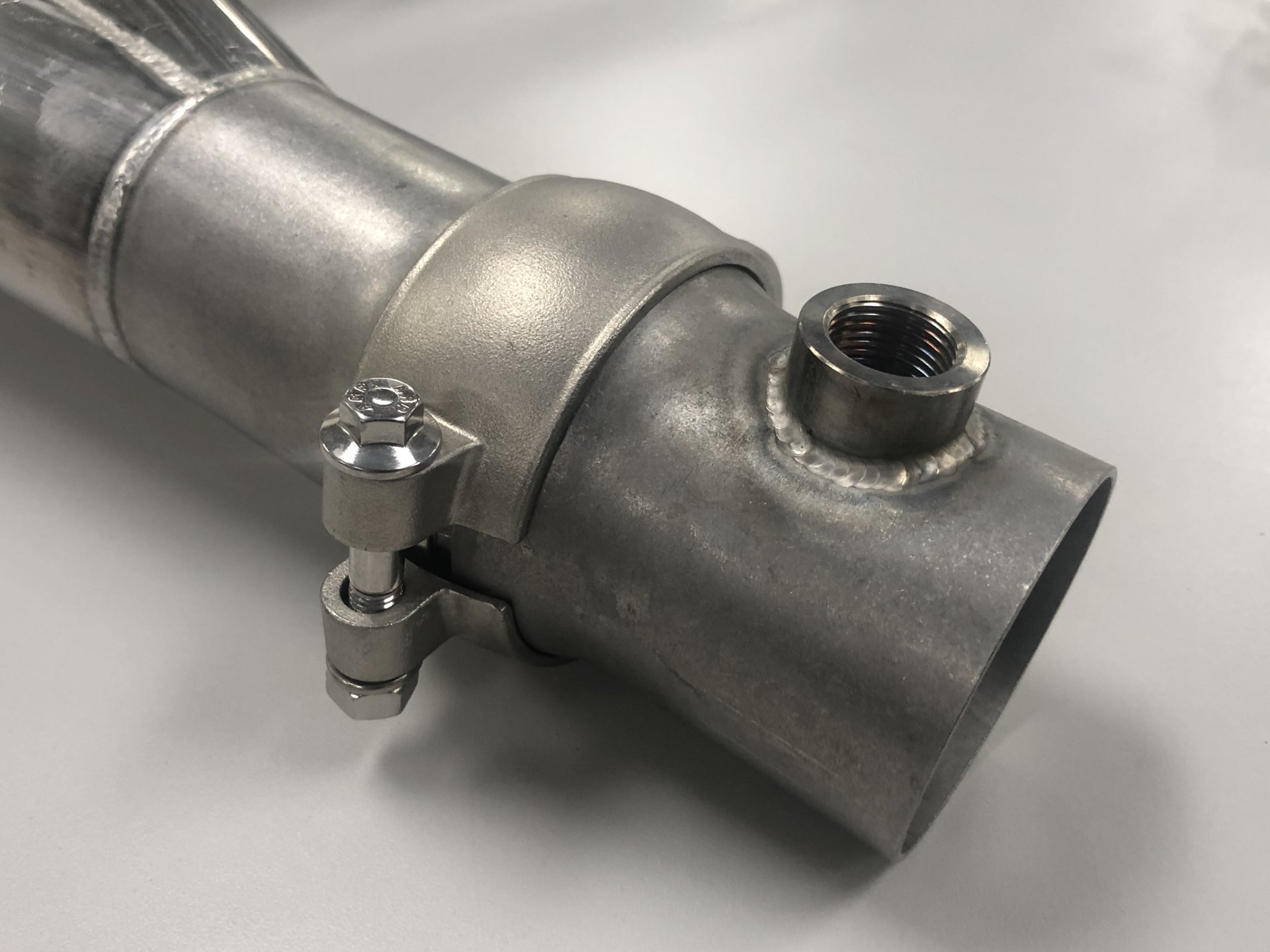

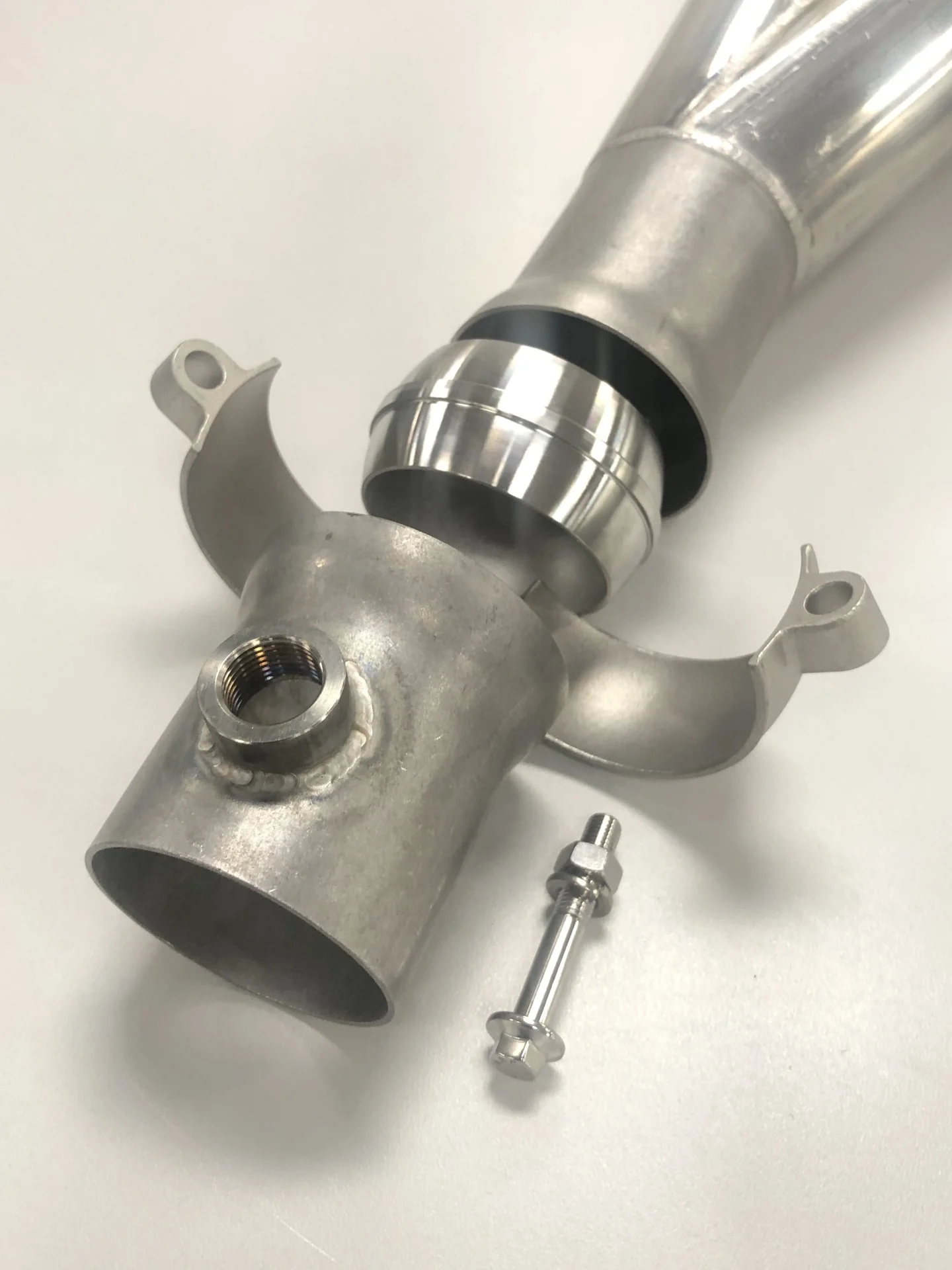

Is there a recommended torque on the slip joint bolt? I didn't want to overdo it, but I'm getting a pretty solid exhaust leak there despite the ball settling cleanly.
(I'm more familiar with a traditional v-band setup, and not quite sure how that setup is supposed to "seal".)
Edit: removed, rotated the clamp a bit and retorqued...same deal, leaks through the clamp joint, definitely not sealing for some reason. I can't really see how that band draws things together with the rounded shape - a v-band "wedges" the two halves together in comparison, whereas this style does not. Seems like it'll need hi-temp RTV or something like that, but not ideal and seems...odd. Curious if I'm just missing something.
Are you asking about the collector flange clamp (the articulated joint) or the slip joint between the midpipe and tailpipe?
V-bands are useful where you have mating flanges, which, by definition, allow only very low to no articulation. If the flange faces don't meet when using a V-band, you won't get a seal.
25 ft-lbs should be all you need, assuming you're asking about the collector flange.
