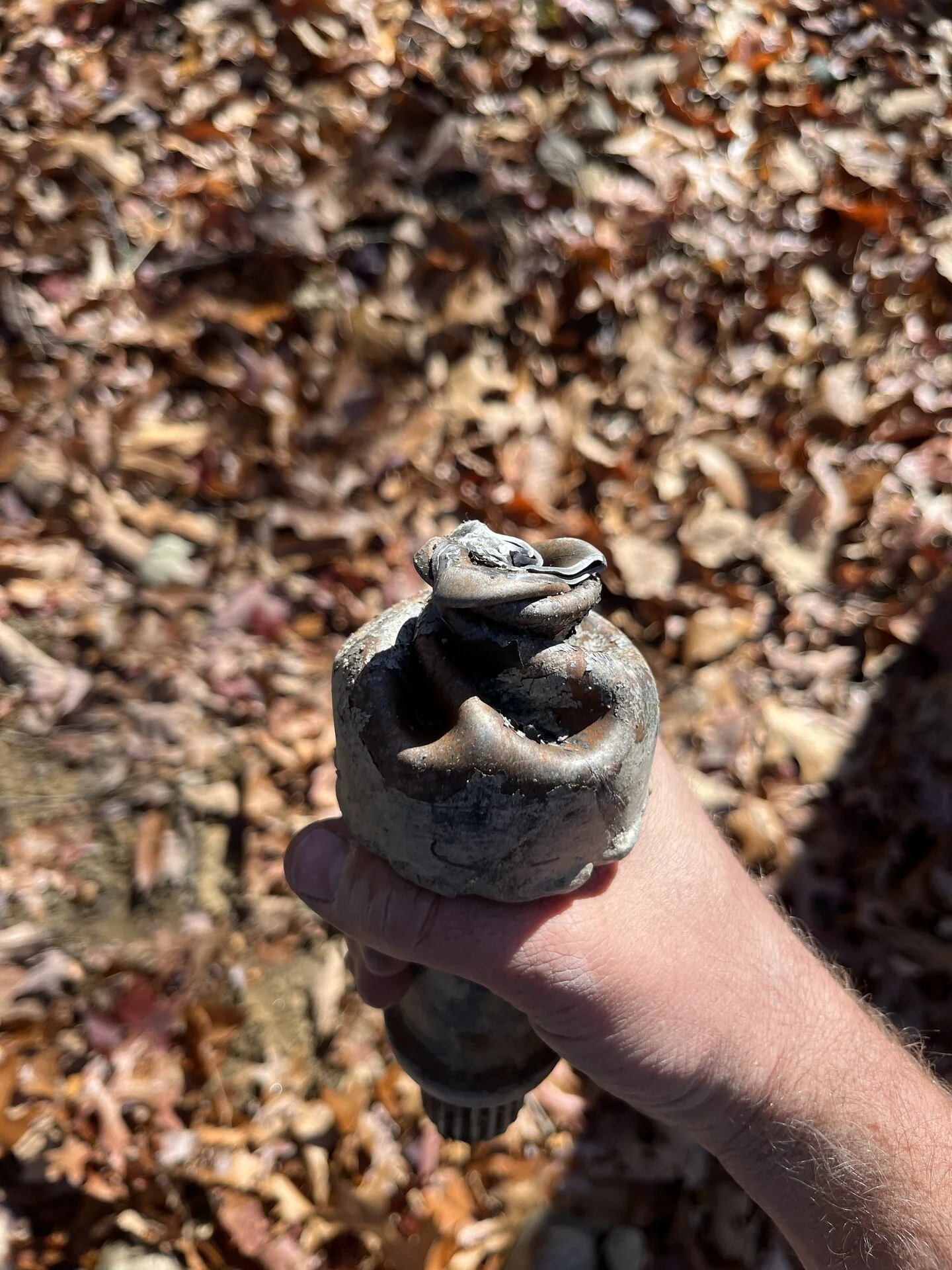

Does anyone happen to know the Inside Diameter of the tube for an FJ40 driveshaft?
Unsure if it makes any difference but it is for the later style(74+?) with the larger U joints with internal snap rings.

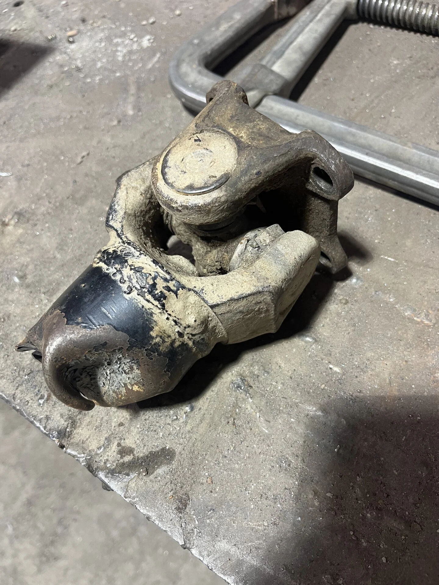

I am trying to build a driveshaft to make a trip in a couple weeks and use it as a trail spare after that, and I haven't had a chance to cut the twisted tube off the yoke and measure. And was hoping to get a leg up on sourcing some heavy wall tube with the correct, or slightly smaller ID.
Use bigger tube, OD of the stock shaft is the same as the ID of a common driveshaft size in america
It was an article about making custom lenght driveshaft in the toyota trail magazine (TLCA) early 2000
This way you can cut the damage part of the tube and slip the new one over and weld
@jim land @CruisinGA so yall are saying to leave the tune that's on there now cut short and then weld a larger ID tube over it?
I was planning to cut all the old tube off on the lathe to get a nice clean yoke and then find a piece of .25" wall tube that would fit the centering nub on the yoke. Or a piece that was slightly smaller ID and turn the inside so it would fit on the yoke.

I got a piece of 2.5" sch40 steel pipe we are gonna try and use. It's just for this one trip then a trail spare so should be good.
