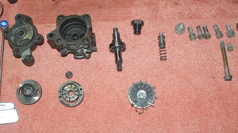

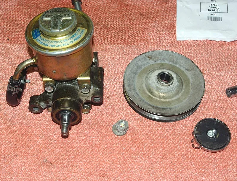

The 3FE pump mounts on the passenger side of the head, the mount holes have been in all of the motors that I have checked. They are vane type, the shaft/pulley is supported by a replaceable ball bearing, have less o-rings/places to leak, are easier to repair and in my experience, are more reliable.

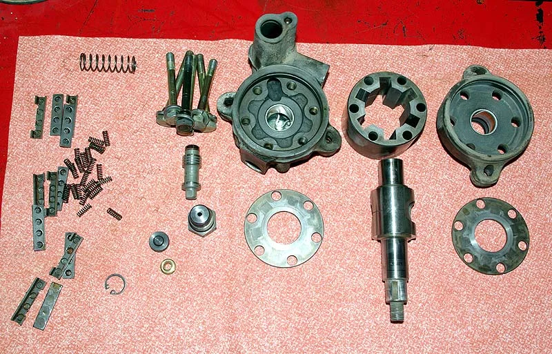

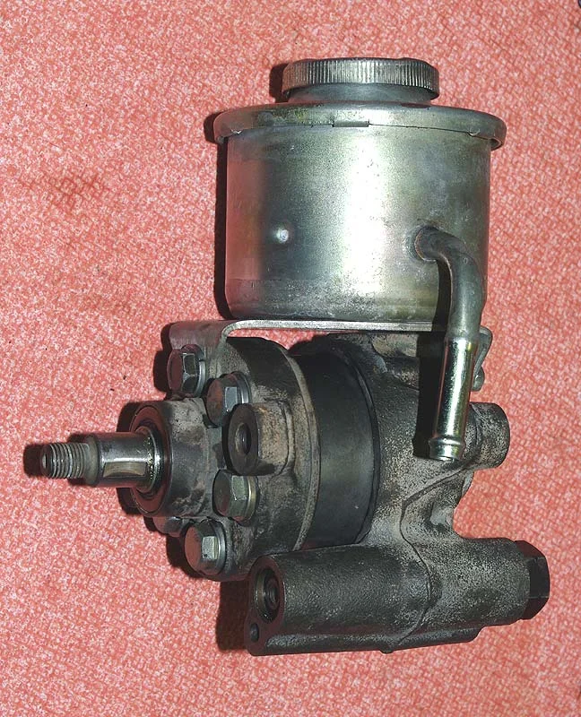

The earlier pump, mounts on the driver side. Are slipper type, more complex/fiddly to repair, the shaft/pulley is only supported by a bushing and haven't found a replacement if worn.
Have used/built both, but prefer the vane type. My observation; when equipped with the vane type pump, steering is more responsive, stronger and takes more beating to overheat the fluid, likely has less internal friction, more efficient?
Pix, first the vane type:

Then the slipper:
