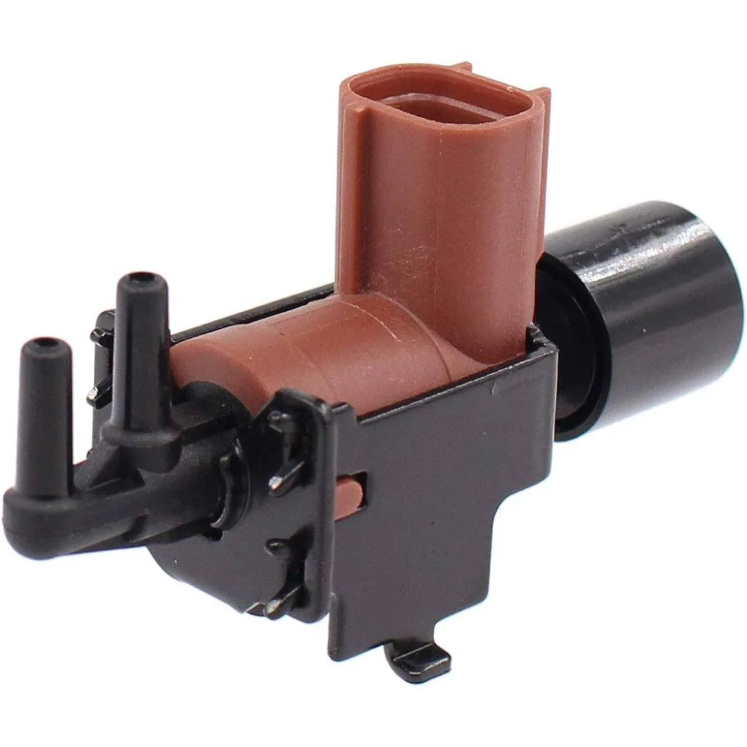

VSV shutdown on a 13bt just turns off airflow. It’s a butterfly that closes off.

Ah- must be a larger actuator than the VSVs I am more familiar with that are like this.

same thing. The VSV just control a vacuum dashpot that closes the butterfly and airflow to the engine.
