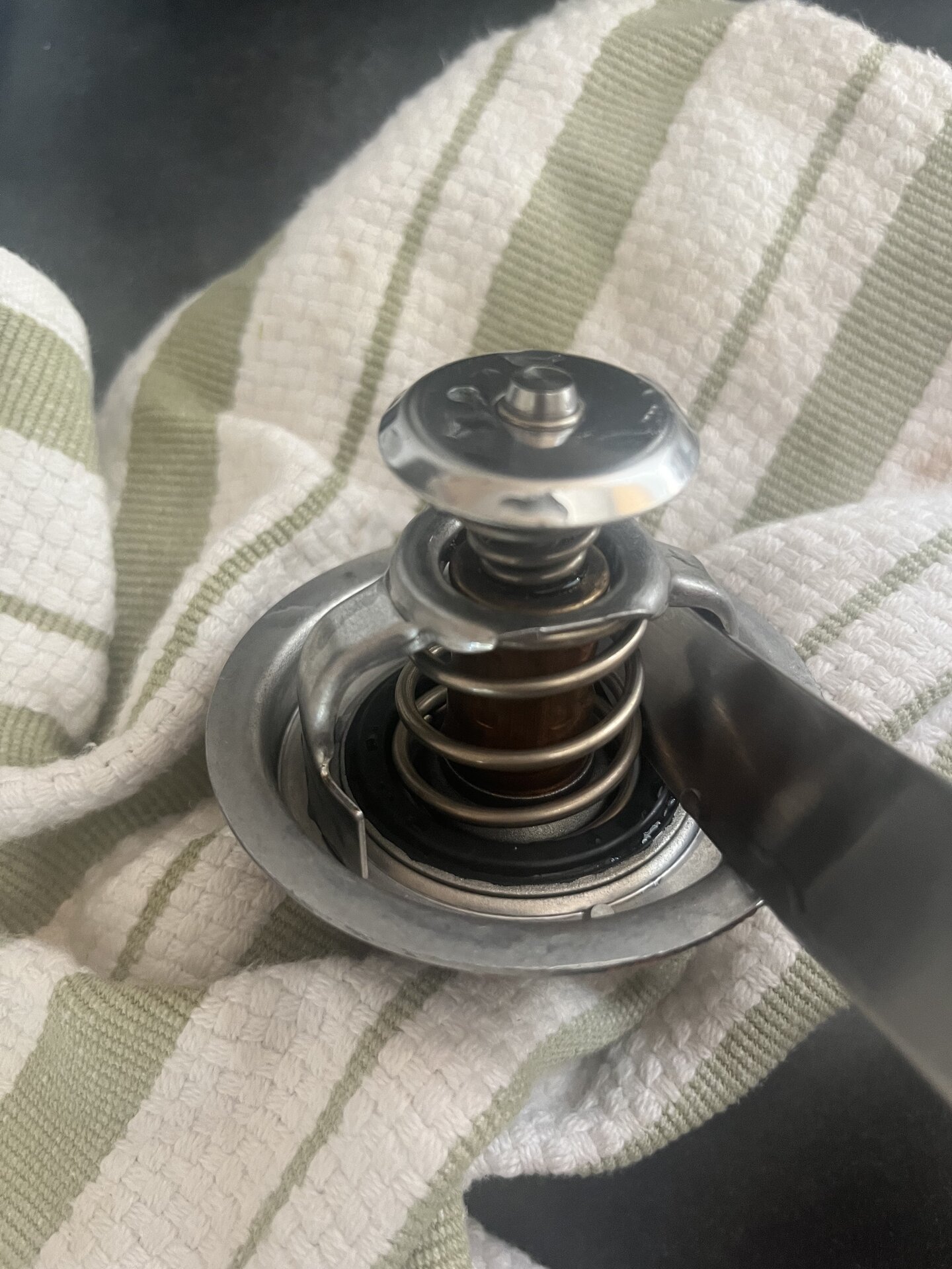

210 isn't terrible. Sounds like it just has air in it. Go drive it
Thermostat is brand new, and only fits in one direction. I may just need to burp the coolant system more effectively.Bad/Incorrect/Upside down Thermostat?
Fingers crossed its as simple as that!Thermostat is brand new, and only fits in one direction. I may just need to burp the coolant system more effectively.
Yeah. I’m underwhelmed haha.wow. that is definitely a rare one
I always thought I just had that kind of luck. I had a teq one fail to open when @mattressking and I fired up my rebuilt 2F. Scary. But easy fix and no harm done.wow. that is definitely a rare one
