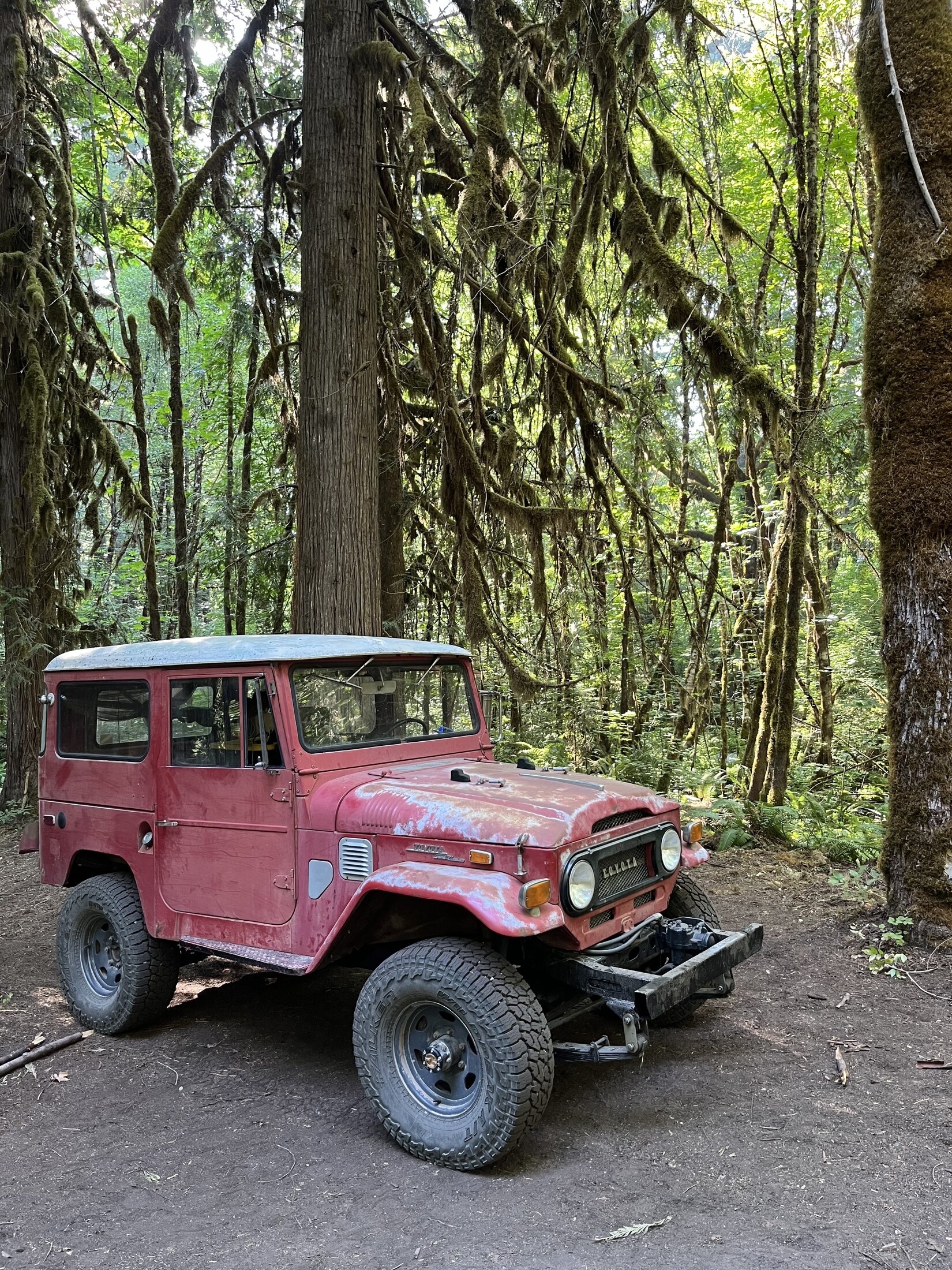

Here are a few more pics from her maiden voyage to Oregon.... (chasing down a power steering leak)

Here are some before/after shots of the CLR scrub, wash, and fluid film to keep the paint protected. It turned out VERY nicely.
Took the 40 on the annual Mudrak Christmas Trip. It gave me some motivation to get the last of the kinks worked out.
Parking brake works now. I installed a new (functional) thermostat, and coolant temps hold steady at 190 without the T-stat even opening. Second fuel tank has been re-installed and functions (its nice having red diesel on tap when off-road), I also raised the steering angle so I can comfortable sit at the wheel. I also built a roof rack and threw my RTT on so I dont have to sleep "Coffin Style" in the cab.
