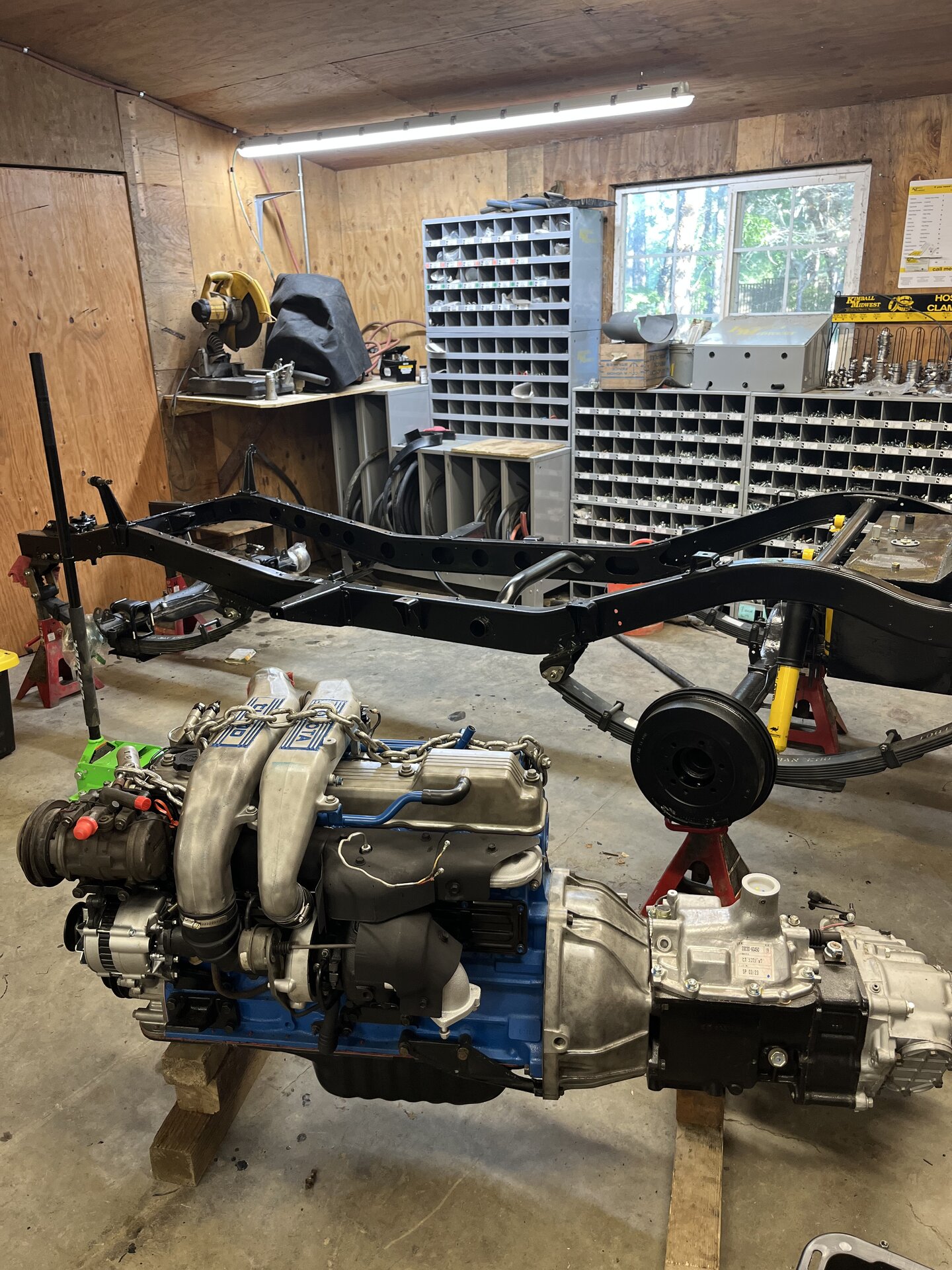

5. Mount Engine, trans, and tcase.

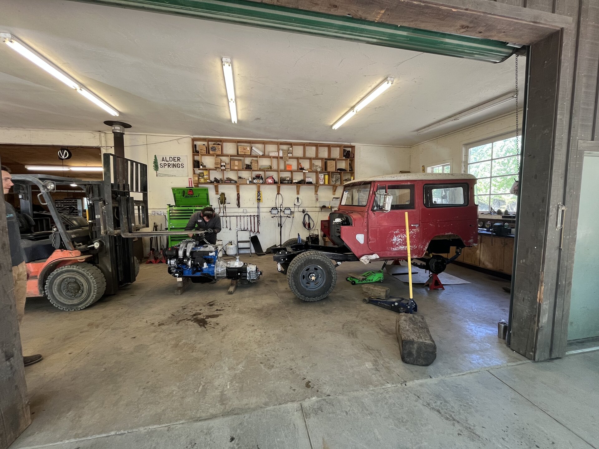

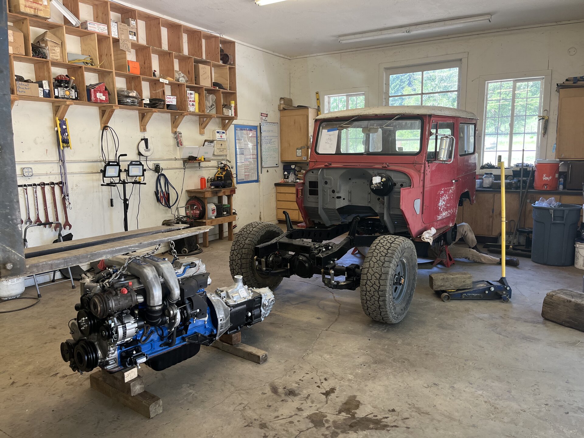

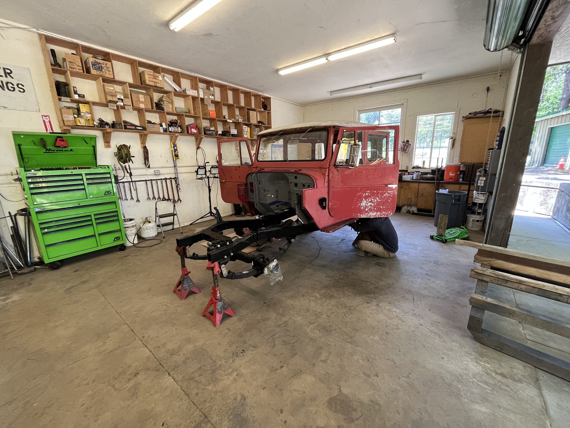

10 day progress update:
-Axles built
-Axles mounted
-Wheels and tires on: chassis rolling
-Engine and trans mounted
-Driveshafts measured and are being made
-Custom radiator ordered
-Body sprayed with sound and thermal insulation
-Tub/firewall sprayed with monstaliner
-Body on frame
-Hard fuel lines made
-Clutch lines done
-Trans/tcase linkages done
-ARB lockers installed

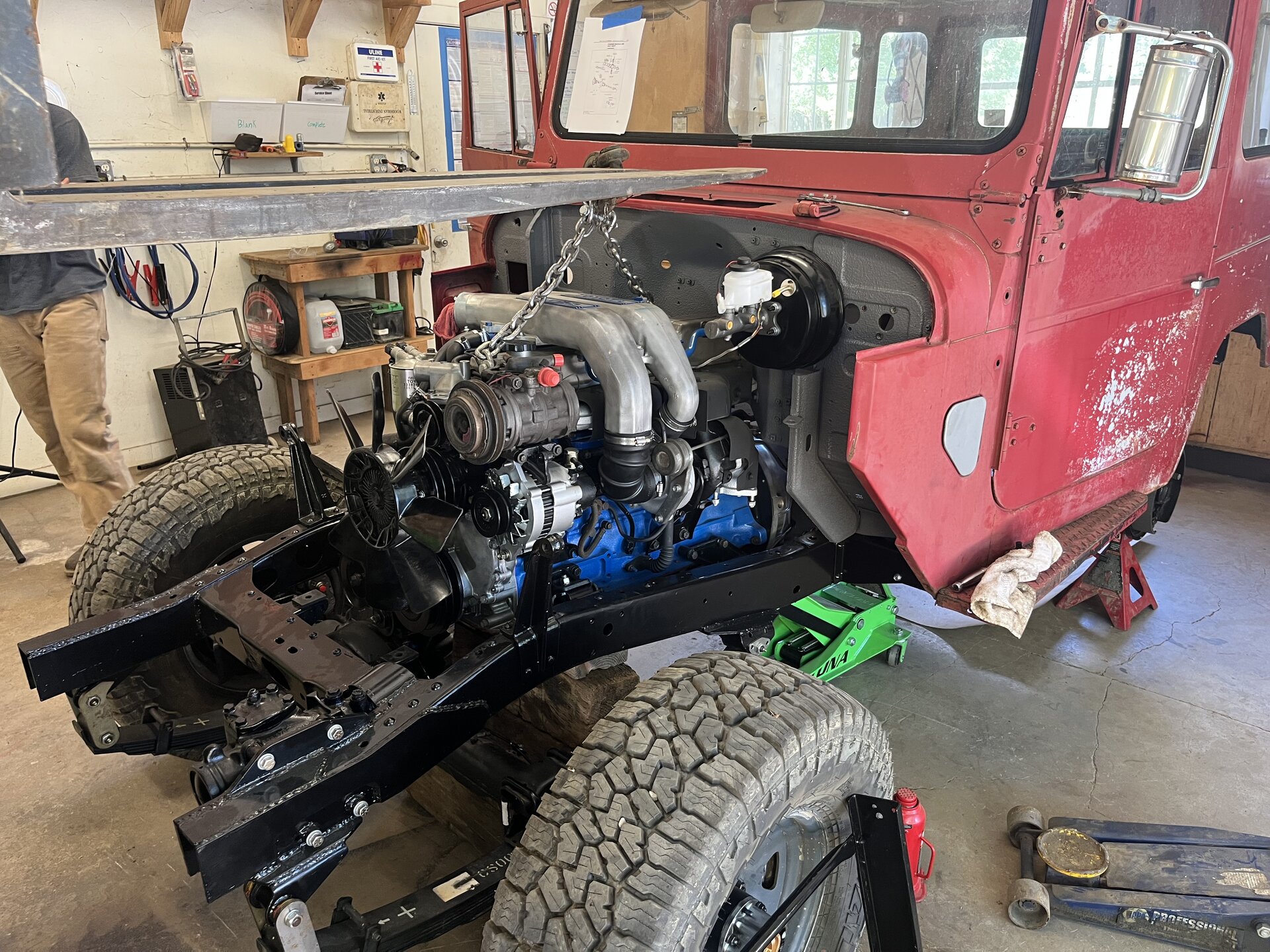

More pics
Which mounts did you end up using? Looks like you drilled the frame for the 80-84 crossmember?
I built my own engine mounts but used the 80-84 trans crossmember.
Progress Progress
-Fuel lines are done
-Steering column complete
-Brake, Clutch, and Gas pedal complete

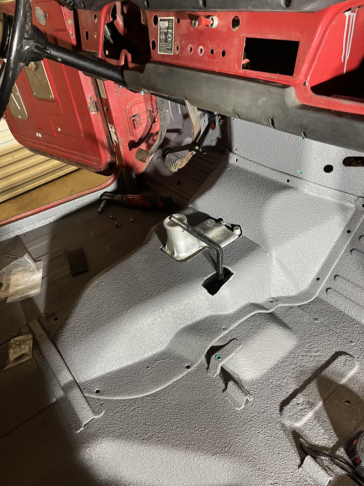

-Trans tunnel cut and ready for boots.
Mo’ Progress
Brake lines done
Fuel system totally done
Fuel tank tested (no leaks)

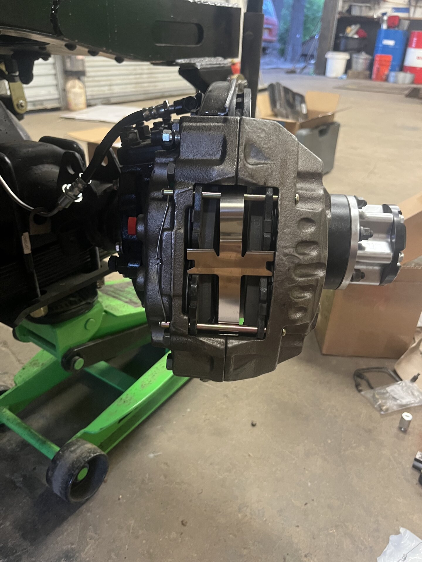

Brake pads and HUGE calipers installed
Front shocks mounted
