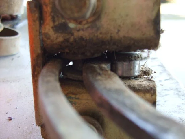

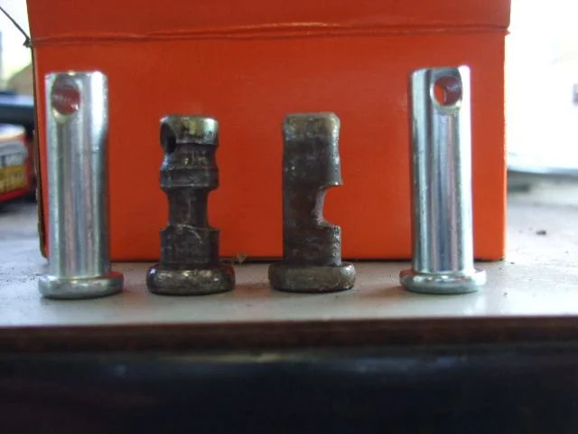

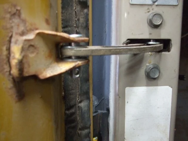

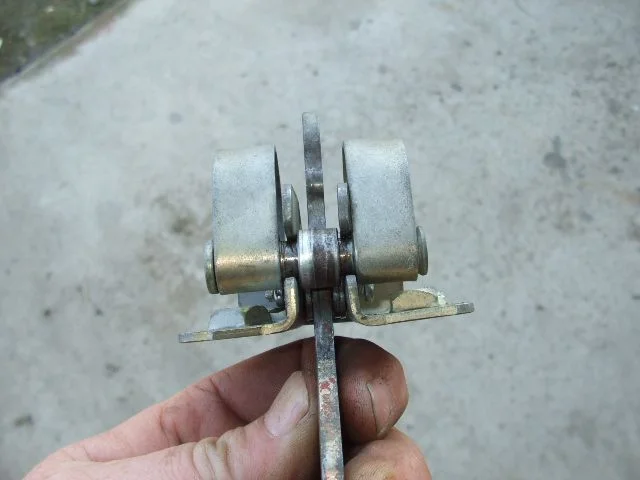

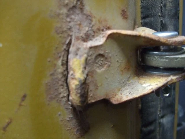

Door Hinge Limit Assy Pins replaced.
I think the wearing of the pin causes the doors to crack.
I checked my other rigs and they were worn as well so I replaced them on 3 of my rigs.
5/16" x 3/4" is the corect size. The news ones in the pics are 1" and I used them for the door side tabs.
