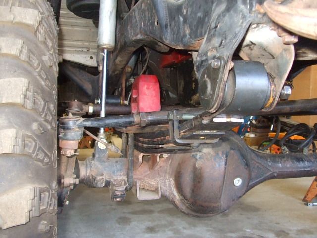

I called Kurt at Cruiser Outfitters and talked Spring rates.
I took the CS 003 spring off the Beagle Chariot..........
Go add a leaf to your spring pack :)
..............and cut apart the flattened out springs. I cut the second from the main down and added it it as a 3rd from the top spring. I also slid in an extra 3rd from the bottom spring.

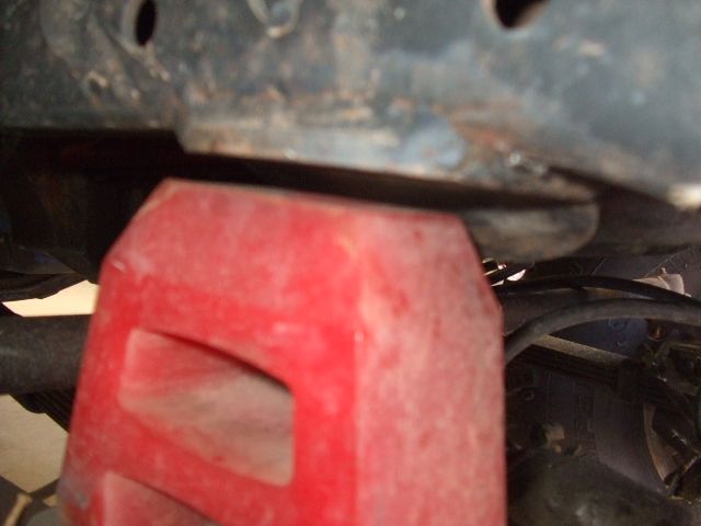

Bump stop looks real good.
So you are running OME lift springs now? Your lift looks about right as does the travel to the stop. Any pics of the truck as it sits from the side?

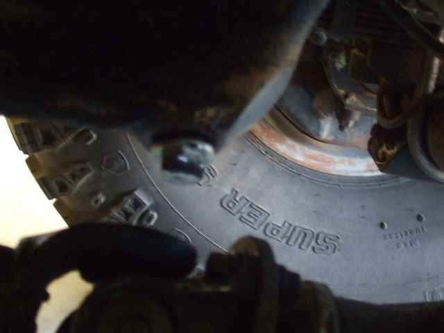

Steering rods still have enough clearance, even when turned?
