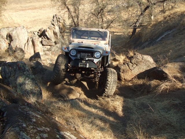

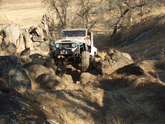

Had a few good friends come out with thier Built rigs and we made some new hard(er)core routes. Wheeling in the dark last night and right after breakfast this morning.
I lost 1/2" of height on the front bumper after wheeling and saw some steering rubbage. Time for a Cut N Turn.

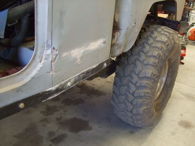

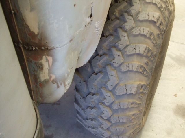

Get some rocker protection for your doorways, or it'll never seal up well ;)
Awesome :)
Ouch, but someone here will tell you that will just buff right out..;)
X2, Awsome..(Looks dry and dusty there)...
Dan,
i remember that place, holly crap looks freaking awesome the 45 i mean.
