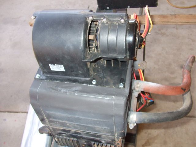

Cut hole for new blower motor discharge.

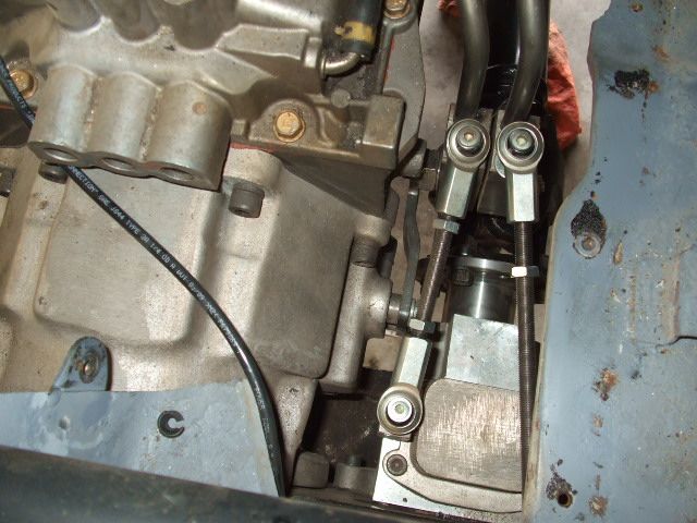

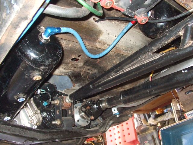

I started back tracking the twin stick linkage that I installed.
First
This is the twin stick mounting bracket for an NV4500. If you are the NV4500, this is what you see. The hole for the mounting stud goes on top. Technically you cannot put it on upside down since it will hit your driveshaft. I used the mounting holes along with the spacers in the hole all the way to the right in this picture.

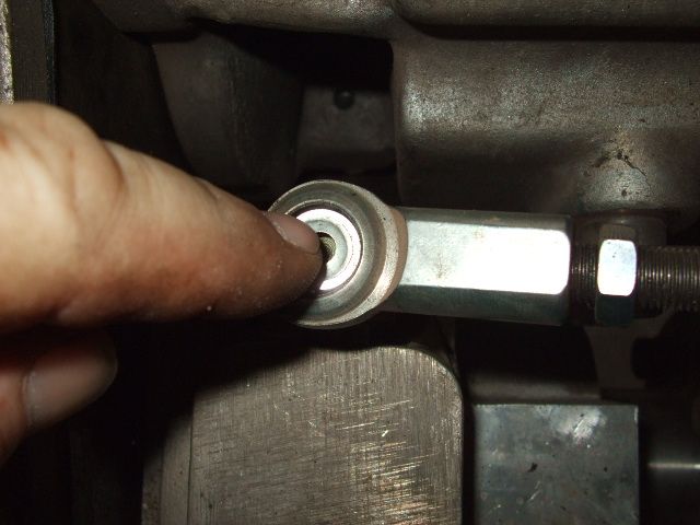

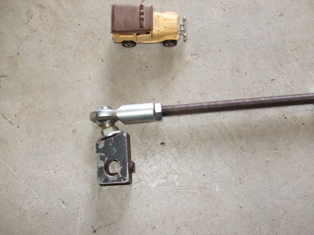

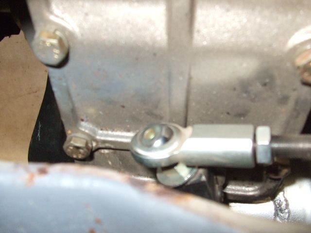

The major binding was actually in the ball that mounts to the HI/LOW shifter stud coming out of the T-Case.
It would not allow the all thread linckage connect too the shifter. Look at the closely at the HI/LOW shifter. The linkage is over 1" away. I am pushing the threaded rod over towards the shifters in these pics and the rear pivot connector is bottom out.
This is no Good!
When assembled, you can force the T-case in gear by standing on the shift lever but it will pop out. All you are doing is bending the threaded rod when you stand on it.

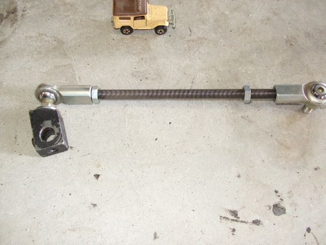

In relation to the position of the vehicle in the picture:
Top picture is the wrong way to install the pivot on the HI/LOW shaft.
The bottom picture is the correct way.
Instead of the angle on the shifter block going from the (USA) passenger side fender and back to the rear of the driver seat, it should go from the transmission back towards the (USA) passenger side rear wheel.
