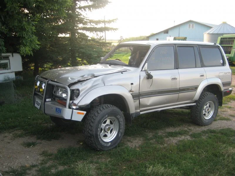

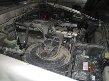

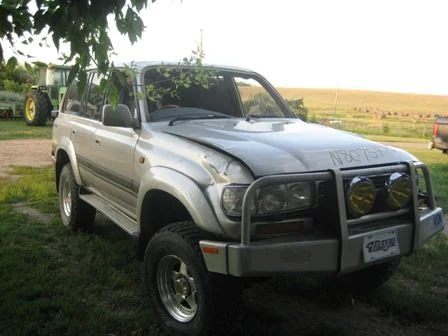

OK latest news is i picked up a complete 80 series and am taking the 1HD-T engine out and putting it in this truck. I'll get some pics up soon. Also if anyone is interested in a 2F engine let me know.
Here are the pics of the donor.

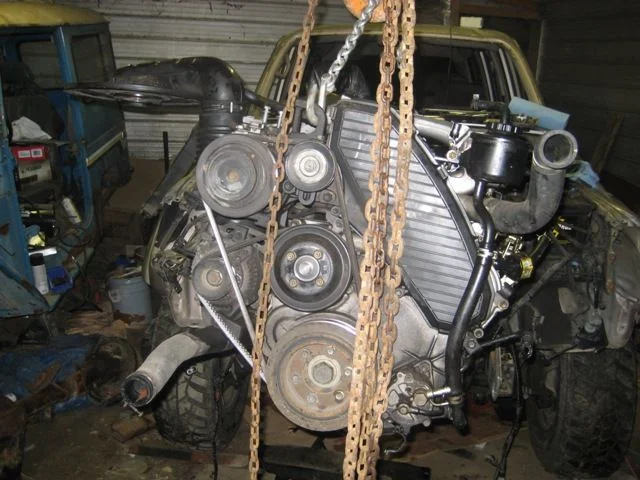

here are some more
Thats not the point. It would be awsome to have an old 45 with a turbo charged diesel. I'm not a big fan of the 80. To soccer momish for me.

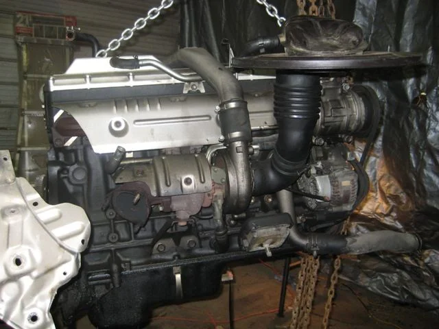

Yeah i got my work cut out for me though. I have to go through the engine it makes a funny noise i think one of the bottom end bearings might have kicked the bucket so hopefully it hasn't caused to much damage. I'll have to find out when i pull the engine out and get it on the stand.

Well the engine and tranny are out now. Got to check the engine over before it gets mounted in the frame. Here are a few pics.

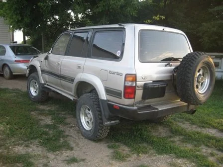

Is the rear axle a FF? I might be interested in that.
I'll have to check the rims on it have center caps so i can't tell i know it has disc brakes and a limited slip.
I'll check for sure. Does the rear axle have the same center section as the old land cruiser axles? The 45 has a full float rear and discs on the front but i have been thinking about swapping the rear axle into the rear of my BJ40. 73FJ I will let you know what i decide to do. But I do have another toyota full float axle with drums so if your interested I will inform you first on which one i decide to keep.
