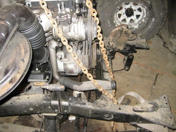

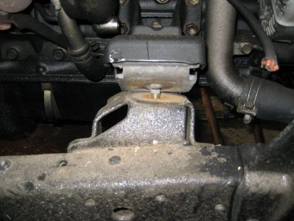

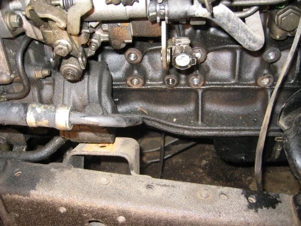

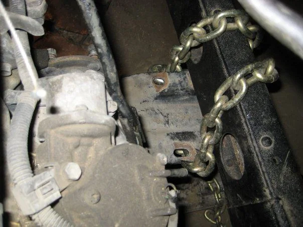

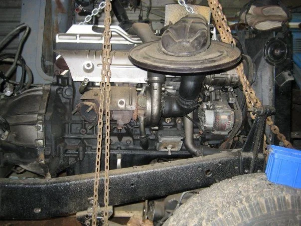

Holy well engine is not a direct bolt in to the motor mounts... too bad guess I have to do a little fabricating. ;) Here are some pics. You can see where the original engine mounts put the 1HD-T and it is to far ahead.

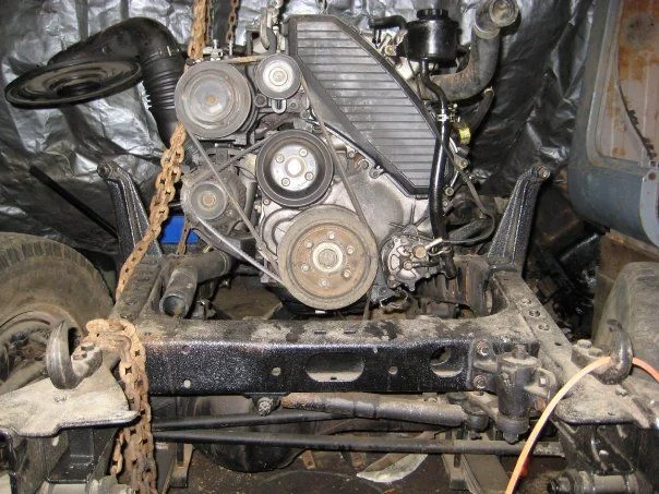

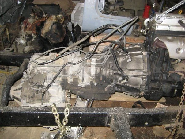

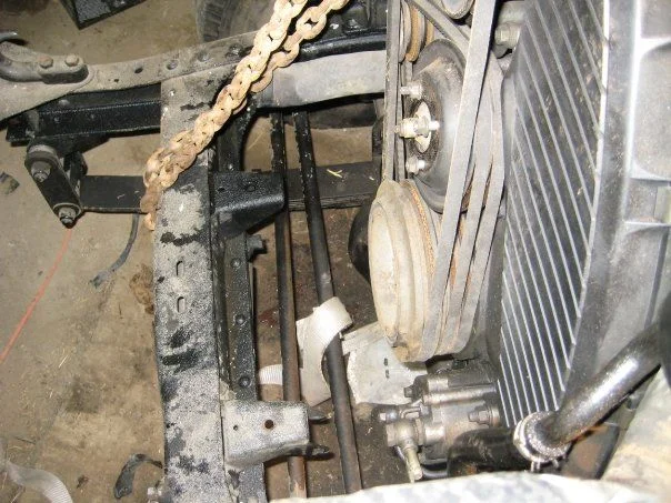

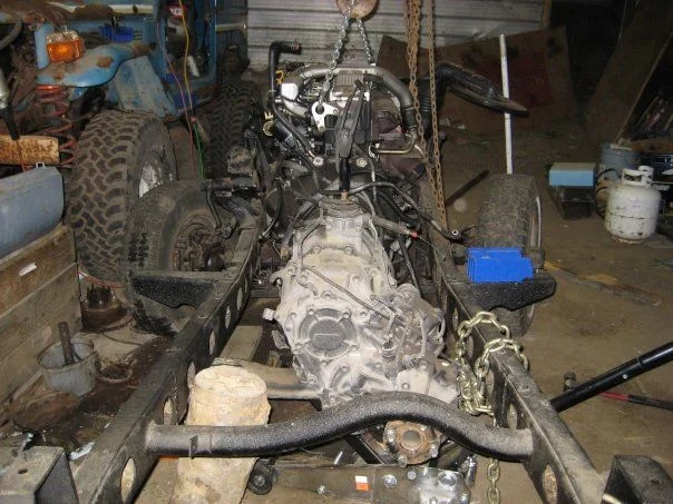

Now you can see where the engine has to sit so I am going to have to fab up some engine mounts but I want to get the cab sitting on the frame to make sure I have everything just right. So I better get some metal to fix the rust under the rear cab mounts so I can get it back on.

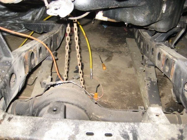

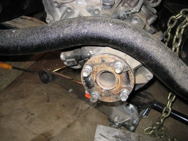

Rear of the engine and a picture of the frame after I removed the factory engine mounts.
Well I got the engine and tranny set about where I want it now I have to start making mounts. With the whole drivetrain being roughly 76 inches long you would be hard pressed to put it into a 40 series. Front driveshaft is going to be roughly 40 inches long and the rear driveshaft is only going to be about 36 inches long. Its going to be a tight fit but it is going to work just fine.

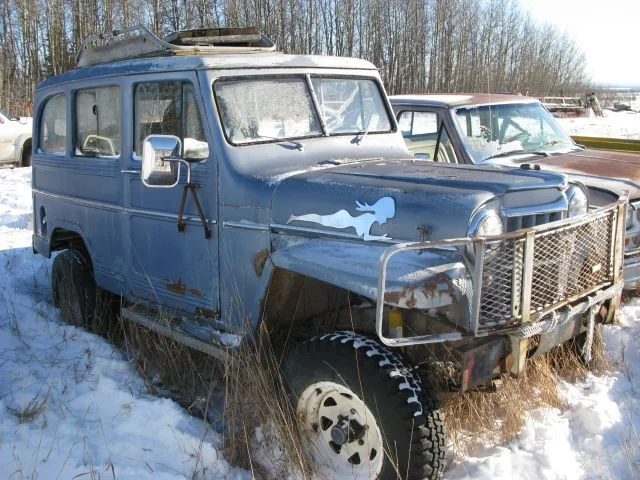

Good stuff John. I think I found something to put that FF axle under, 52 Willys wagon.
What happened to putting it under your cruiser? haha. I just wish that my Cruisers were closer so I could really get things done.
Well, Santa dropped the Willys off and it's gonna need new axles and I think LC axles will work just about perfect. It's still in the back of my truck awaiting a new home :p

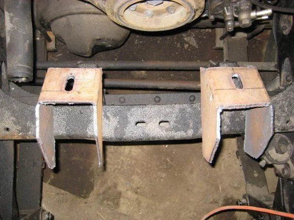

Well took a while to get everything lined up. Got one engine mount cut out still have a bunch of welding to do on it. I will have to make the other mount today. It's only -18 degree celsius so we will see how much I get done in the cold. Might have to start up the propane heater haha. Pics will be up later.

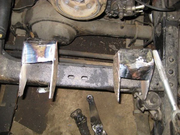

Well it was but cold, but I got the mounts just about finished. I need to box in a few areas and bead blast them but for now these will have to do. Here are the pics of everything lined up.

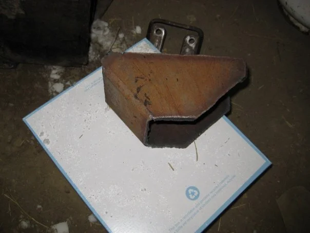

Here are my mounts. Still need to box a couple areas but it gives you an idea. I love the plasma cutter.
Okay got the mounts finished. Welded inside and outside of the boxes and then all edges cleaned up with a grinder. They are made out of 3/16 steel. I brought them back with me so I can bead blast them at work and then weld them to the frame and prime and pain them. They turned out good. I cut the boxes at an angle to the frame contour so that it is not sandwhiched in between the frame.

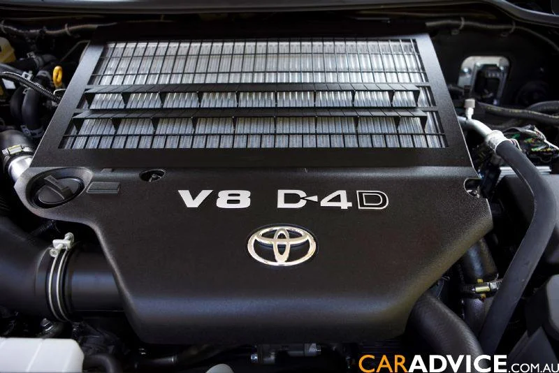

That engine in Australia has been replace now with a 4500 litre intercooled twin turbo V8 diesel.
Not sure how much one would cost but that would be an aweome engine conversion
Keep up the great thread !
There is one on ebay au for $15 000 big ones with out the intake etc
