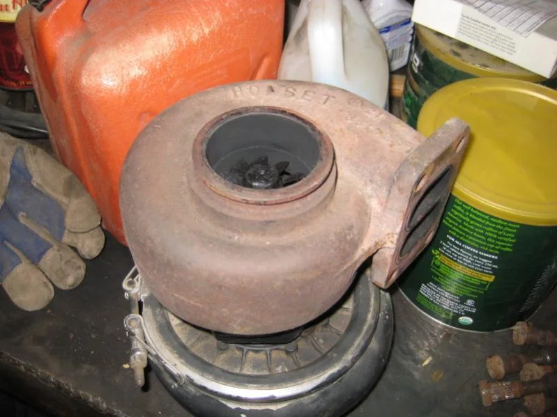

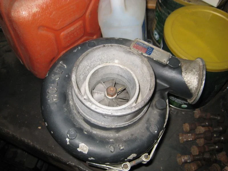

Well got another piece to the Cruiser puzzle. Picked up an H1C Holset Turbo to replace the CT26. Right now it has a 21 mm exhaust housing but I am currently looking for a smaller wastegated housing off of an HX35. Hope this turbo works well for what I want to do which will be max boost of 30 psi.

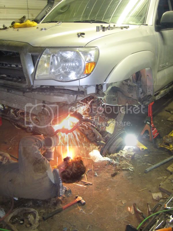

Well now that the Tacoma has a solid axle and is not eating up my money in wheel bearings as well as other parts for the crappy IFS I have pulled the Cruiser back into the shop for some serious work this winter.
I pulled the front axle out and cut everything off the front. I'm going to do a shackle reversal as well as outboard the springs to fit the 60 series axle properly. I ground off the line-X off the front part of the frame so I can plate it. I will plate the frame to make it stiffer to try and get rid of the frame twist that the 40 series is known for. I will also box in the front frame horn to increase strength as well. Here are some pictures of the stripped front of the frame.
