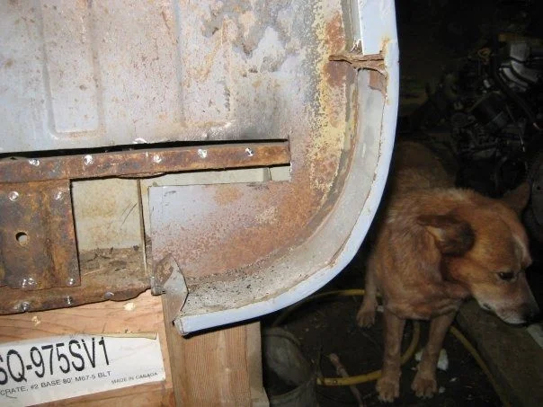

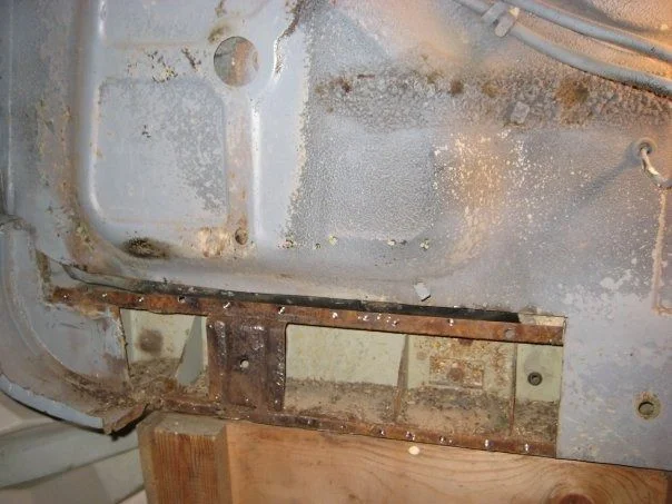

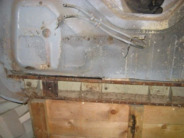

So I continued with the body work some more and have decided to cut the whole way across I'm half way there. Drilling spot welds sucks. New metal and no rust underneath will soon follow.

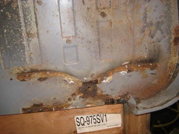

More work to the back of the cab today. Got most of the metal out now just have to bead blast and primer so that rust doesn't form between the two pieces in the future.
One more pic with my helper. Just wish he could've drilled all the spot welds.
