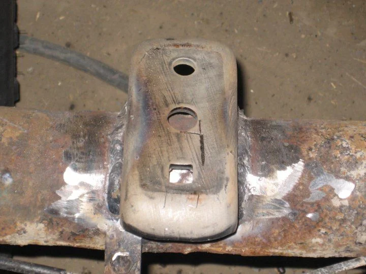

Well I wasn't happy with how my spring perches turned out. I had to fill in to much with weld so I stopped by Altitude Adjustments and picked up some new perches for cheap and redid them.
I welded them in using the Arc welder since the mig isn't really big enough to get good penetration.

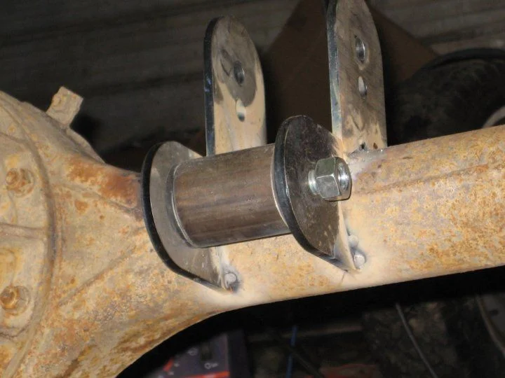

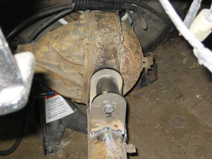

Also built my trac-bar mounts on the rear axle. I'm using chevy spring poly bushing in a chunk of DOM. I'm going to finish the rest of the bar when I have the weight on the springs and it sitting at ride height.
Then made the lower mount and braced the upper mount tabs together.
I curved the lower mount brace plate so that its not a sharp angle that is going to get caught on obstacles and rip off. Also should provide some protection for the lower bushing. I then welded everything up using the mig since there is enough surface area and weld I shouldn't have a problem.
Next will be changing the perches on the front axle and trussing the rear. I am going to hold off on the front trac-bar and front axle trussing till I have the engine back in the frame for clearance purposes.
Here is the pic of it welded all together. It should hold together its made of 1/4"

Thanks, that is the reason why I got the new perches. I couldn't put the heat to the ones I cut off and rewelded on because it kept blowing threw.
