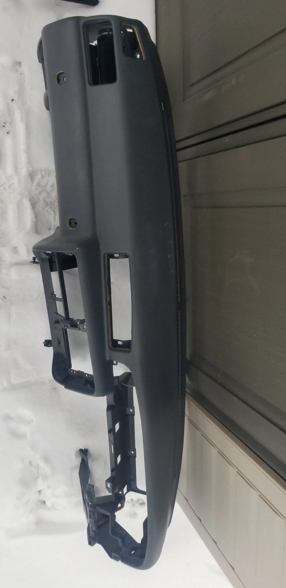

There's nothing wrong with selling parts in "unknown condition" as long as you specify that in your ad. Making the truck driveable will cost you much more in money and time than the extra money you can make by selling the parts as "tested" instead.
Having said all this, if you do decide to go against everyone's advice, i happen to have quite a bit of parts for sale that you would need :
