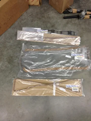

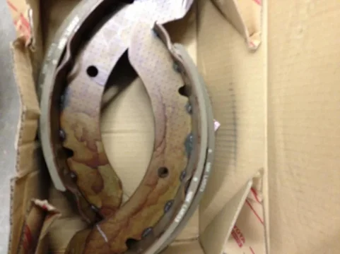

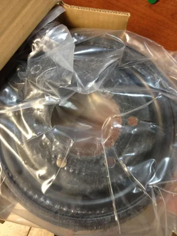

Onur can correct, but I believe this is dang near every OE part possible, at least that I needed which was everything, still available from Toyota.

Small sampling of the shipment.
I'm going to immediately cut and shred the right side of the line item invoice off, then list what all I've got.
Come on now. lets see some OEM goodies!

My immediate concern, regarding all the blabber above, is being able to sort the OE parts from Onur, but some are baffling me, then I need to compare to the original list that Pighead helped compile, and see what's left.
I've bitten off more than I'm capable of chewing on my own, so very, very, very grateful for all of y'all that are helping, to say the least.
The cache from Onur....
List to follow.
In going to yet to sort into the proper categories then see where I screwed up.

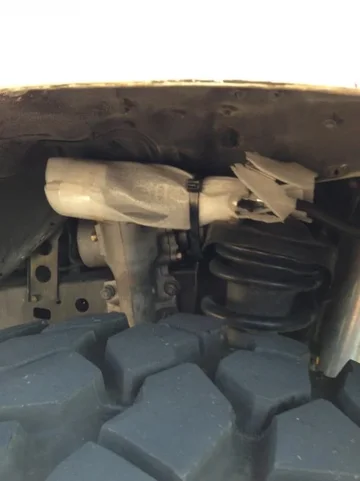

Have a clunk and a squeak that I can't locate and it's pissing me off.
Swapping TREs (I will never run 555s again, unless there's no option and half price to buy two sets) hoping that there's vertical play in one that I can't replicate manually, then going through every bolt, again, on the entire front end.
Have a starter to swap, isolator that has to be installed, since the last trip out about toasted the primary battery, after winching another 80 up a steep incline, hub studs to swap (back to OE), wheel studs to shorten, and full round of fluids.
I had a similar squeak issue on my 80, ended up being the poly bushings on the OME shocks ... you couldn't get the nut tight enough on the stud under the brake master. Replaced the poly bushings with OEM rubber, torqued the heck out of it using a strap wrench on the shock body and long extension with a wobble on my impact wrench. I also had a clunk at another time, check your sway bar bushings ;)
Tucker
Tucker
The shock bushings are new from Radflo, which have proven to be high quality on the FJC.
No sway bar, so that's ruled out.
Best I can ascertain, there's slop either one of the DS TREs that I can't replicate or the pan hard bushing is shot. It's a poly so wouldn't surprise me.
Going to have front and rear pan hards built solid bar, using OE bushings, once I can find someone that can bend it around the front diff or cut the ends of these I have an weld housings that'll accept OEs onto.
Once a length, measurement, configuration is established, having adjustability in any is unnecessary and I'm systematically eliminating.
