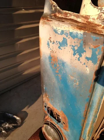

Few other pics.
Much worse once exposed.

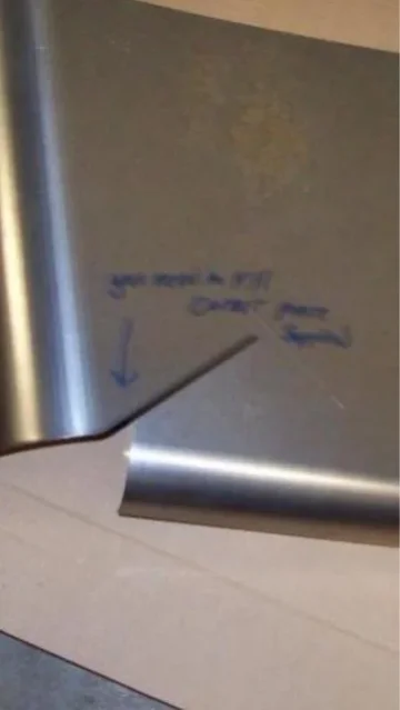

What we think we're looking for are the parts for the Sharpie directions "you need to fill corner. Pieces supplied".
Not sure what those "pieces" are.
Well I hope they are NOS and beautiful, I've got a complete rear axle with a recent brake job I'd have sent you for much less. They were cylinders from SOR, not sure what brand but nice stuff.

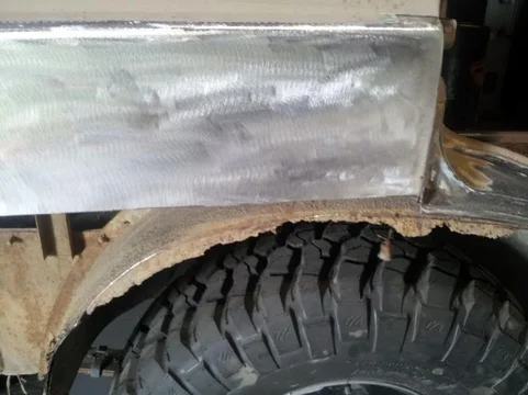

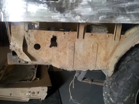

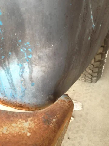

The entire arse of the end of the Pig has been beat, twisted, pulled, patched already, all covered with 1/2-3/4" of bondo.
The rear corner is recessed in a 1/4" on the PS, too much to not address, so the parts Pig's pork hams will be inspected tomorrow as potential donors, an effort to produce a top notch job, get initial purpose, anyway.
Lots of little issues that are being addressed as she's in a lot worse shape that I originally thought, but not sacrificing quality to save time or effort.

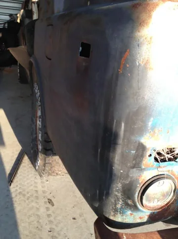

The rear of the parts Pig had already endured some degree of bondo-less body work, so hoping viable.
Will know tomorrow once he sees. I think he's bringing cutoff and tow truck, so hoping I can get it there in the morning and remove anything and everything that I can.
Britt contends that the rear of the 72 has been hit, at least on the PS corner and PS tailgate. Maybe the entire rear, but that's as far as he's got with the grinder.

His confusion on the printed text on rear quarter patch regarding the corner was similar to mine, thinking it was describing another formed piece.
We both understood after reading the message, but I have a greater appreciation for the reasoning behind your patch "as is" and as discussed in the thread, versus a completed panel with the corner, because it would never fit right, considering the minor variations inherent to the body itself. At least, as I see it.

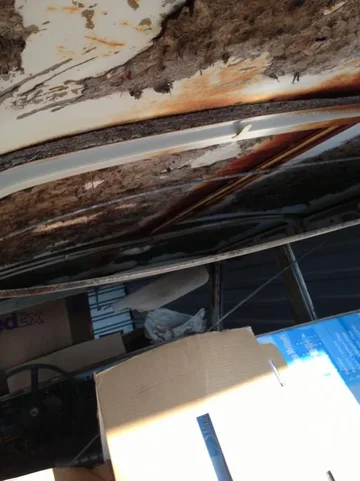

if you tear into enough pigs, i think you will find lots of bondo. i have no doubt that some was required due to the complicated curvatures. throw in the fact that these were marketed as tough off road rigs and were probably treated as such.

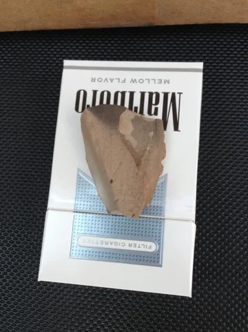

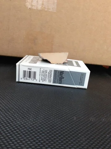

Bondo seems a means to simplify some of the curves.

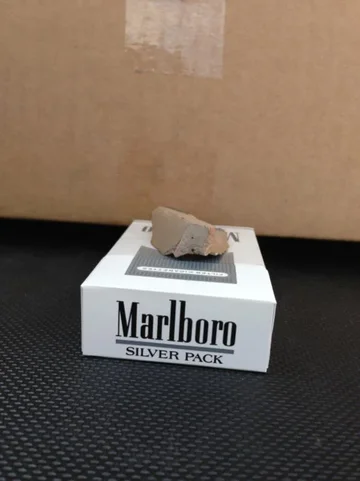

Saving this piece from the corner, but you should've seen the pile.
Your Pig has had plastic surgery!

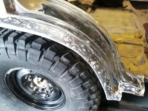

Yep, so now to the reduction.
I'm looking at the parts Pig and thinking this will and that we (Britt and I) should've looked closer at before spending any time on the rear quarter patch.
If I offered any of the parts that I may potentially use to anyone and they were counting on, regardless that I did reserve right to first pick, I'll try to help find whatever I may now not be able to supply.
Feel badly about cutting her up, anyhow, but it is what it is.

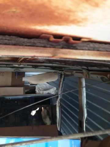

Think I'm going to let Britt determine the cut lines though, because I don't know how much overage is really necessary, plus the pillars themselves may be useful.

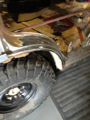

Right now it looks like I could cut the roof off, then cut at the lower rear door sill, all the way across the floorpan, and remove the entire back section, and have a better finished product, overall, but I'm not a body guy in the least.
Does anyone know of any subtle differences between the rears of the 71 and 72?
Anything from the 72 I should transfer to the 71 arse, if this route is determined?
Obviously, the pro will decide, but what I'm thinking is,
Start the cut from PS to DS here...
All the way across the floor pan.
Then cut the roof loose in the same line,
primarily to maintain structural integrity for transporting sixteen miles across town.

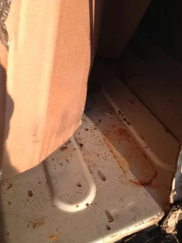

The inner is shot, but have a patch for that.
The flat of the panels aren't perfect, but have a patch for that, too.

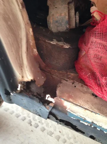

Floor pan in cargo bay can be used, instead of patching the 72s, plus this way the PS wheel well , THE ONLY RUST ON HER ACCORDING TO PO :flipoff2: could be used with the seat support still attached.
Think anyway we go about it, the lower floor support (??. The piece that extends from pillar to pillar inside the tailgate opening at the bottom??) will have to be fabbed.

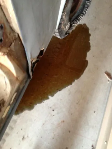

She bled out, too.
No clue why.
