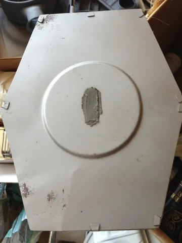

Thinking about doing the two rear heater housings I have, too. Should be more durable than paint, I'd think.
Considering the color would be very similar, would silver CAD plating be advisable for these?
Have two complete heaters, both blasted and ready for self etching primer and color matched "Ash Grey Poly" paint, but since CAD seems to be a long term finish.....
Try it on one, see how you like it!
