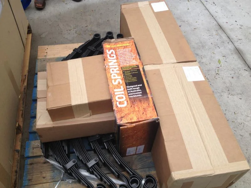

Got Parts from Man-a-Fre
Ok about time!

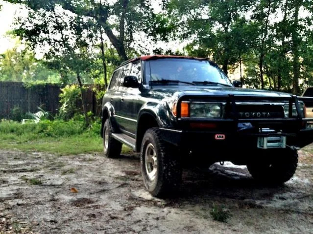

Finally got the parts from Man-a-Fre :cheers::bounce::bounce:

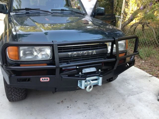

So my Dad has a 94 FJ80.
We was able to order all out parts together and he got a 3" old man emu and an ARB bumper.
I was able to get him a SmityBuilt 8000 pound winch and do the install this weekend.
Here are some pics, turned out awesome!

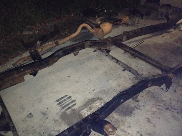

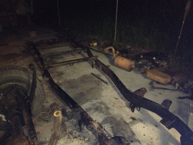

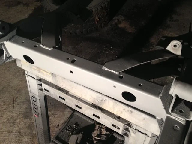

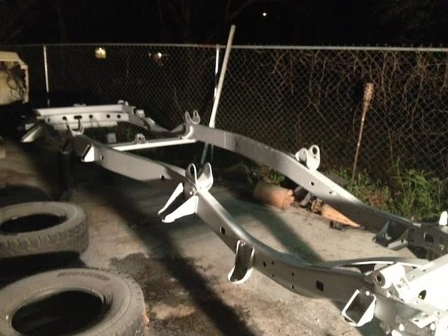

Working on the Frame

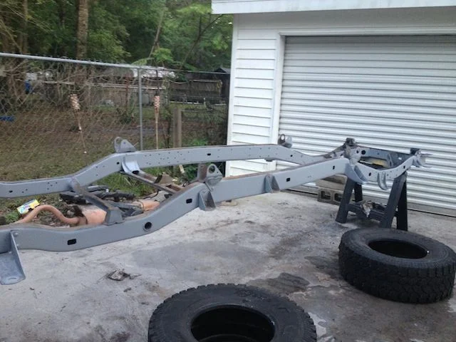

I was able to work on the frame with my buddy Ryan. We was able to remove everything from the frame and and get it ready to wire wheel down and primer. I think I am going to rebuild the Axles first and then work on the frame, still got a lot of work to do!

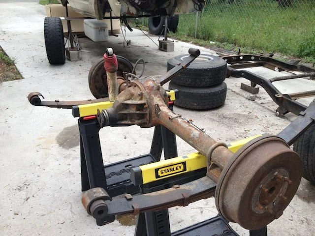

Rear End
Does anyone know, and good doc or something that will show me step by step on how to take the rear end apart. I have the FSM but wanted to have some other docs from other people to make sure I am doing everything correct taking it apart and putting it back together.

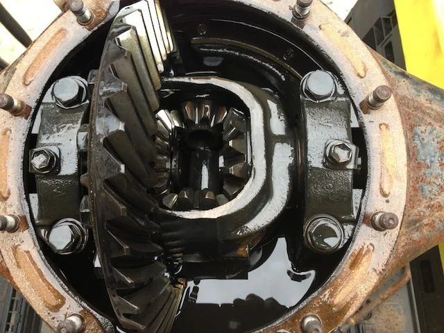

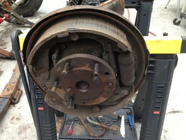

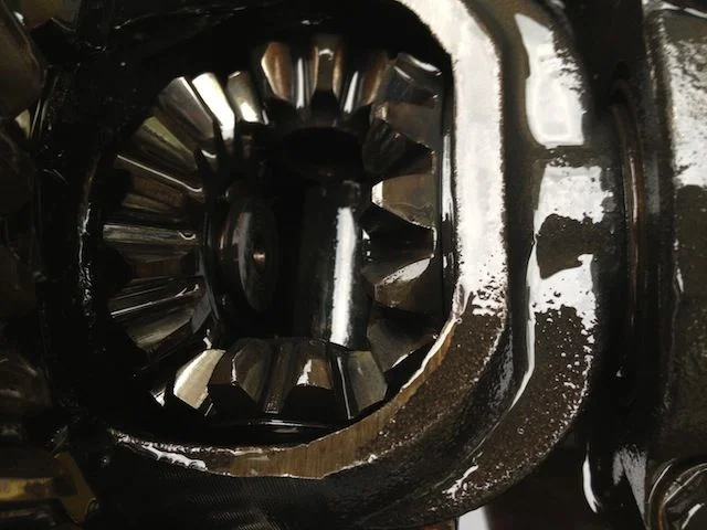

As you can see in the pics above I was able to remove the main pin and then take the C-Clips out to remove the Axles. From there I was able to remove the Axles and the 3rd member. From there I have not done anything else, waiting to get some more info before tearing down the 3rd member.
If you dissasemble your third you should set backlash again. You can simply disassemble it, but if your not replacing bearings or changing gears there isnt much reason, though if it does have a lot of km's on that third checking your backlash and adjusting it would probably be good as it would have a bit more slop in it after everything has some mileage.
There is a plate that keeps an adjustment ring from turning, that moves your differential side to side, which increases or decreases your backlash, that is all you should be adjusting unless you have parts you want to replace.

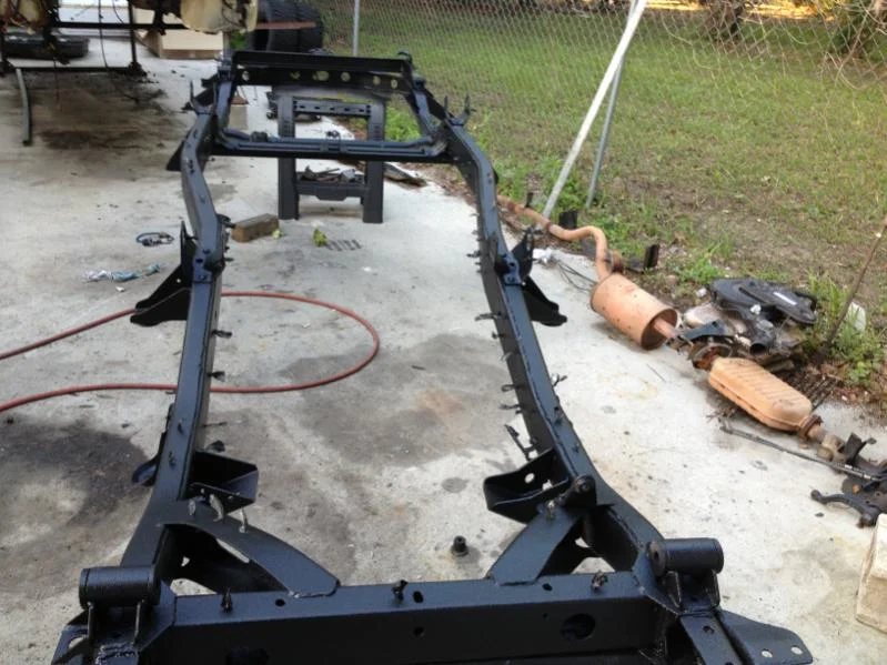

Was able to raptor liner the frame, turned out awesome!! :) raptor liner was very easy to spray and covered very easy. Only used 3 of the 4 bottles to put 3 coats on frame.
