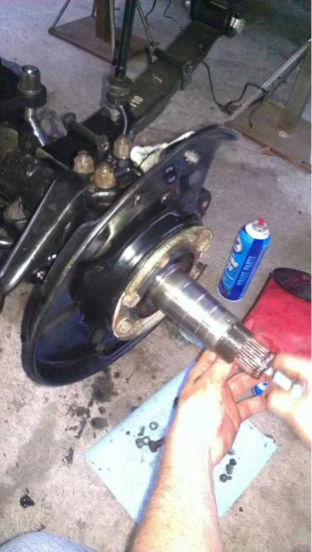

So now I am at the Point where I need to clean all my parts and put it all back togather.
I bought a completed rebuild kit from Man a Fre and will be replacing all the parts.
What is the best way to clean the beirfeild joints?
Use brake cleaner and then pack full with wheel bearing grease?
From what I have read... this^^

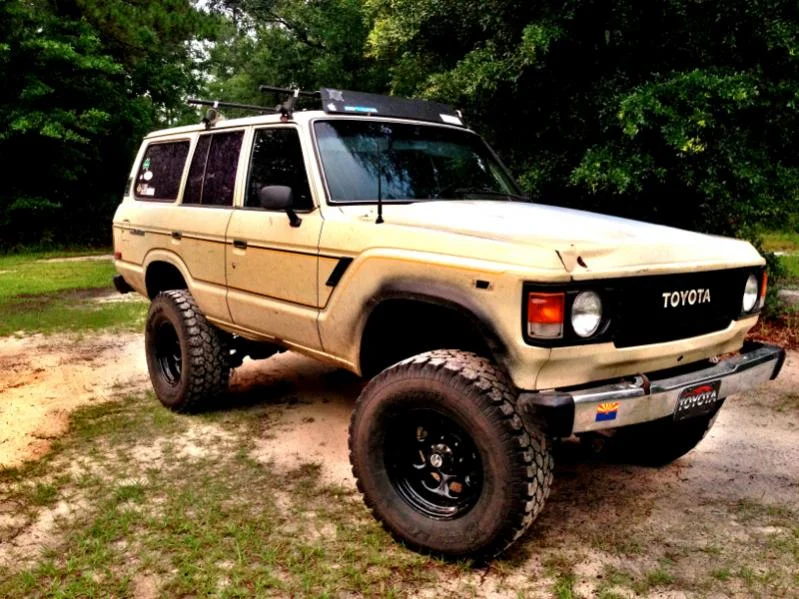

I was able to get the fj60 back on the road. She runs pretty good need to do some more tweaks and modify a couple things. Was able to driver out to the beach yesterday she ran great.
I am going to upload many pics of the build process here in the next couple days.

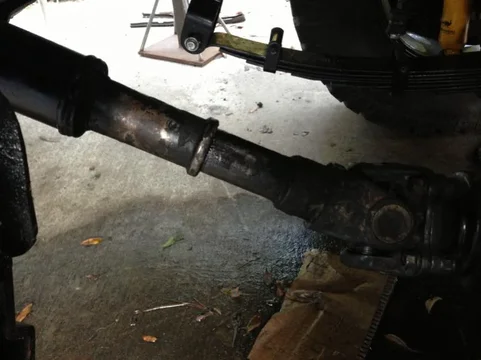

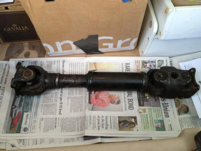

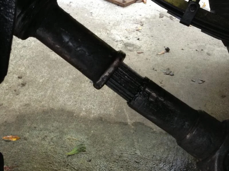

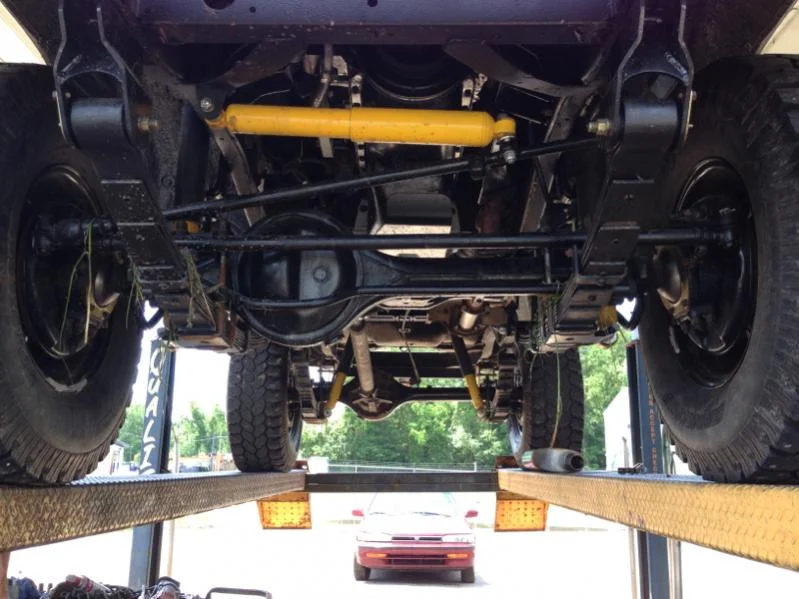

So I had to get the front drive shaft lengthen. Well toon it to the shop they out new u joints Ina and everything. Except, the never lengthen it .... Lol. I had to take it back up there and they fixed it for free :)
Nice! i just got finished with my axle rebuild as well, messy stuff haha. Wagon looks GREAT.

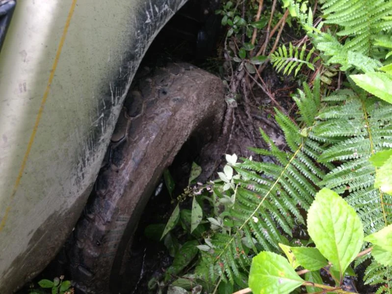

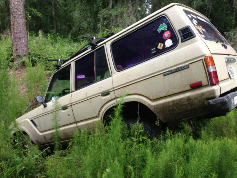

So when I went to GA to hang out with my buddy Wayne we decided to go ridding around on his farm. Well little did we know that the st.marys river divided to dig a ditch in his yard about 6 foot deep that I could not see and drove into.
Lol guns times.
Keep in mind the grass is about 3-4 foot tall that's why I could not see the ditch!

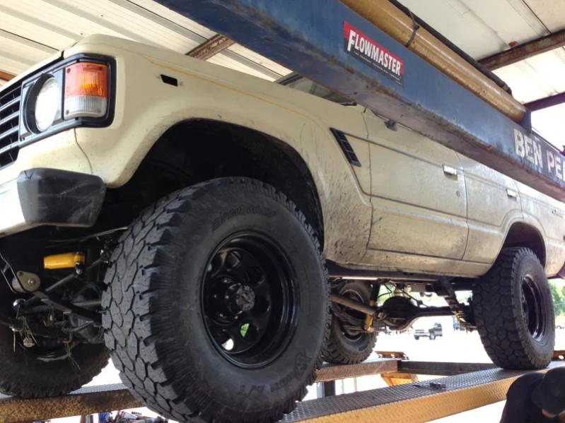

Here is the Rims I went with, they are 17".
Pro Comp Xtreme Rock Crawler Series 98 Black Wheels 98-7983S3-5
http://www.summitracing.com/parts/pcw-98-7983s3-5
There are a couple things you have to think about before you order these rims, good and bad.
1. Good - The back spacing on these rims are 3.5", which is the stock/perfect back spacking.
2. Good - The rims are steel, really strong.
3. Good - The center bore is perfect for the front hubs!
4. Bad - They have to be custom made by procomp and took 60 days for me to get them. :(
Overall I am very happy that I got them, they fit great with no issues.
If you have time to wait, get them.

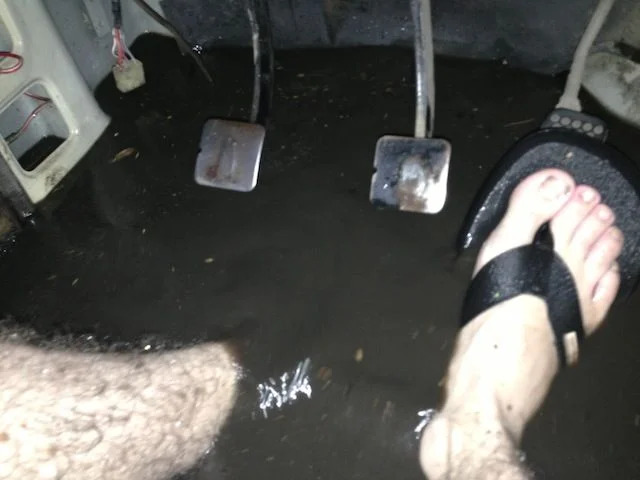

So my fun time in the swamp filled my transfer case with water :(
Came out side the other day and found this on the ground :(
Time to change the gear oil again a check the diffs!
