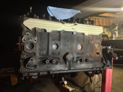

Yea i was thinking about that...lol :) I am working on cleaning all the parts for the engine now so i can paint the engine and paint and bolt all the parts back on it.
Should be fun!
Got the oil pan done and timing cover. They look awesome!! :)
Was able to get the engine painted and some of the parts back on. Still got a lot of work to do. My water pump shipped from rock auto so that install will be soon.

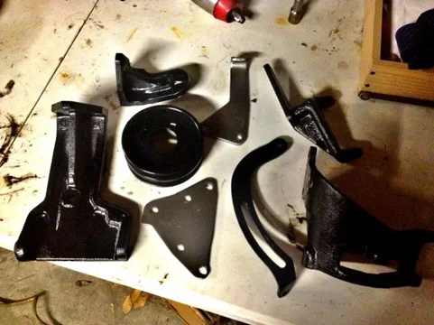

What does everyone think about the black and silver?
I have always like this color combo.
I like it... just looks clean to me. Doing a great job man. I am thinking that in the next year or two I will probably pull my engine and do a rebuild over the summer months (winter is when I need it most). What did you end up using to strip and then paint the different engine components?
Thanks! I have been working on it for a while now.
I have a Parts Cleaner that I am using. I used Purple Power in the parts cleaner and a lot of elbow grease!! :) When I am done with the hard to remove grease and buildup I then use Dawn and water and another scrub brush to remove the rest of the oil grease. Is working out really well.

Tonight I am going to work on getting the Motor Mount brackets and other stuff bolted back to the engine.

So now I worked on more on the engine, I was able to start cleaning the intake and other components. I really think it turned out nice. Let me know what you think.
Here are some more pics of the engine! :cheers:
Still working on it, I got some other little things to do.
