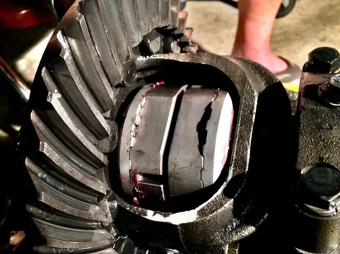

Yea, when I started to pull mine apart I was amazed by the fact the rig was not rusted at all. I was able to get the help of my friends and get the body off. I am working on rebuilding the front end and installing my new Assuie locker!!!! Cant wait.
