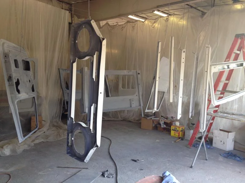

The first maze of parts hanging and ready for paint first thing in the morning. Next up will be the cygnus white parts, top cap and grill bezel. Then the tub and front fenders and hood and all the small stuff and...
Man have I been waiting for these next days for a while.

The first maze of parts hanging and ready for paint first thing in the morning. Next up will be the cygnus white parts, top cap and grill bezel. Then the tub and front fenders and hood and all the small stuff and... Man have I been waiting for these next days for a while.

Good news is the first batch of painting is done and in the basement. The hardtop sides and lentils, the bib, the windshield frame, and all four doors are done. Minor buffing of a couple of places after assembly. 'Glass cap and the front bezel get painted tomorrow so I can start building the top and doors real soon. The tub and everything else will go in by weeks end. WooHoo! In a couple of weeks it'll be like Lego time! The old, Tab A into Slot B.......
