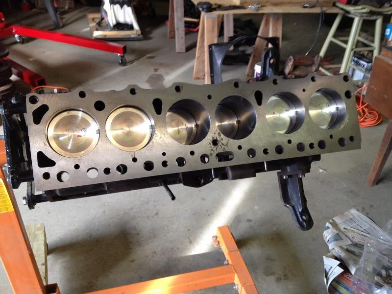

The shop was having a bit of trouble getting the timing gear off the old cam Friday so I've just assembled most of the short block. A freshened up crank and new pistons and rings are in. My first engine build from tear down to reassembly (something I've wanted to do for about 30 years) and it's looking very good thanks to my automotive mentor and Hudson owner Gene.
