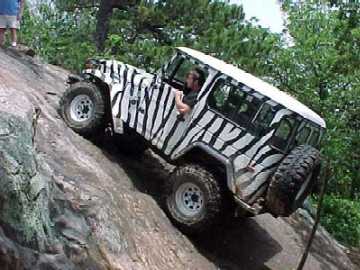

A few of you may remember me from the old STLCA days. Builder of Zebranator I and II and brief owner of a '66 FJ45. I've been asked to "restore" a '77 Land Cruiser for a friend who actually didn't even know I had owned one before. Still in the beginner stages of figuring out exactly what he wants but so far it's 33x 10.50s on (?) wheels. That means I'm shopping around for a 2.5 inch lift.

By the way, thanks for all the welcome's and the reminiscing about my old Cruiser. I have every TT copy for over 14 years and looked up the Nov/Dec '92 and found the article. 21 years ago is a long time.
