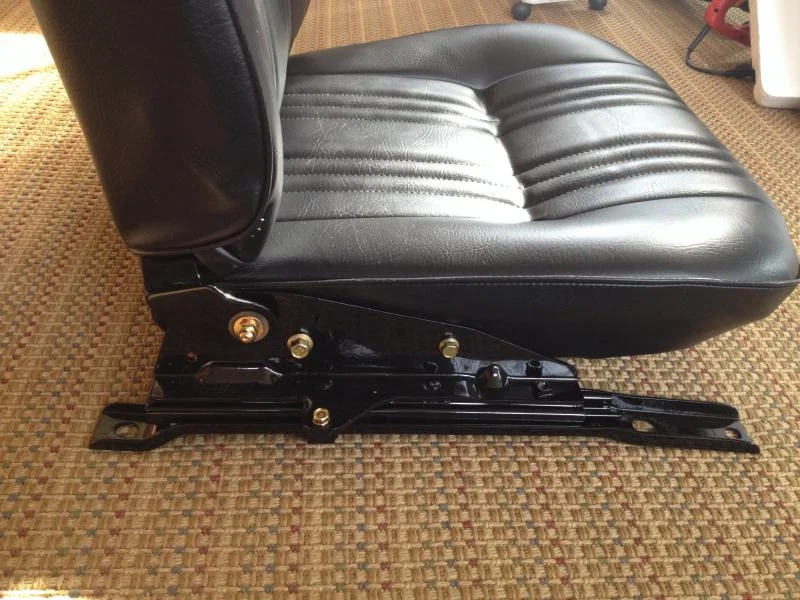

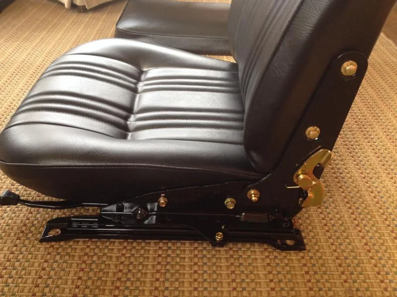

Thanks for the compliments guys. IT'S WARMING UP!! I hope to get on a roll soon with putting this together. I"m about to pull the trigger on the second and last black powder coating set. Seat parts mostly. I just wish the side pieces with the latch came apart with the spring easier. It'll be warm enough to finish out all the wire wheeling needed on the last batch of bolts to re plate. Those and a few more brackets. I got word that the dang fenders will get worked on again soon. Those are the only body parts left to paint and they got back-burnered. Cramp. I've got a replacement tank on the way and I've dropped off the radiator to get tested. I'd hate for that to be a problem. Finishing the PS conversion should end sooner than later and after a few small parts are replaced, the engine compartment will get put together (if the fenders are done) in a week or so. A few last "waiting on someone else" tasks and the truck should start to go together fairly quickly. MAN I'm ready.....

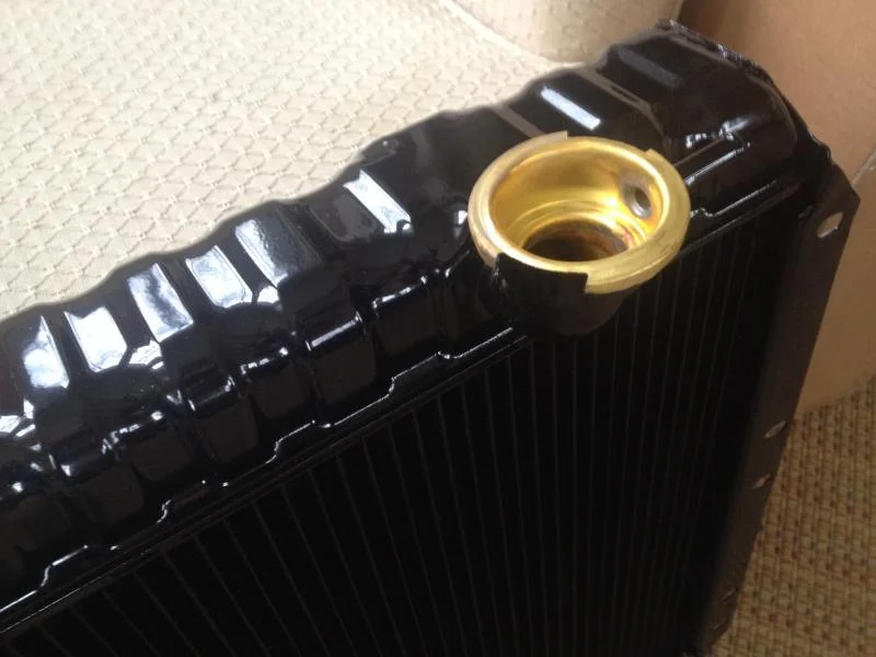

Here are the quick shots of one new radiator and one new tank. Fitting for this truck really. Turns out the top tank of the radiator was full of cracks and worthless. It was almost a sure bet the bottom one was too. Better to get this over with though. Powder coating pieces and plating pieces all dropped off yesterday. Next week I should have that all back and for the last time I hope. I haven't tackled the tranny puzzle yet but I'm not too worried.

CCOT has them. I was only a little nervous about ordering the non Toyota one but once it got here I lost all jitters. The tank looks great other than the fact they sprayed it flat black. I HATE flat black. Maybe it's because the PO on the donor vehicle tried to (and poorly I might add) spray flat paint on anything and everything black on the truck. Can somebody explain to me the logic behind painting anything on a car or truck flat?
Out of spite. I could not agree more. Everything on my truck is also flat black. I'm using eastwood's semi-gloss chassis black to remedy it. Looks good where I have applied it so far. It's expensive though, I'll probably go with something more inexpensive inside the cab.
Flat black is useful for hiding crap. Note that many of the "high-end" rustorations on fleabay are sparaybombed flat black underneath, inside the fenderwells, all over the inner floor....
It may hide crap under it but don't touch it with anything and then don't try to clean it. Only way to repair bad looking flat paint is to repaint it. Seems like you're defeating the purpose to me.

Something to post. I'll be getting close to putting the interior all together in the truck very soon. I need to install the front seal in the transmission and new gaskets. After that I can put the tranny hump back in. Presto. Everything else can go in after that. I'm still waiting on the dad-gum front fenders to get painted. "Hurry up Kiwi... dammit!" Still have a few custom items to fab up for the steering conversion and I'll post that when I get the stuff made. I've found a source for the rear harness (fingers crossed) from Brew8 up in Montana. Thanks!
