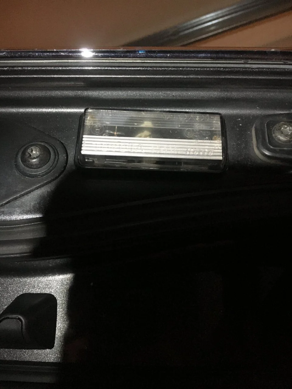

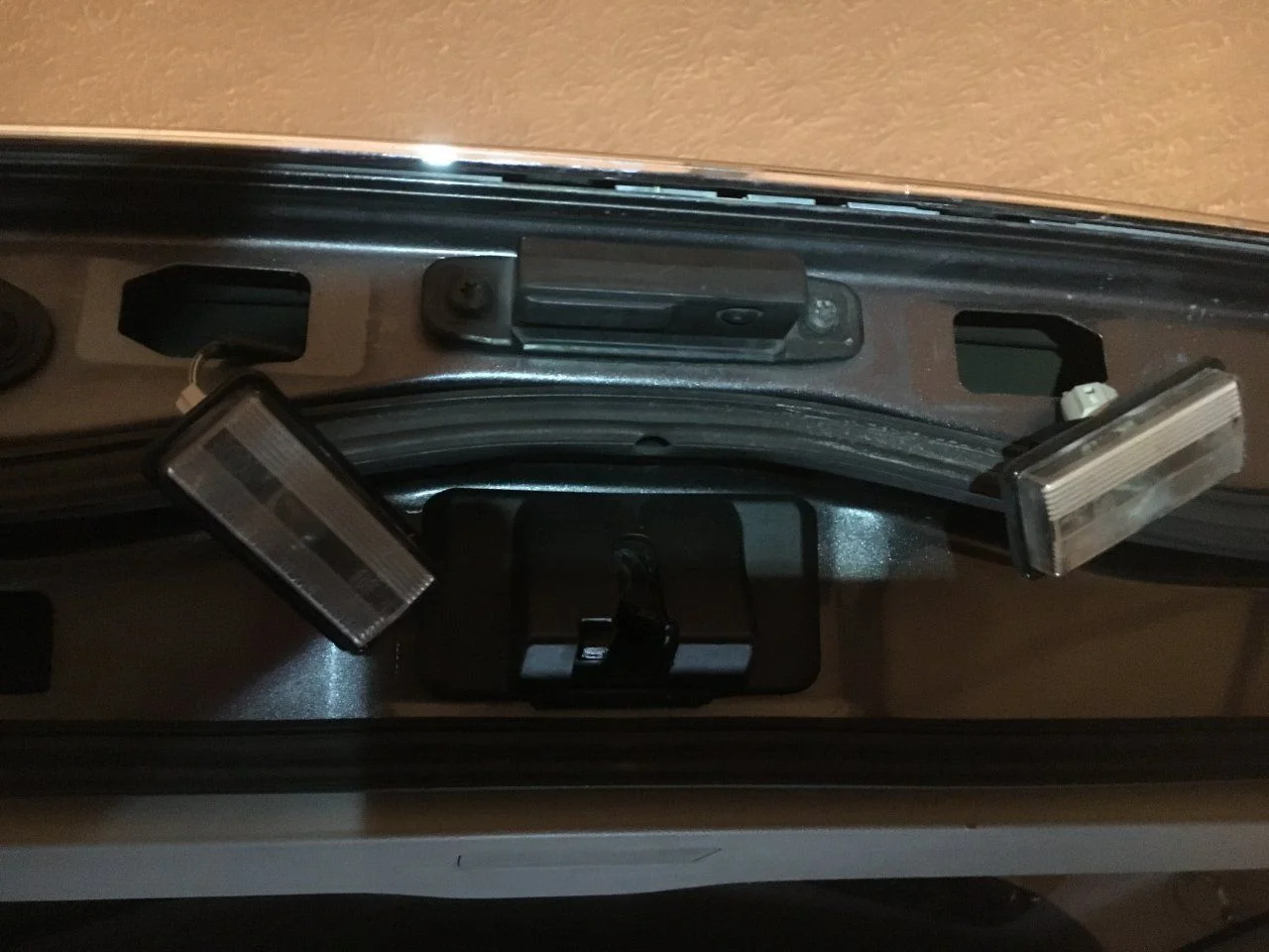

@Markuson how did you get the covers of these lights? Located on the external underside of the rear hatch release I could use brute force as a last resort.
Heh... Those are the only lights I haven't messed with. Funny bc they sorta escaped my brain completely...
Aren't those just the license plate lights?
Fair enough. Brute force it is
Yep, brute force is required. I used a plastic putty knife / panel popper and then re-applied with a marine silicon sealant since it is exposed to the elements.
Easy peasy
Looked it up. Trim tool to push one pin in and that one releases then twist and it comes off. Look at the last pick. Point of attack is shown.
