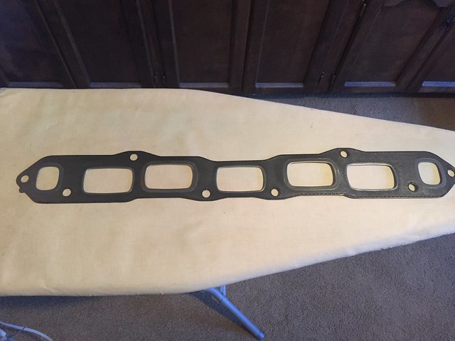

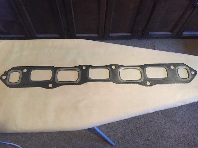

Ok so figured out the issue with the manifold gasket and why it will "fit" both ways but requires mounting a specific way.
So here is a pic of the manifold as it should be, side against the ironing board should be against the head with the side facing up against the manifold.
You can see the F <-- marking at the left denoting the FRONT.

Now this is the backside (opposite of above) with the head side facing up..
Untitled by Greg Fisicaro, on Flickr

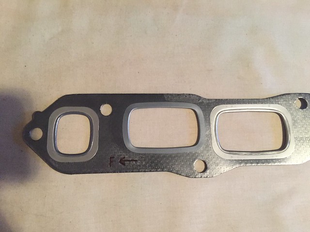

Close up of the marking F <-- (now pay close attention to the fire rings in the image. Two are exhaust and one is intake)

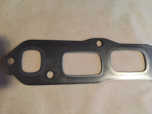

And here is a pic of the reverse side..... (again pay close attention to the fire rings)

Do you see the difference?!

Well still have the vacuum leak, replaced the gasket with the F <-- facing the proper direction and still have the same issues, high idle and the slight vacuum leak at the manifold. I did put on a welding glove and attempted to choke the carb by covering it and that worked which tells me that the leak isnt substantial enough to keep the truck running when choked off. So I guess I will just live with it, nothing absolutely major but took me about 5hrs to get everything apart, figure out how the hell to get to that rear most 14mm bolt and then get it all back together. She still runs great and I did pull the idle fuel mix screw when I had the carb out.
