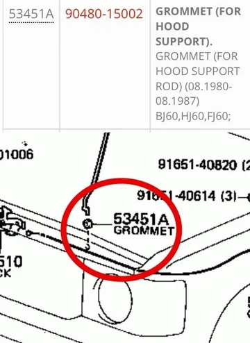

Other dumb question.... Grommet for the hood prop rod, I thought you could buy that somewhere but cannot find, only the catch clip.
Anyone know where to get one or can I just get a standard grommet from somewhere like lowes/Home Depot?
That little rubber grommet that holds the base of the hood rod is still available from Toyota.
PN: 90480-15002

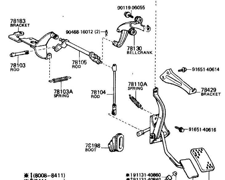

Greg, if you think the accelerator linkage is sticking, you're better off taking it apart, giving it a good cleaning with brake cleaner, and putting it back together dry. It came from the factory dry. I've tried it both ways (lubed with lithium grease vs clean and dry) and dry works better.
Taking it apart is easy (esp compared to pulling the head) - if you pull the 2 bobby pins and unhook the spring (78103A) to the throttle shaft, you can then pull the whole linkage out in pretty much one piece. There are also a couple of ball joints on the rods (78103, 78104) that are press-fit and can be pried off by hand. Take a pic of the assembly and then take it apart and clean.
This is all fresh in my head because I have pulled and re-installed my linkage many times recently. The unfortunate loose end is that all the cleaning and screwing around has not permanently solved my sticking problem. However, you may have better luck as each of these beasts is a little different. Here's to hoping so...
Thankd @DFXR for the pic... I did assemble dry after the parts had sat in the cleaner for a day. I may pull apart today while I work on replacing one of the hoses and let them sit in the cleaner again.
