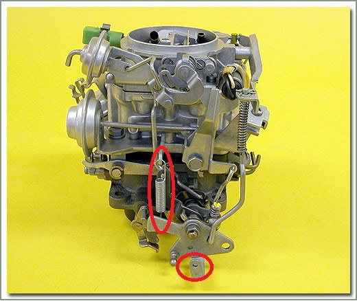

The picture above, post #1081 shows a red circle on the bottom of the carb, which has a spring that runs to the shaft at the butterfly at the bottom of the primary barrel. That butterfly may not be closing completely at idle speed... It is difficult to reach the point where that shaft goes into the carb base, and trying to free up the stick-y-ness at both front and rear of carb along that shaft is the goal.

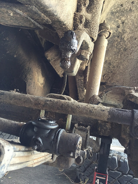

First wheeling trip with the group was a blast ending with some trail carnage... detonated the TRE at the pitman arm. Luckily one of the guys had some bailing wire and a BFH to get it back together. Took it slow on the way out, would last about a mile or so before would lose steering again which meant getting out and rewrapping everything with the bailing wire. In the end it worked enough to get us to the main road where we waited for AAA to come get us. Was a fun trip and will be going out again for sure.

Thanks Fred... The bailing wire was breaking it was just that my TREs were all so worn that anytime I rolled over a rock it would cause them to articulate and rotate. This then turn into rotation while articulating which would cause the ball to pop out (audibly) of the joint. After that the wheel just spun freely from side to side as the pitman arm wasnt connected. Part of it was that the bailing wire would flex/stretch some allowing the rotation.

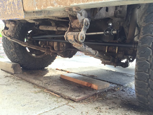

Well the day was spent beating on things with large hammers and using a club members HF steering kit (had appropriate TRE puller in it). Got everything buttoned back up and did a driveway alignment. Everything seems good other than the steering wheel being a bit off but I will mess with that tomorrow. Helped the wife get the yard all ready for spring and then was done for the day.

Drove great when I took her out and about so next couple days will see and make small adjustments here and there.
Here she is with all the new bits.
Untitled by Greg Fisicaro, on Flickr
Next on the agenda for parts will be a new steering damper since mine is OEM and probably shot!
