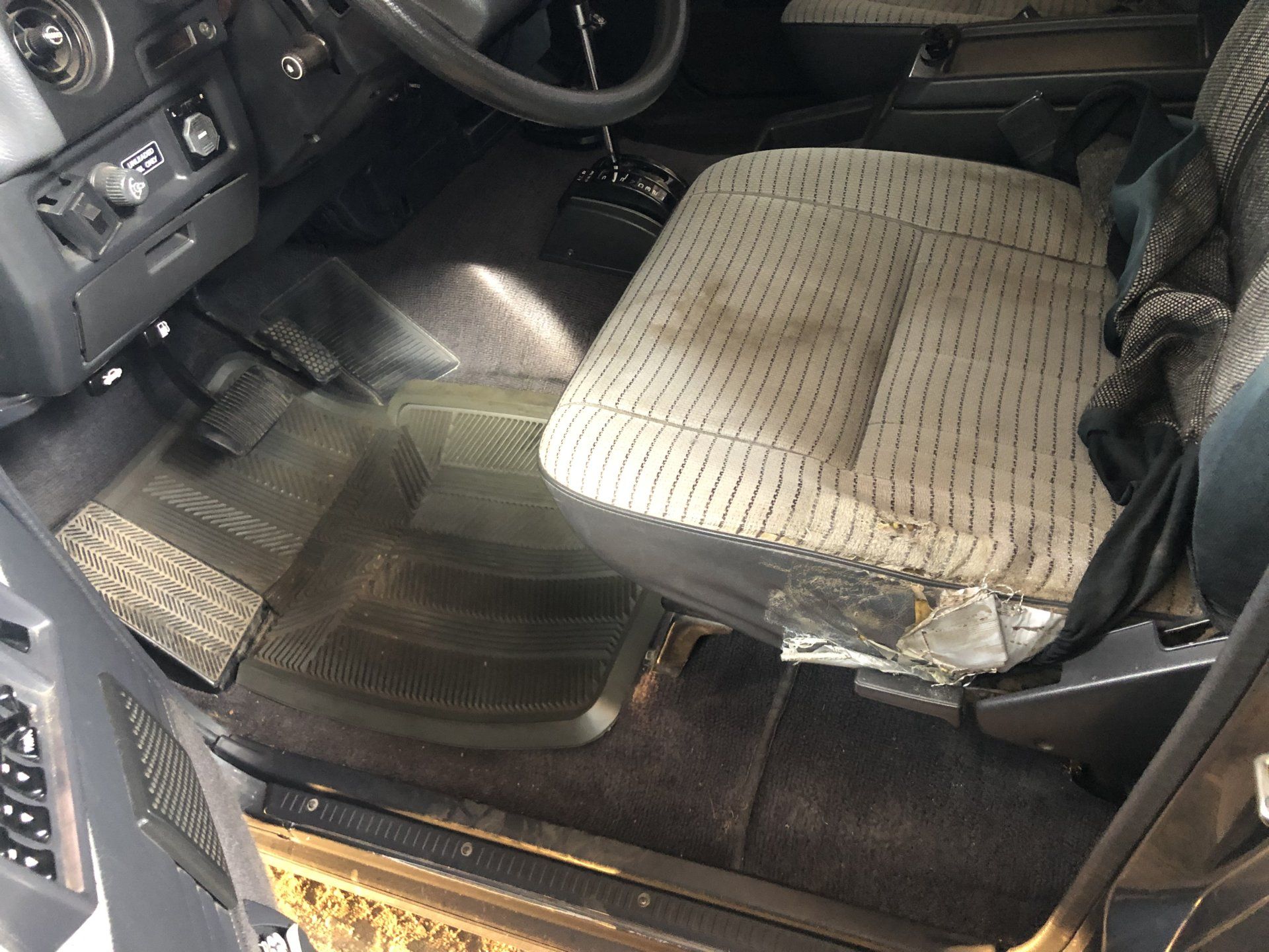

Figured I'd join in on the fun - '88 FJ62
1. Get a used passenger side seat bottom in good condition.
2.Remove your seat and take it to an upholstery shop with the seat bottom.
3. Ask them to replace the vinyl around the bottom of the seat cover. Tell them that the vinyl should go all the way to the seat back joint on the side closest to the door ( a passenger seat will have cloth material here close to the hinges.
4. Tell them to grind down the metal frame that has the sharp edge on it that is tearing the vinyl.
5. Get them to install new foam for the seat bottom and back (that they cut and shape).
Drive to an upholstery shop (or two) first if you need an estimate. had all this done for about $125. in 2018. Major upgrade in comfort. And you can't even buy the replacement foam for this little money.
BEFORE:
1903063
AFTER:
1903064
1903065
1903066

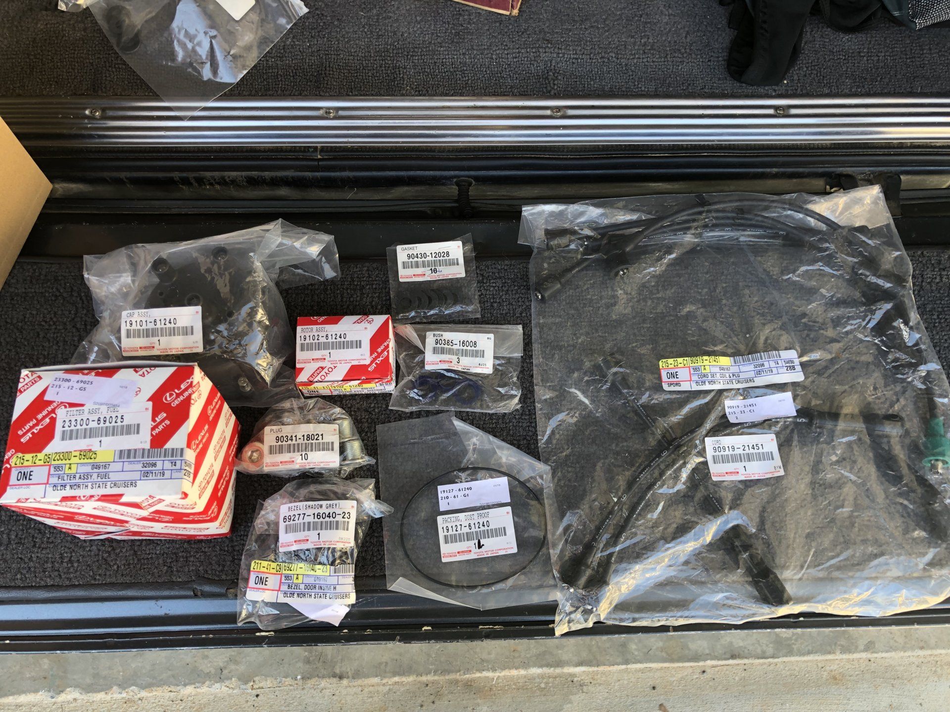

Ordered a bunch of stuff from the local dealer a few days ago and changed the oil and spark plugs in the meantime to keep me busy. I ended up using Rotella T5 15W-40 and a Baldwin B2 filter. I've been all over Mud looking at what oil everyone uses and it left my head spinning honestly lol. I figured I would try this out for now and possibly change to something else next time if necessary.
Picked that nice package up from Toyota yesterday...man I swear it is always like Christmas when you snag a big ole box of OEM parts from the dealer :D
Box included dizzy cap, cap gasket, rotor, plug wires, fuel filter, magnetic drain plugs for the diffs and transfer, shifter bushings, and some other smalls.
Not sure if it is good or bad, but ignition items mentioned above literally looked like they had never been touched by human hands. The distributor still had the OEM cover on it and all of the plug wires still had the factory routing paths with the little plastic clips. Plug wires say Yazaki 1987 as well. Honestly this is probably the first time this had ever happened to me so I easily got distracted in all of the nostalgia. The one problem with this is that it took me about 4x longer than it should have to do this job because I was obsessed with making everything look factory original 🤣

Your oil and filter choices are spot on. Good job. Truck continues to impress.
Some folks like to find trucks that have been meticulously maintained, but to me it really depends on who has done the maintenance and how it was done. As for me, I'd rather see a truck like this that runs fine but has never been messed with. When you do the work, you'll know exactly when it was done and that it was done right. A good example of this is buyng a 100 series that is in need of a timing belt vs. buying one that the seller "says" it was done. I 'd rather do the work myself than to trust that somebody else did it right. When it comes to these trucks, I don't even trust that the Toyota dealer did right by their work.
I couldn't agree more Dave. I was especially drawn to this truck after seeing it in person and realizing that it was legitimately almost all factory original. The more I dig in, the more I find things that have literally never been touched since the old girl was new which I love. The plan is to slowly go through everything to make sure the keeps running and driving great for years to come!
