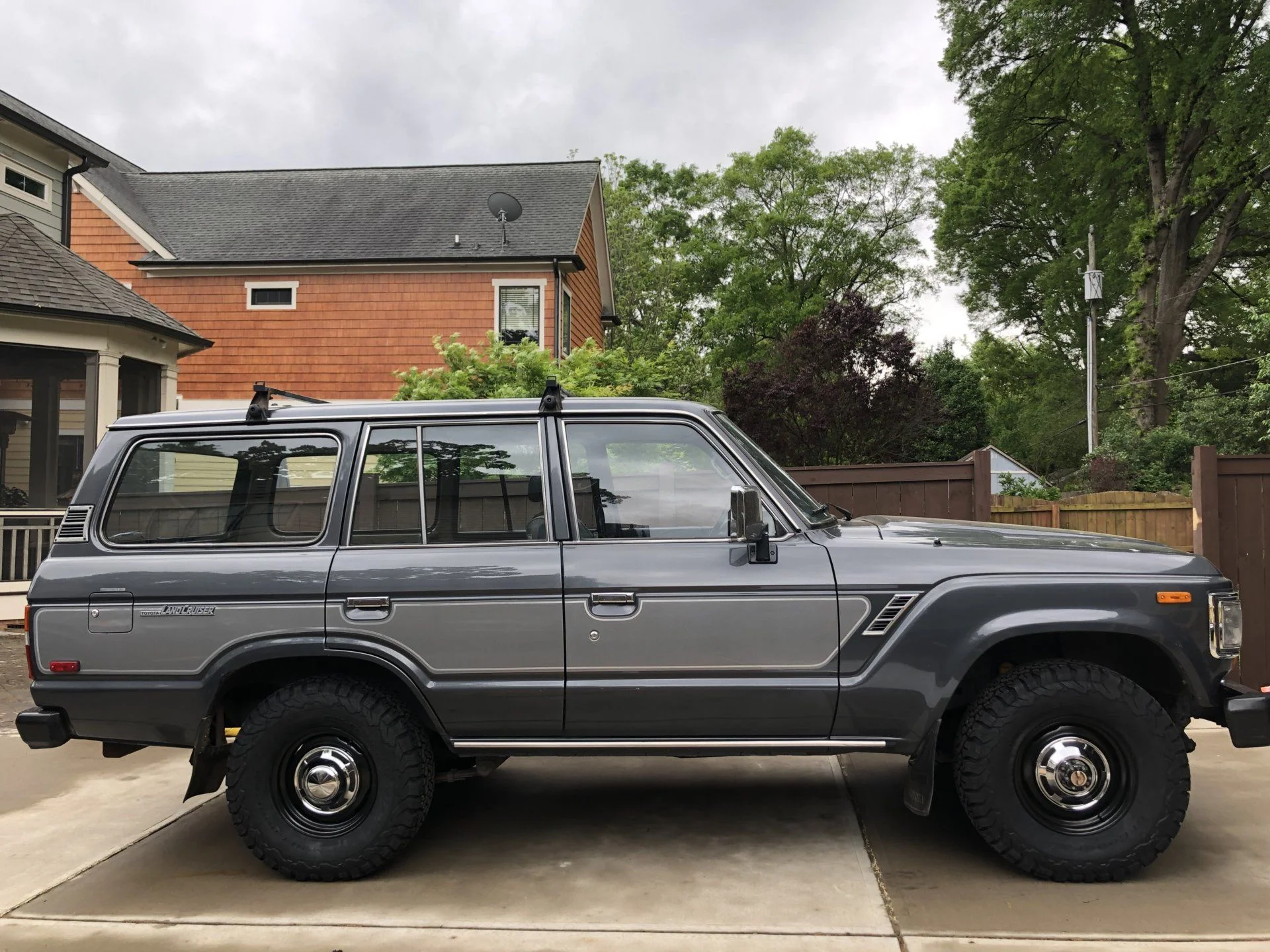

From day one I've been planning on a lift, 40 series steelies/hub caps, and 33's. Since I needed tires very badly, but am not currently in a spot to do the lift as well, I decided to order some 31x10.5 BFG KO2's and the 40 series steelies for now. All I can say is wow...I love the way this thing looks and drives now!! Of course I broke a single wheel stud while I was taking the old wheels off, so that is next on my to-do list
1957676
Man, that Decal is growing on me!
Your truck looks mighty sharp!

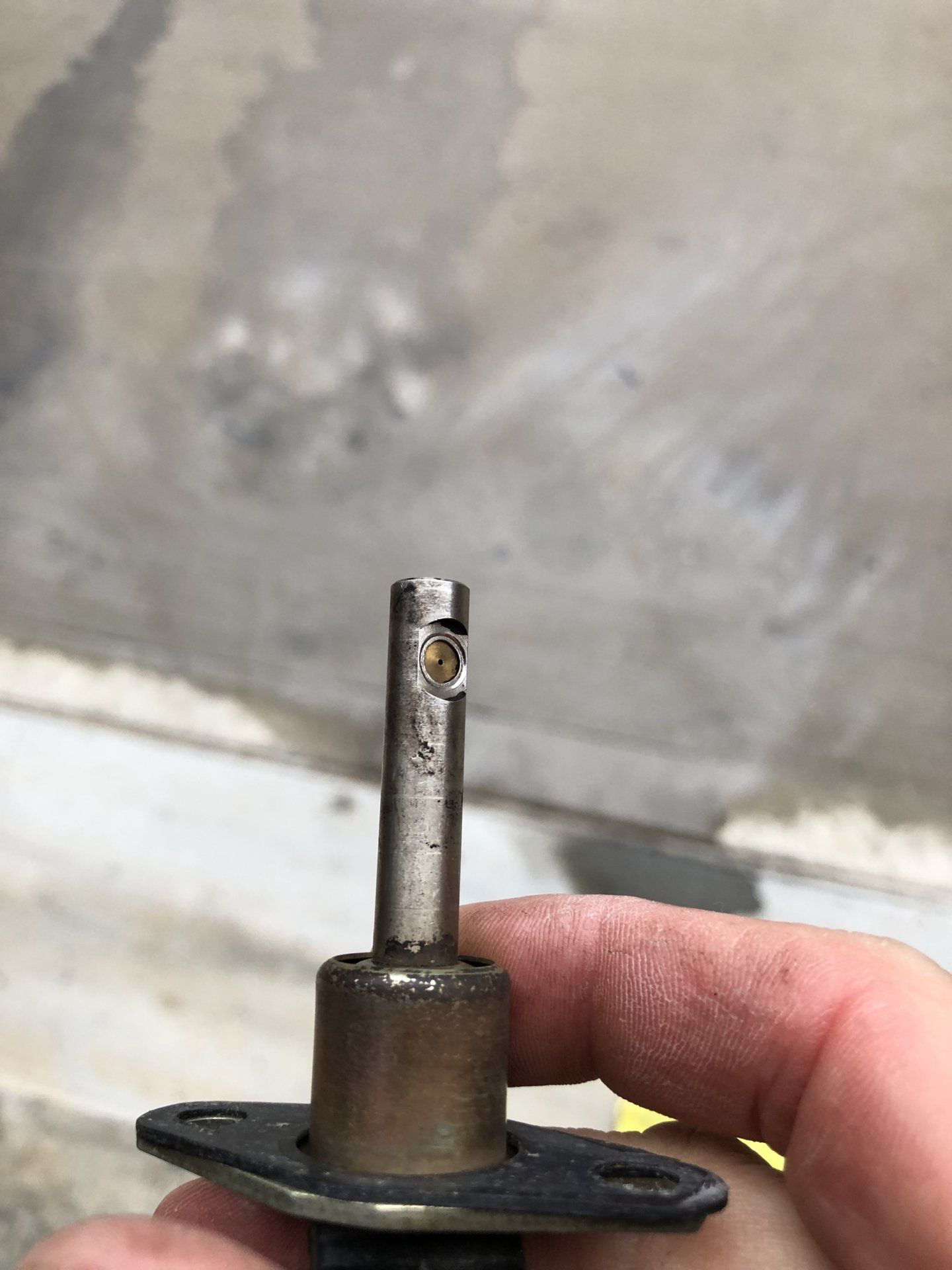

Since I got this thing home, i've had sort of a rough starting issue. Nothing crazy, but it definitely seemed like it took a few too many cranks and when it did catch, it was a little lumpy for a second. Had a little break today so I went out and paid my little friend the cold start injector a visit. I think I figured out why I had starting issues 🤣
Took all of ten minutes to remove/clean and the result is super satisfying
View attachment 1908431View attachment 1908432
what part is this?
