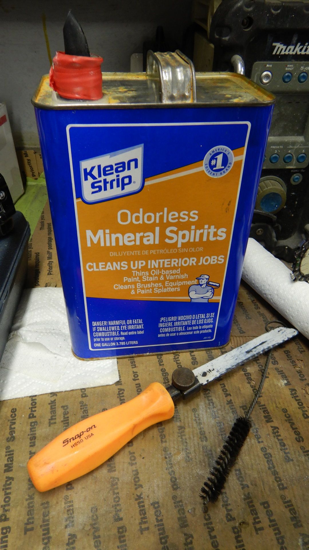

I'll keep this stuff in mind the next time I've got to take this TPS off. Literally just grabbed the closest thing to see if I could loosen it up and get it operational again
Since I got this thing home, i've had sort of a rough starting issue. Nothing crazy, but it definitely seemed like it took a few too many cranks and when it did catch, it was a little lumpy for a second. Had a little break today so I went out and paid my little friend the cold start injector a visit. I think I figured out why I had starting issues 🤣
Took all of ten minutes to remove/clean and the result is super satisfying

Since I got this thing home, i've had sort of a rough starting issue. Nothing crazy, but it definitely seemed like it took a few too many cranks and when it did catch, it was a little lumpy for a second. Had a little break today so I went out and paid my little friend the cold start injector a visit. I think I figured why I had starting issues 🤣
