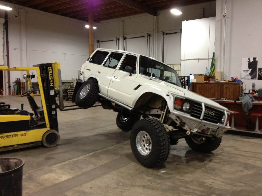

After that we played around with the forklift and did some warehouse flexing.
Rear on the bump stop. Not changing a thing!
Some dork that named his rig Dora.

Beautiful flex! Opens up really nice!
The thing that doesn't show is how perfectly Mike nailed the suspension set up. Very llittle up travel was wasted on the shock shaft... Same with the down travel. Fenders are cut nearly perfect too. You guys should have heard him being critical of himself and how he intended to to tweak a little more on it.
