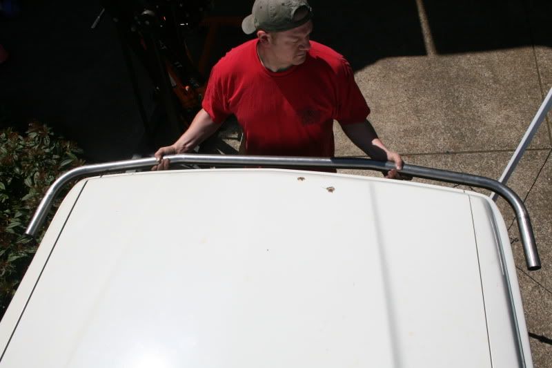

bumper...
getting started:

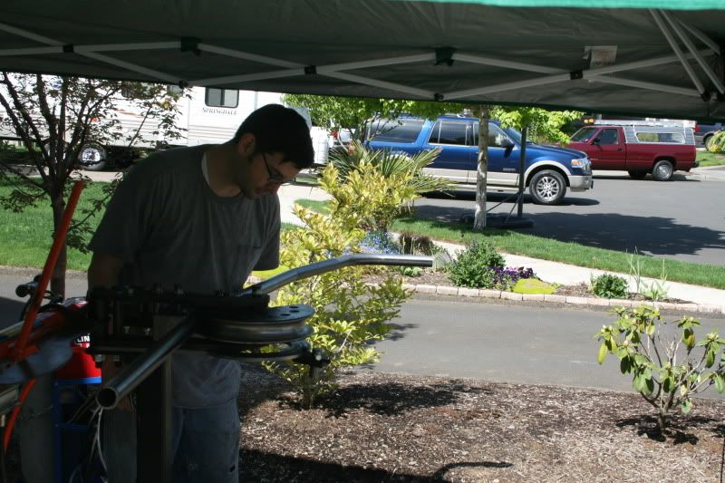

first couple Bends
nice lines:

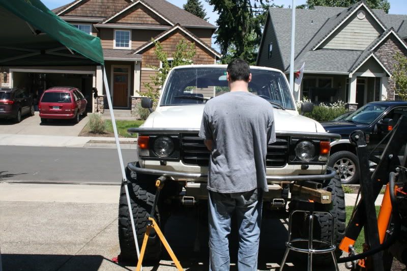

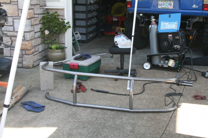

bottom bent and mock up with top piece:
Different angle

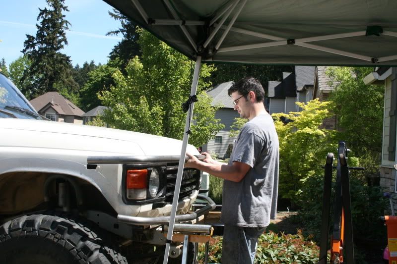

cheater way to notch:

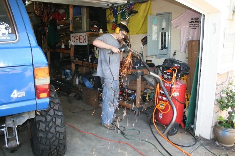

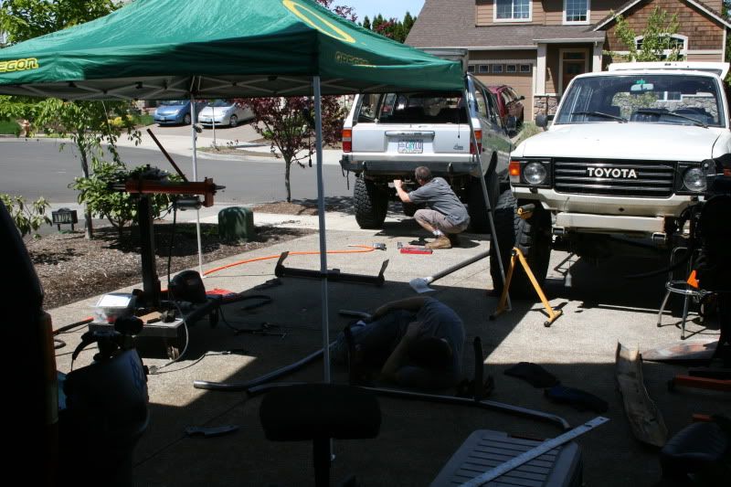

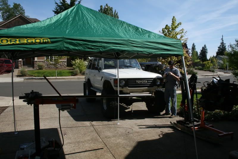

Dirtgypsy showed up to start his rear bumper... Mike is taking a nap:

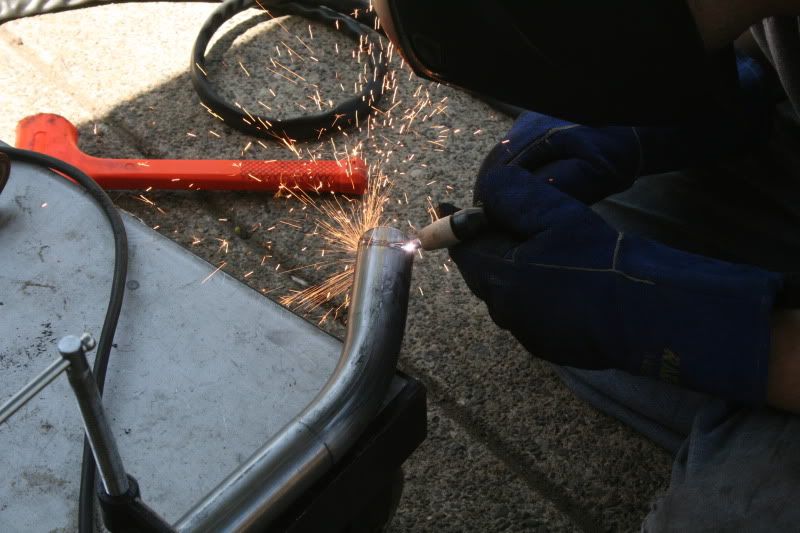

Boots bumper tacked:
me taking a picture of mike taking a picture of his bumper:

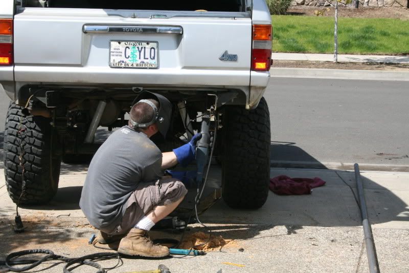

Dirtgypsy still cursing at the rivots:
Mike decided that the vertical pieces were too long... this is the way to properly secure a bumper "in progress" while grinding:
Clint still cursing at the rivots....
