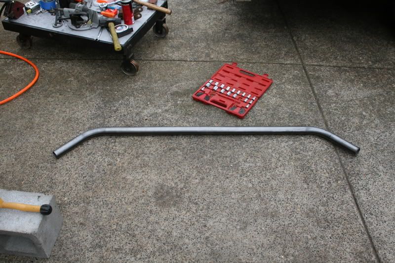

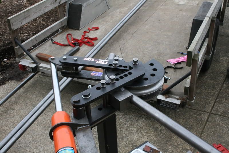

Tube being bent... the cheapo hydro actually works pretty well
Outrigger bent up:

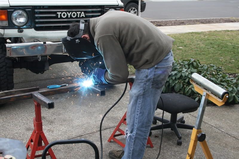

Mike welding up the slider arms:
not too shabby for his first time with a mig:

Thanks Zach for posting the pics and thanks a TON for letting me bug you yesterday, it was lot of fun. That bend tech program and your bender really make putting shapes in tube fun and easy. Glad your wife saw us using it. I enjoyed playing with your MIG welder and am amazed how fast your plasma cutter rips through steel (no wonder you don't like going back to grinding!) You are a great host and I look forward to our next fab day.

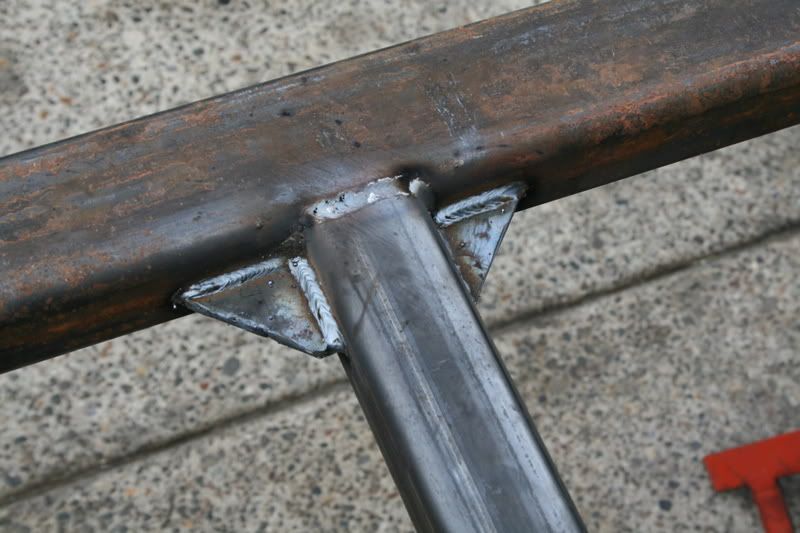

I got the outriggers tacked on and three supports per side done too. Hoping to get some paint on it tomorrow.

Zach getting the bender set up.
While the jack may be slow if you had to bend tube for a living I thought it was a perfect speed and really allowed you to fine tune the degrees.
Here is the work from this week.
I borrowed this fun little tool from Zach to get my bird mouth angles transferred onto the outrigger supports.
Here's the lines being transferred. Then I just cut out a V with cut off wheels and used a grinding disk to carry out the curves.
Now the supports are also tacked in. I didn't weld it up because I didn't pick up any new batteries for my welder but here's what they look like. The outriggers have a slight upwards slope to them.
Once I get them welded up I'll paint them and then work on attaching them to the frame.
