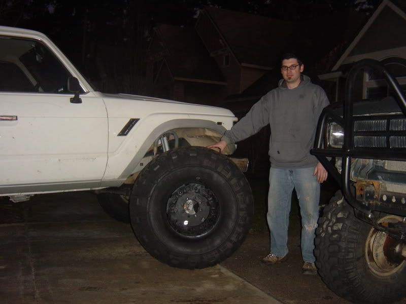

Thanks again for making the journey out here again Mike. Just seeing your rig helped alot... not too mention your tech knowledge with the springs.
and for everyone else.... Mike let me drive Dora. :flipoff2:
Its even better than it looks for those who are wondering. I enjoyed every last second driving that thing. I can't imagine what it'll be like when you get the boost where ya want it.

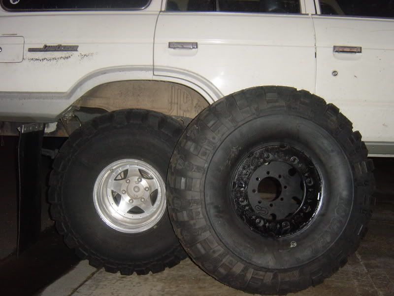

Dora wanted bigger shoes too:
