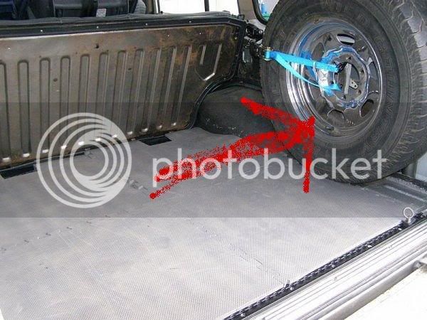

I got some tie-down tracks for a present last Christmas and thought I'd throw them in.
I put some right by the rear seat, on the sides like above, and one at the back. It was originally two tracks but I cut one up to give me a few more mounting choices.

Two questions with these tie down tracks. If you don't mind, where did you get them? Secondly, it looks like they are attached with self tapping screws of some type instead of bolts with fender washers on the back. How do they attach, and how secure do you feel they are? I use a ratchet strap to secure my junk in the back while off-roading, which can obviously produce a ton of tension.
My intended use is the same as yours.
The kit came with both counter-sunk metal screws and counter-sunk fine threads with nylocks and fender washers. The screws are spaced every 6 inches apart and I used the fine threads on the sides and the close-to-seat mounts because I could get to the backside in those locations. I couldn't get to the backsides of the rear most bar and used the metal screws for it. I only put 4 in the rear bar because I wasn't sure if I wanted to cut that one and put a couple of bars in other places.
They have a website on one of the labels so I'll go out at lunch time and get that. I imagine it will have ratings on the website. I will test out the configuration this weekend as all I have is that spare tire racheted down. That seemed solid so far.
those tracks look like the tracks used in helicopters and airplanes for mounting seats and tie down rings. In our helicopters they are mounted with 10-32 screws but I don't know the load rating... Very handy and versatile.
The tracks are called Core-trax and here's the website: Core - Products
It doesn't talk about weight limits on the tracks but does talk about 500 lbs per load lock (accessories page).
I'll see if I can find any info on the instruction sheet that came with it.
