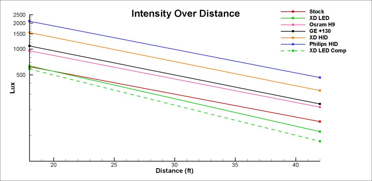

First let me show you an interesting plot from some data I collected (posted in the 3rd Gen headlight thread) that took me a while to comprehend. It is simplistic, but illustrates and interesting point. This was testing various light sources in a 3rd Gen Tacoma projector.
[IMG]
What is interesting here is that all light sources reduce in intensity linearly compared to each other, except for LED. In reality, all light sources reduce in intensity at the same rate, but then why does the data look different for LED? The answer is that when you test LEDs in a halogen assembly at short range the pattern is not fully integrated/smoothed as you are using a bi-directional light source in a housing designed for an omni-directional light source. This essentially creates irregular hotspots in the reading that inflate the LED numbers. So when I test an LED light source in a halogen assembly, I test it at 42' (which is my max practical distance) which allows it to better integrate into the beam for an accurate reading. Diode Dynamics does their testing at 50'. Short distances will artificially inflate the LEDs lux number, and this is especially true for units that are poorly designed to prioritize output over focus making short distance testing even worse for product recommendations. I bring this up because Bulb Facts tests LEDs in halogen assemblies at 12'. The data is not going to be accurate and heavily incorrectly skewed to LED. Its also worth noting that site operates by kickbacks for whatever link you click to buy the recommended product, many LED brands will be willing to give heavier kick backs than a name brand lighting company that isn't going to give any.

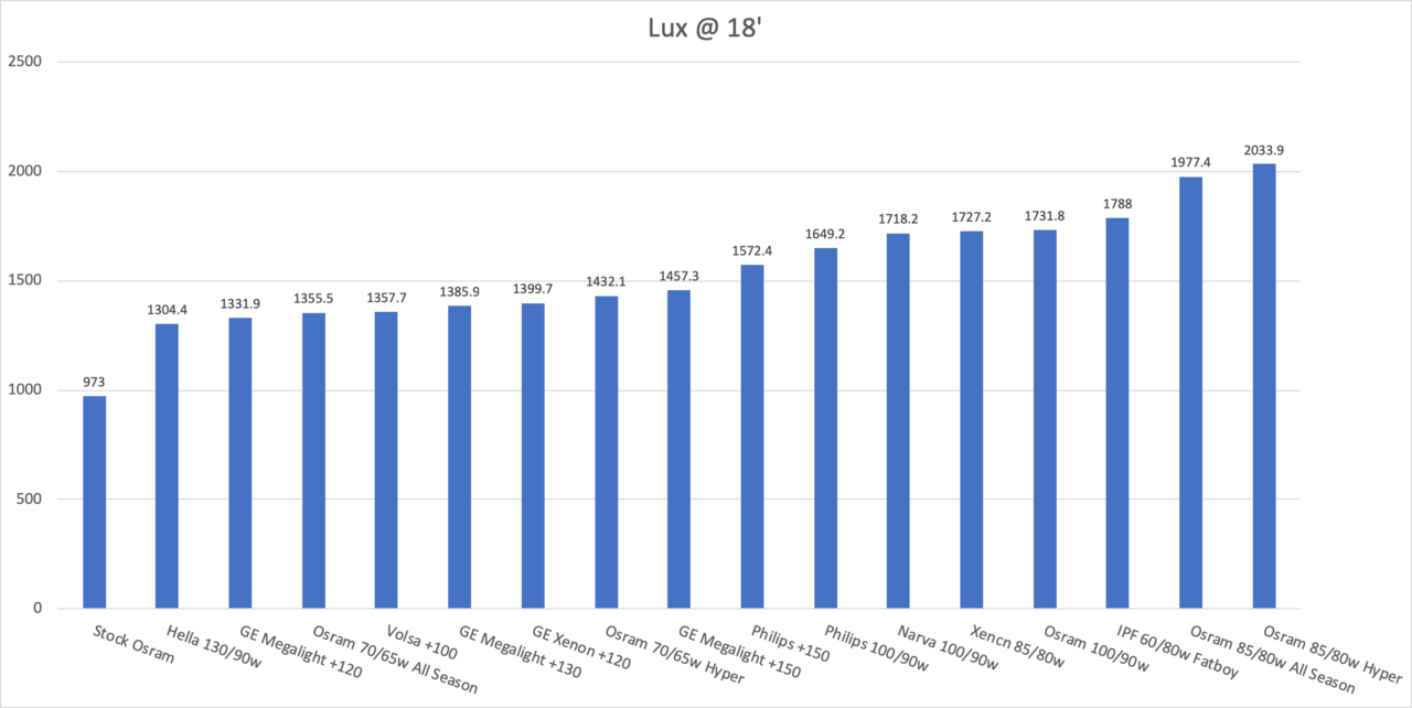

Output is only one part of the equation, a more important part is focus. Take a look at the chart below of low beam testing done on an 2nd Gen Tacoma H4 reflector assembly.
[IMG]
Note the 2nd from the left is a 90w Hella bulb, vastly more light output that the next 8 bulbs to the right that are running at 55w. Yet the other bulbs outperform the Hella in lighting intensity, even though the Hella is putting out far more light. Because all those other bulbs have superior focus and the way you get better focus for higher intensity output is making the light source smaller. With significantly less light output the Philips Racing Vision bulb puts out 20% more light intensity than the far more powerful Hella. This demonstrates how important focus is, and such small changes in geometry of light source size have significant impact on performance. You can see a short article by Philips explaining this works here. But the take away, is that smaller light sources provide better focus which causes to higher intensity output and extended distance projection. Replacement LEDs are larger light sources, much much larger. As an example:

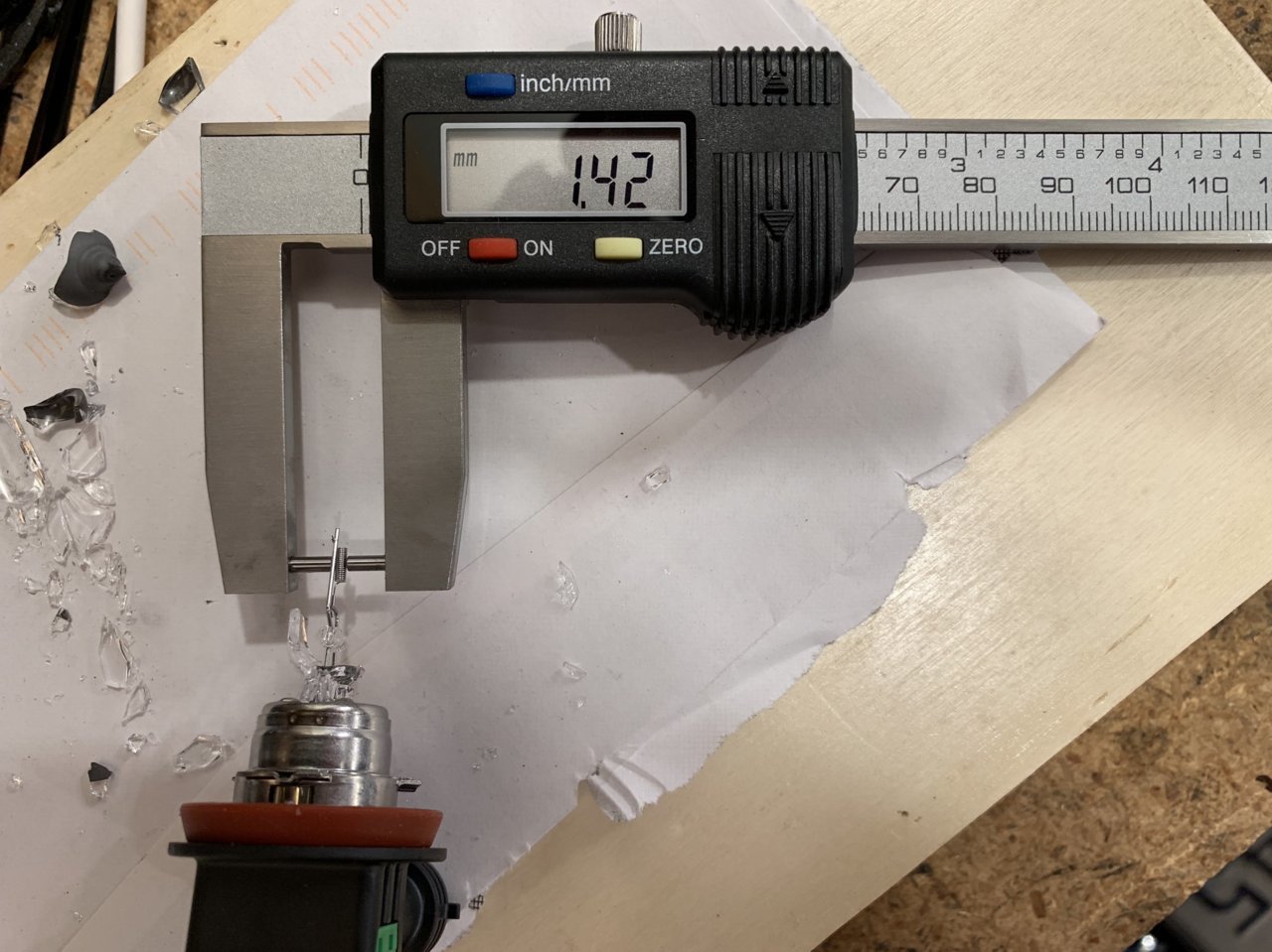

Here is the target width:
[IMG]

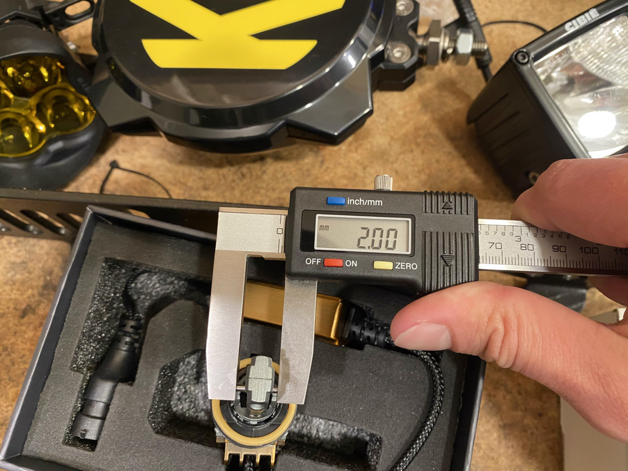

The current most advanced focused LED bulb on the market
[IMG]
Larger LEDs lead to loss of focus, which reduces your hotspot and reduces your distance projection. Instead, the loss of focus shifts the pattern and increases foreground light while reducing distance light. So even though they might be brighter, the additional light isn't used in a way that is beneficial, and can actually be counter productive.

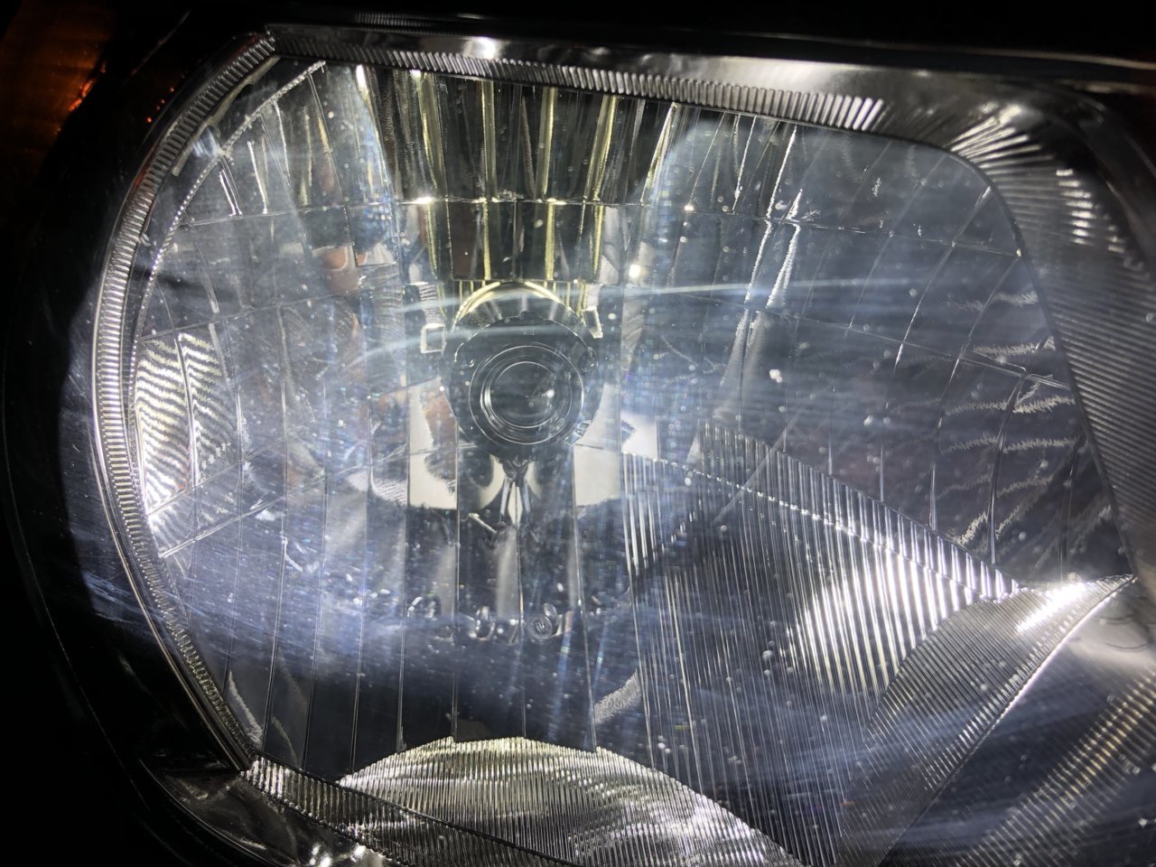

You also run into issues on non-uniform light distribution. Since the LEDs only fire to the sides, they don't light up the whole housing like a halogen. In this picture below on my 2nd Gen Tacoma, you can see the area directly above the LED is not illuminated, because the LEDs only point to the sides. Those flutes not being illuminated means your are going to have areas in your pattern that are not getting light that should be.
[IMG]
The changes in geometry from the LED vs the halogen that the housing was designed for can also cause increased glare to oncoming drivers. Needless to say there is a lot that goes into a light source, and using an LED one in an assembly designed for halogens is full of compromises and generally speaking not a good practice. Replacement LED bulbs have never been legal, but NHSTA banned the sale of replacement LED bulbs for headlights earlier this year, forcing all domestic brands to recall their products. LEDs can work better in some headlight than others, due to their side-firing nature very short and wide rectangular lights are typically best suited, and round lights are typically among the worst.
