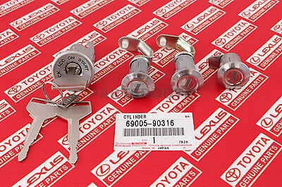

New keys and locks all keyed alike sure would be nice. I did this in Scout and it was so great. New keys and lock cylinders for ignition, doors, gas tank and rear door lock.
Like this...
I looked and I can't find a kit like this for the 60 series. Am I missing something? Is the answer to just get new lock cylinders and then re-key them??
What's the best solution?
