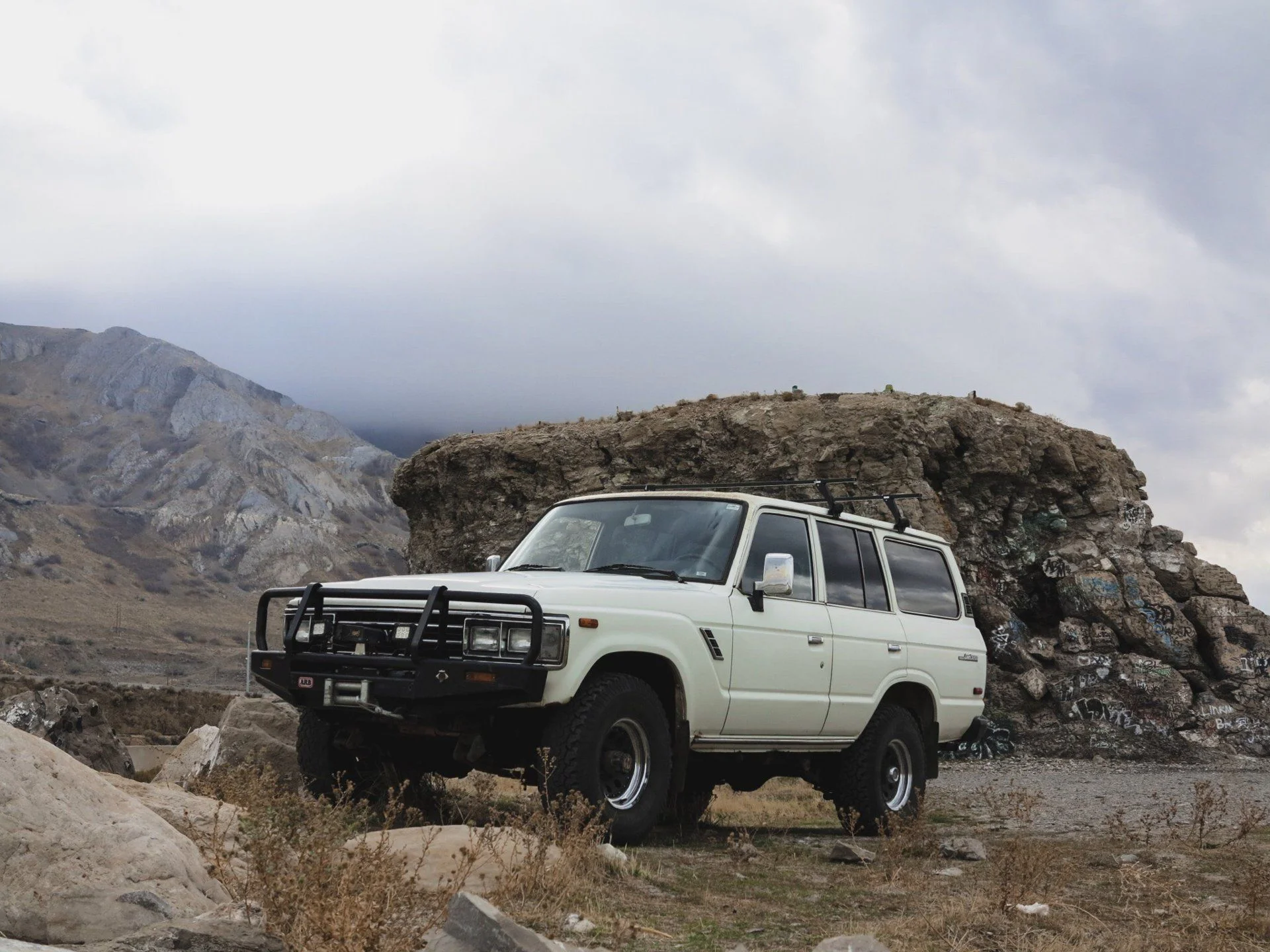

Well, I finally bought my dream car! 1988 FJ62. She's a beaut, but she needs some love. I live in Salt Lake and I'm having a heck of time getting it to pass our super strict emissions. I know this is a very common occurrence for Cruiser owners, and I've used the nifty search tool quite extensively, but I'd like a little rebuttal. She idles rough, right below 500. We did new plugs and wires, changed the oil, ran an injector cleaner through it, and it's not much better. My question is, where should I begin? I'm thinking valve adjustment first, then a leakdown to make sure I don't have blow by or worse, and to affirm the internals are solid. It runs great at freeway speeds (for a slow old Cruiser) it's just at idle that it struggles. The Hydrocarbons were like 600 or something, at idle. The tech who did the plugs said the EGR was functioning properly, and he suggested removing the injectors and having them cleaned by a local shop. Should I do that before valve adjustment? Anywho, I'd love some advice! Thanks in advance! Here she is:
