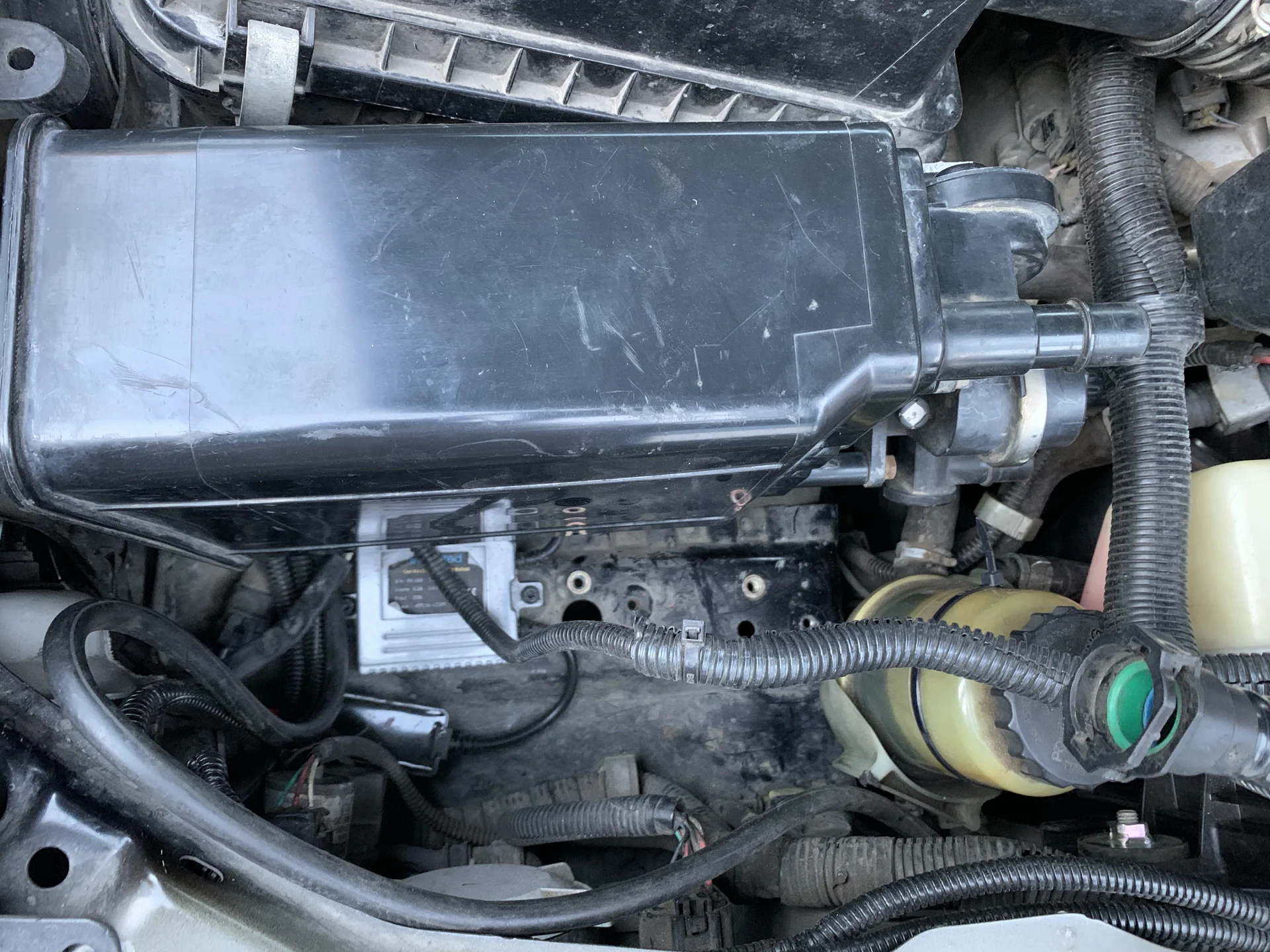

Spent the afternoon making a 36AH size hole in the right front. Moved the charcoal canister back parallel with the air box. Had to remake the brackets and move the PS reservoir over to the radiator.
The PS reservoir isn't quite installed yet, but I've trimmed the bracket and identified where the hole needs to go for the nutsert.
I also managed to drop my last green clip for the Evap hoses. If i recall they aren't available separately, so i've got a zip tie in the channel for now, and it seems to be holding it fine. Guess we'll find out next self test.
This new position has slightly better bend radius for the evap connection and much better for the electrical.
I've got about 4.5 wide, 7.5 long, and 8.5 tall for the 36AH.
