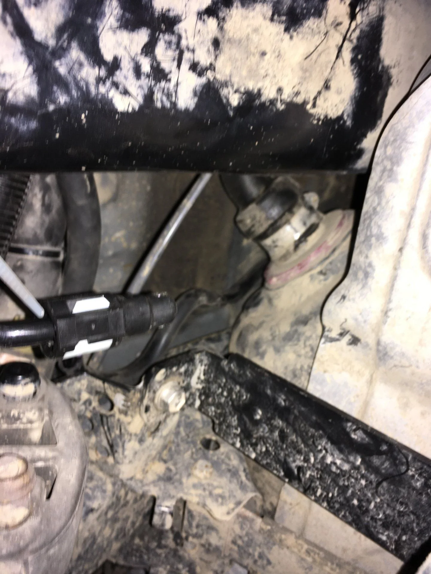

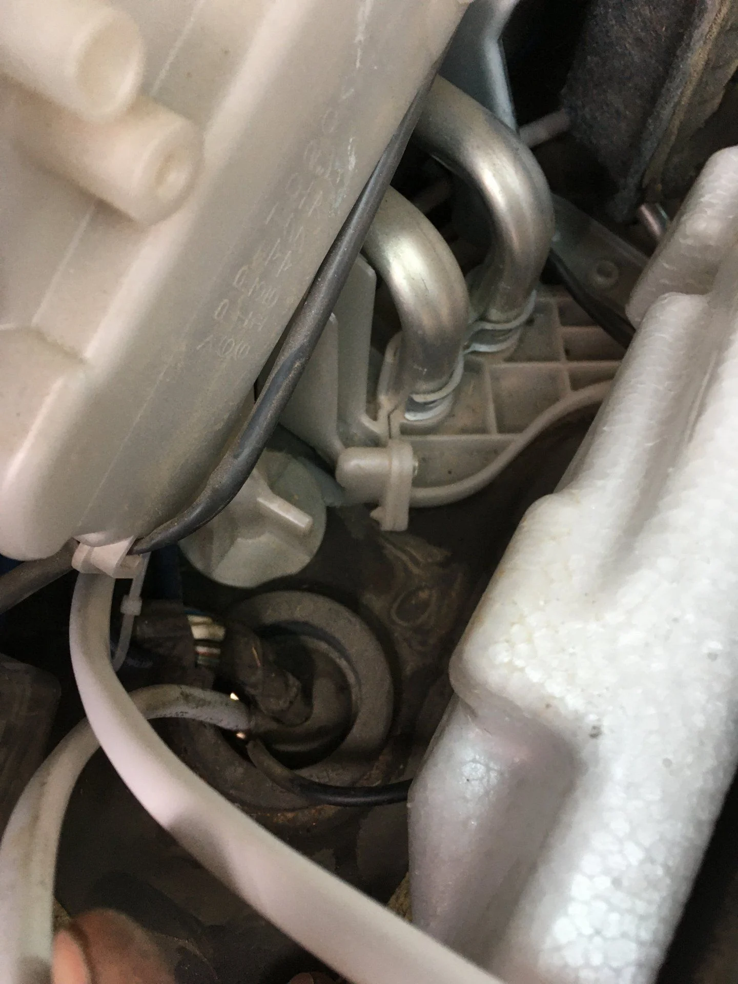

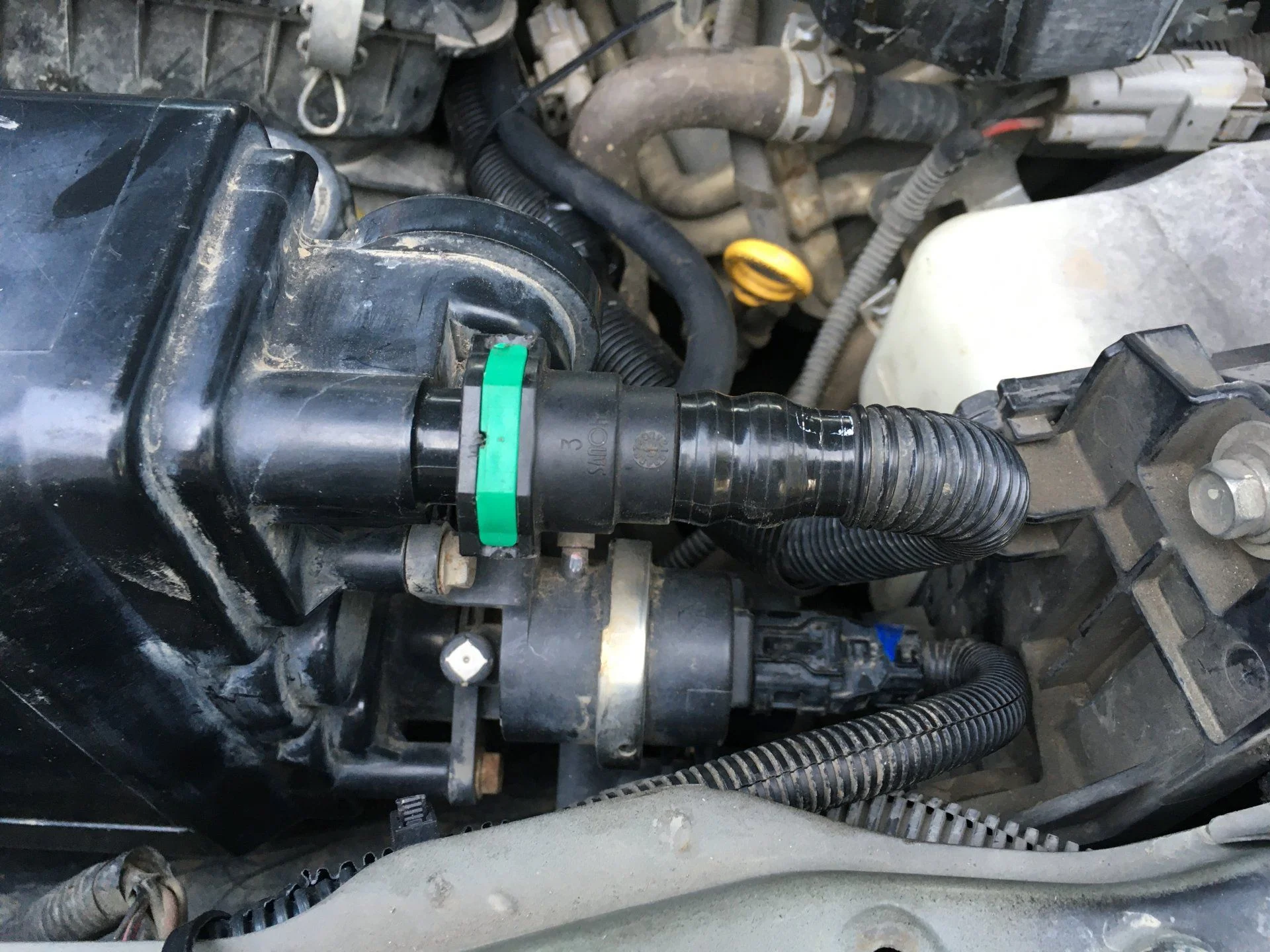

Canister Connector extension.
I used Ethernet cable. I think it would be better to use stranded cable if you can source it. 7 conductors are required.
There are two blue wires. Pin 9 is one, this is connected to a the engine bay fuse box 7.5a efi no. 2 fuse. So the blue wire that traces to that fuse is what you should connect to pin 9. The other blue wire is connected to pin 4.
Double check!
Cut it at back. Connect to your run wire of at least 25 feet.
Connect the pigtail upfront.
Tedious but not hard.

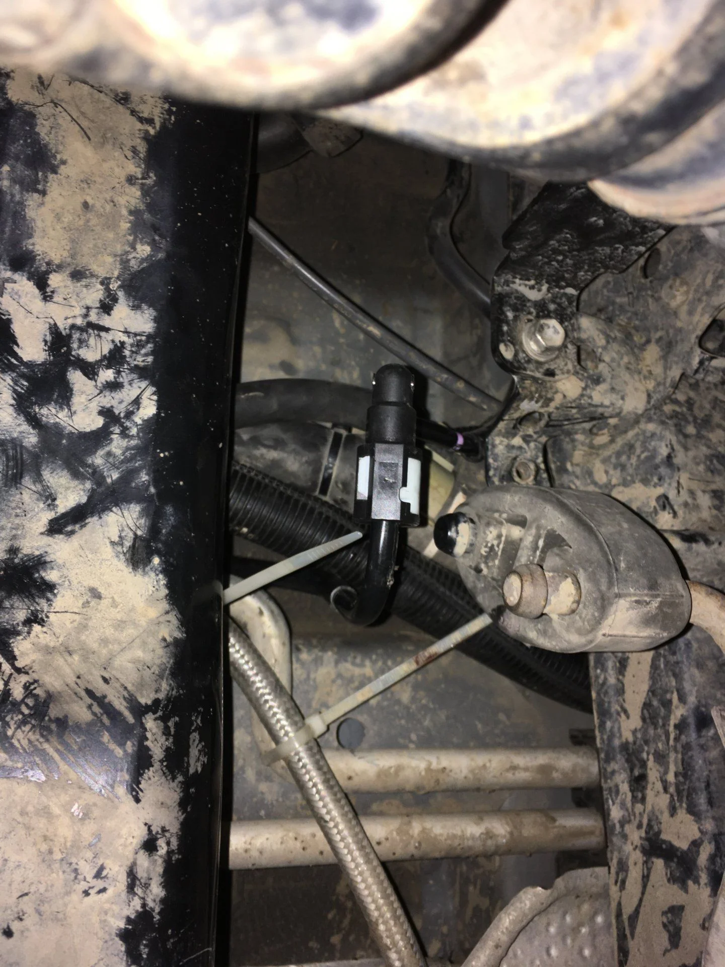

I chose to run this along the side of the engine bay, then along the front support to the canister.
Canister fully installed

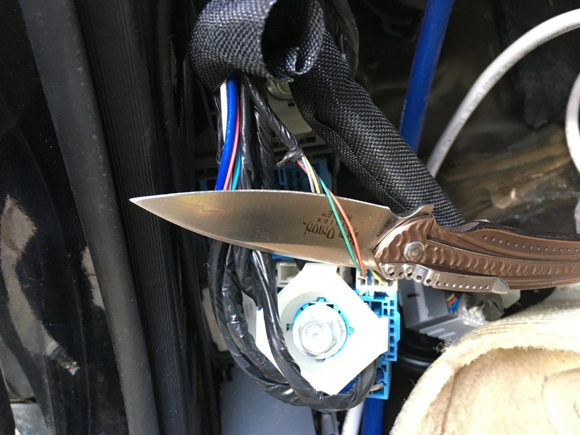

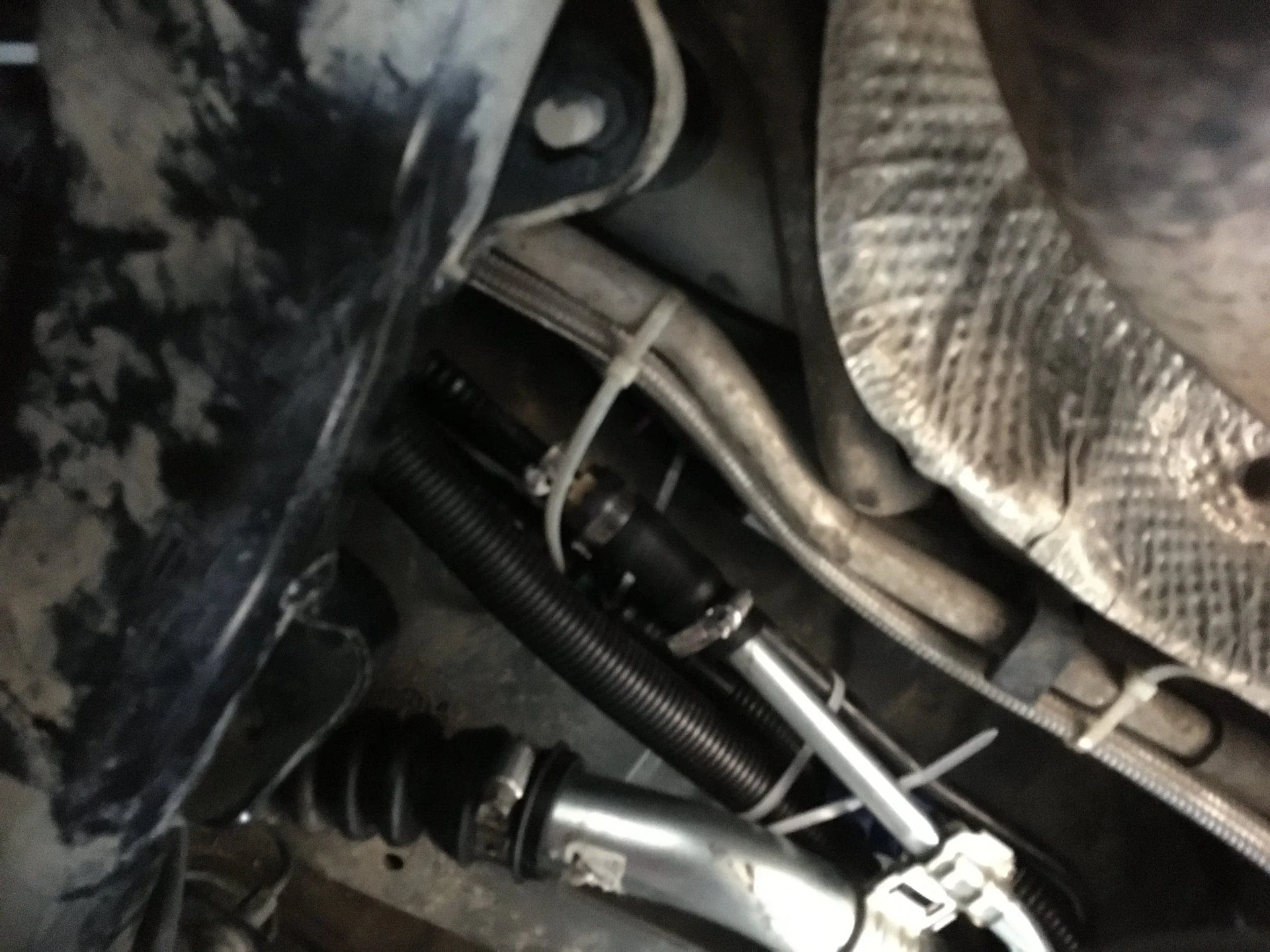

Sender wires.
These I routed up into the body using the left rear grommet. Then along the rear quarter and under the sills to the front. The random 14g speaker wire I had was fine , if way too much gauge.
At the front I found that EK1 had the 2nd sub tank sender pins and in positions 4 and 5, as well as the wires brown and green going to the gauge cluster.
this was amazing news, so I went ahead and cut those and soldered in the run from the back.
No news yet if it works, will need to put in some fuel and watch capacity. If it doesn’t, I’ll go ahead and set the switch up on pins 6 and 7 (black and yellow) as discussed earlier in this thread.

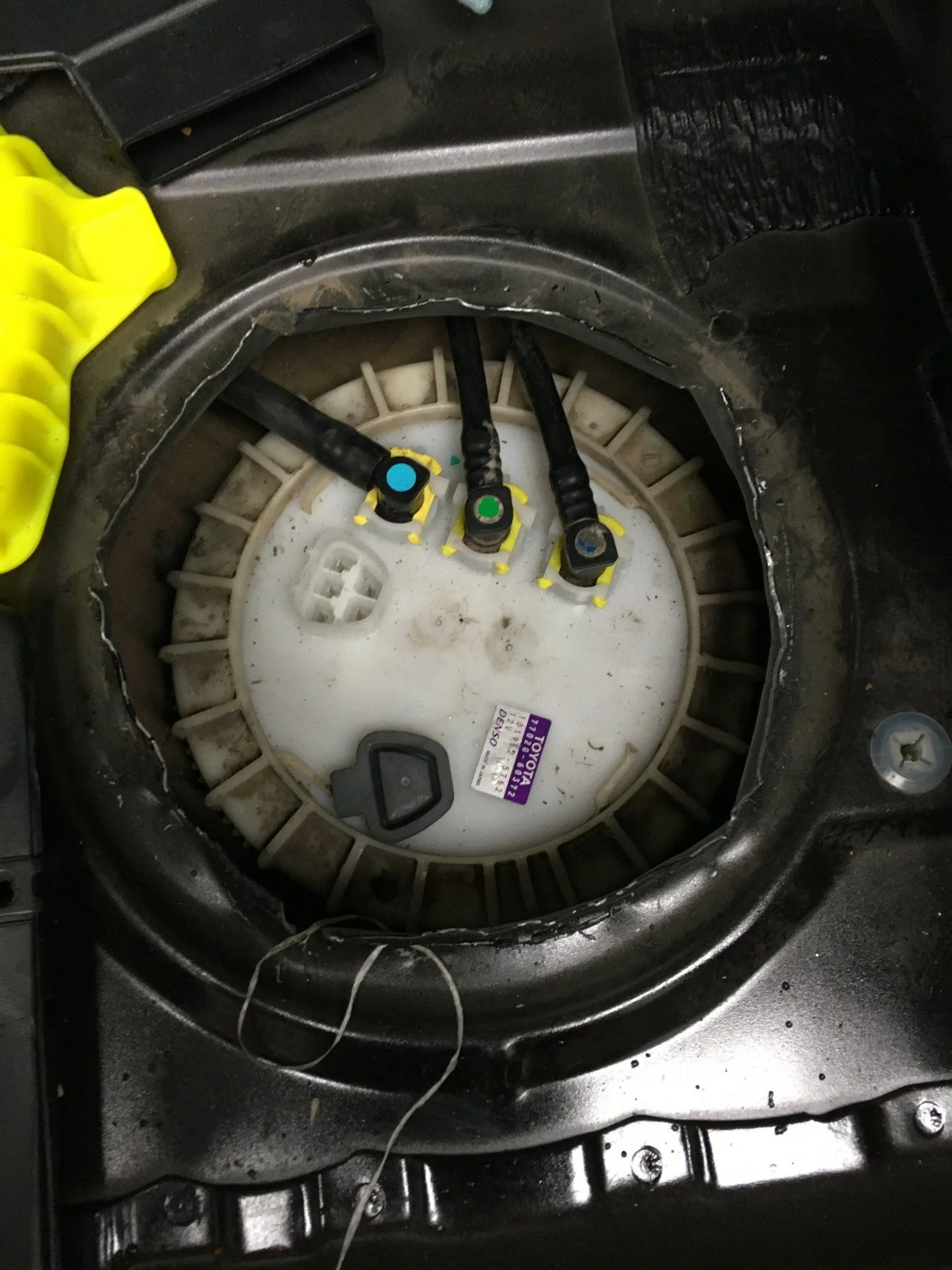

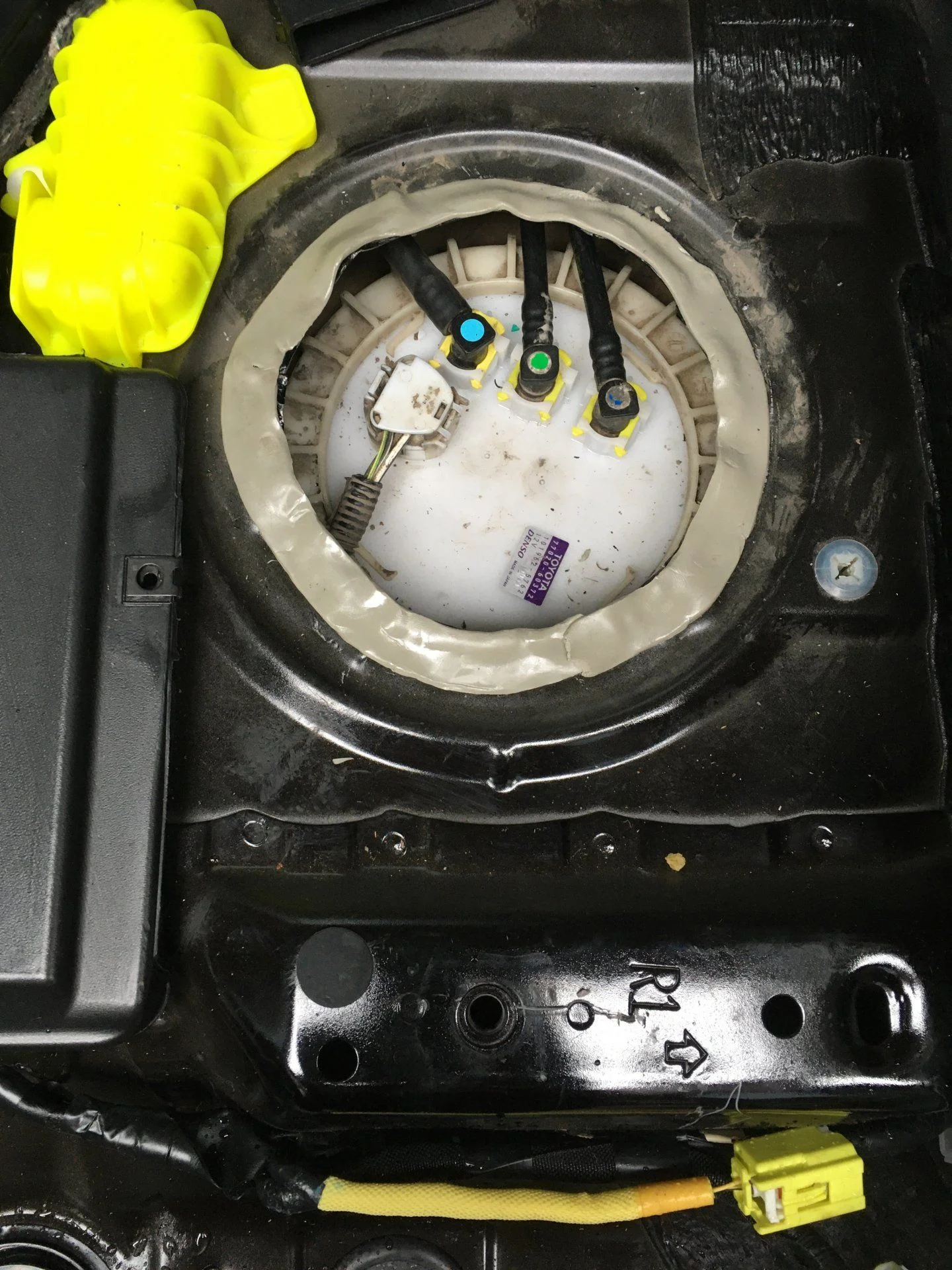

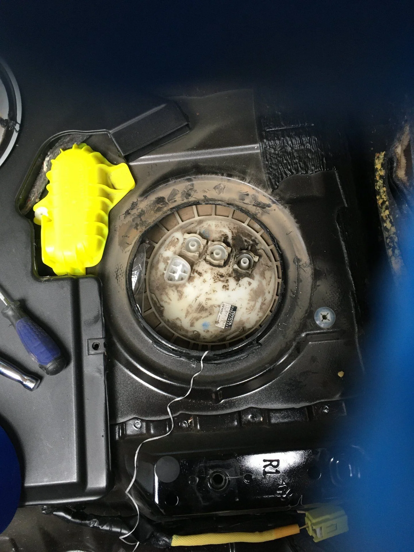

Replacing the fuel pump assembly with one that has the siphon
Release the fuel pressure
Remove the engine room relay block cover.
(c) Remove the circuit opening relay (C/OPN).
(d) Start the engine. After the engine has stopped on its own, turn the engine switch off.
HINT:
If DTC P0230 is output, clear the DTC
(e) Crank the engine, then check that the engine does not start.
(f) Loosen the fuel tank cap, then discharge the pressure in the fuel tank completely.
(g) Disconnect the cable from the negative (-) battery terminal.
Use a tool to loosen the retaining ring. I got a generic one off Amazon for $20. As the hole is smaller than the retaining ring, the fancy fixed size tools won't work, you need to be able to 'tilt' the legs to get it loose. I achieved this by loosening the bolts so the had some play.
As expected it was very tight and required a pipe on top of the breaker bar.
I was paranoid about losing the electrical, so i tied it off, this proved to be unnecessary and it stayed available toward the right door.
The ring can be pushed toward the right door as well.
The two existing hoses got pushed toward the back.
The little yellow clips did not break, but I bought new ones and used those instead. They cost $1.50 each. I suggest buying at least one extra in case you break or lose 1. I lost one on reassembly.
I then cut the sheet metal in 5 places about 1/2" and bent it up using pliers.

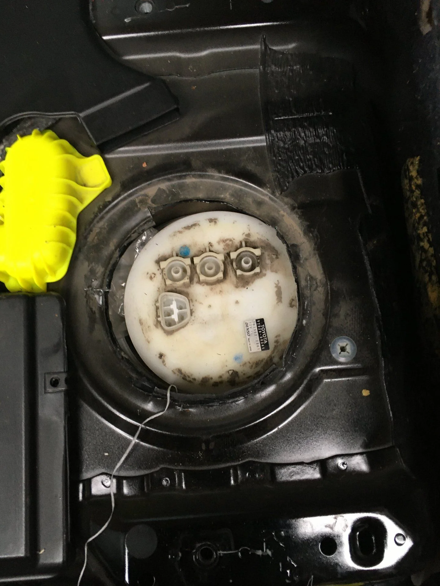

Then you can pull out the pump assembly.
Pick out the old gasket and install a new gasket. coat with fuel.
Put in the pump assembly - you can rebuild with the new siphon parts or order a full new assembly. After looking at it a rebuild should be quite achieveable, but I have a high mile rig so went ahead and got a new pump.
Reattach the ring. make sure to line up the slot toward front of vehicle and make sure to keep it under tension until the ring is tight.
Reattach the two existing hoses. Feed the new hose up from the sloping back of the main fuel tank. It goes over the crossmember. Shove it as far as you can from below.
Then reach it from inside the fuel pump access. pull it up and insert.
Reattach the electrical.
Bend the material back into shape. Reflash with new butyl tape. I chose to heat mine some to make it more pliable. Stick the lid on.

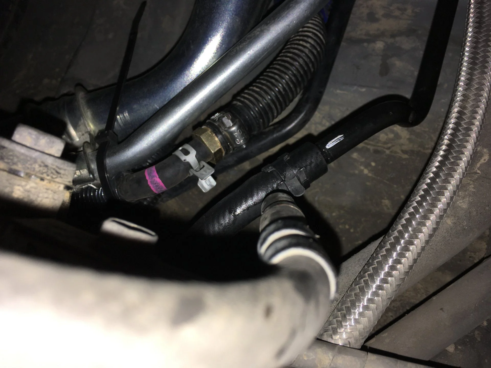

hose run detail
Vents, starting with main tank vent
main tank vent 6mm - cut toward end where fancy fitting is, cut at the small diameter, not the flared fitting diameter
1/4” brass barb into main tank vent.
5/8” brass barb into short piece of 9/16” hose then onto 14mm filler hard pipe
toyota vent hose filler to sub tank
toyota vent hose sub tank to new filler
evap, starting with main tank evap
main tank evap 15mm - cut AFTER first joint. No need to undo the green clamp. Cut at the flat place to make clamping easier.
5/8” brass barb into evap hose
1/4” brass barb into purple Toyota evap hose into subtank
green Toyota evap hose out of subtank
fit green evap hose to previous manifold hardline
(now in engine bay)
fit 5/16” fuel,hose to manifold hardline
fit 5/16” brass barb to fuel hose approx 8 feet
fit 3/4” brass barb to 3/4” hose 2” piece
join to charcoal canister fitting
filler
Main tank filler hose stretched onto new filler pipe
Sub tank new filler hose from new filler neck
canister to manifold, in engine bay
5/16” fuel hose on manifold valve, approx 8 feet
5/16” fuel hose on canister fitting
canister to air filter
3/4” hose on canister
3/4” hose on airfilter

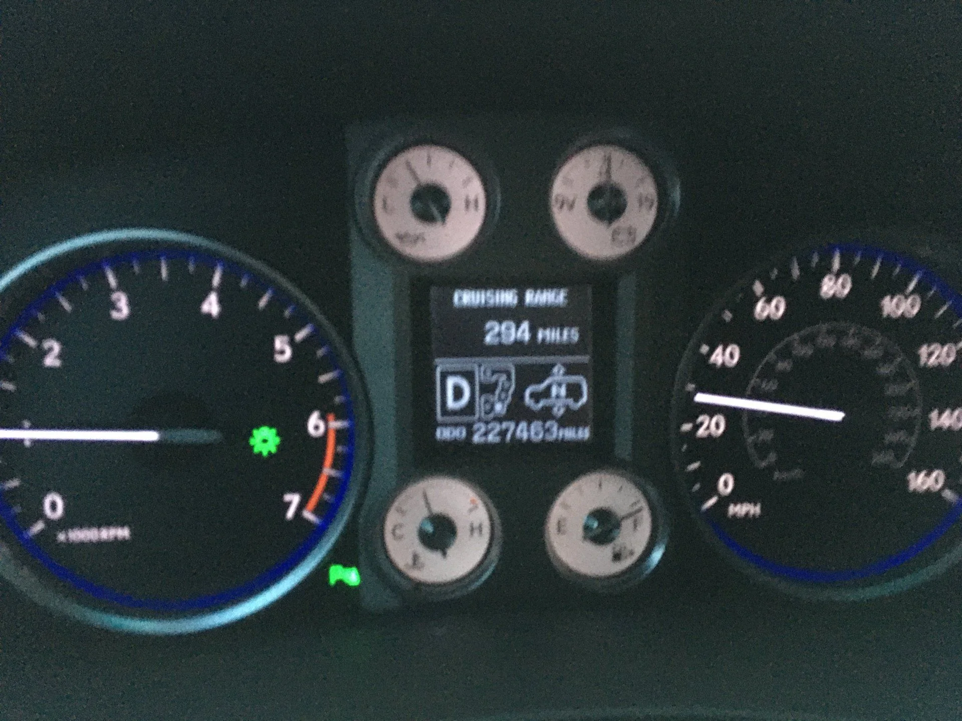

Awesome job, I’m excited to see if the fuel gauge works. Where did you get the pin out diagrams?
Took it for a shakedown cruise. It’s been a month since I drove the truck, don’t remember what the fuel level was, but I don’t think it’s different.
Everything seems to work, but I didn’t fill up the sub tank as the weather took a turn for the worse and I didn’t want to be stuck outside trying to fix any issues.
I have one persistent code - check 4 wheel ahc system. I’m working on fixing my Mac tech stream and I’ll work on that, I did bump the reservoir a lot trying to get the new filler in, so might have jarred a connection loose.
No fuel related dtc.
I also completely flatted my battery (4v) so there may be some issues related to that too.

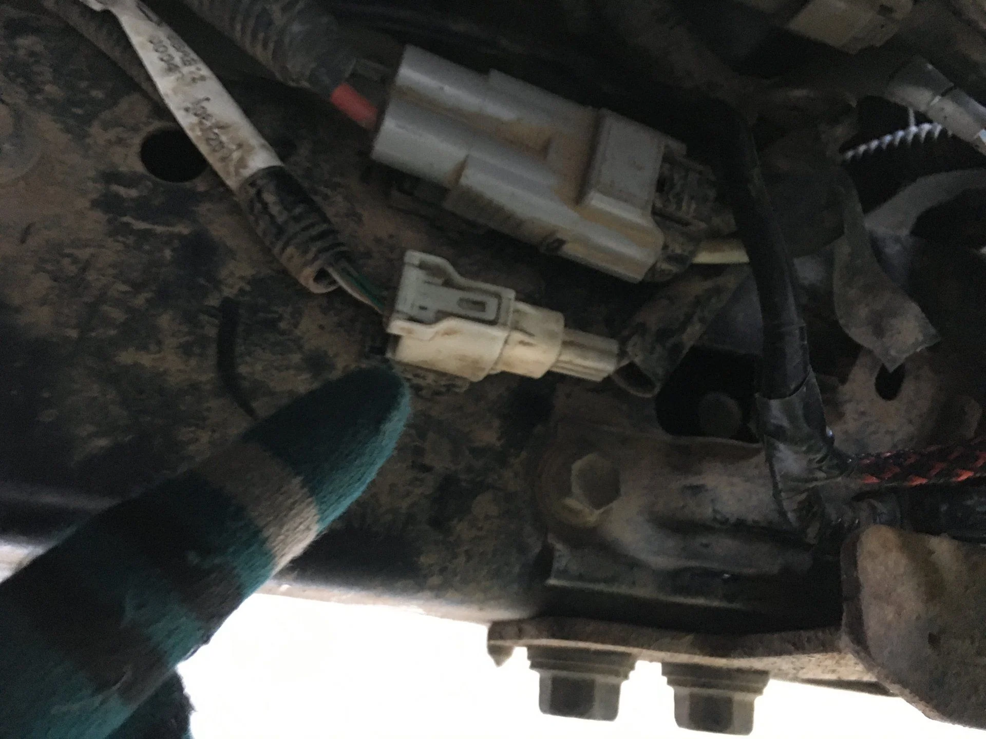

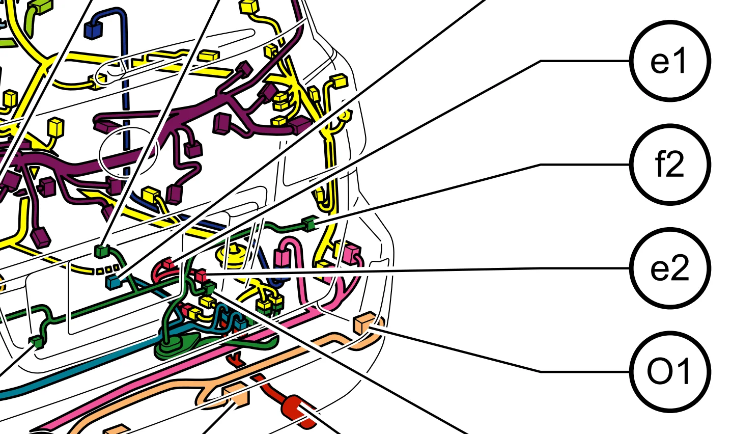

Clearing the DTCs I had.
C1718 Pressure Sensor Circuit Malfunction - connector e2
C1719 Oil Temperature Sensor Circuit Malfunction - Connector e1
Both of these are AHC codes
Both have check connector/circuit then replace AHC ECU as resolution steps
I looked at the connector chart and it is the red items in the attached image. I remember the connector where the red and yellow join well, I undid it to make sure it didn't pull out during the body lift. Both e1 and e2 run off this connector, so I was pretty sure what the issue was going to be. It was either not reconnected (doh!) or not firmly seated.
On visual connection it was connected; so I pulled it open and reinserted firmly.
Quick restart confirmed that the MID no longer is displaying the error.
Simple fix and this was not related to the sub tank in any way, just normal stuff that could happen during an install.

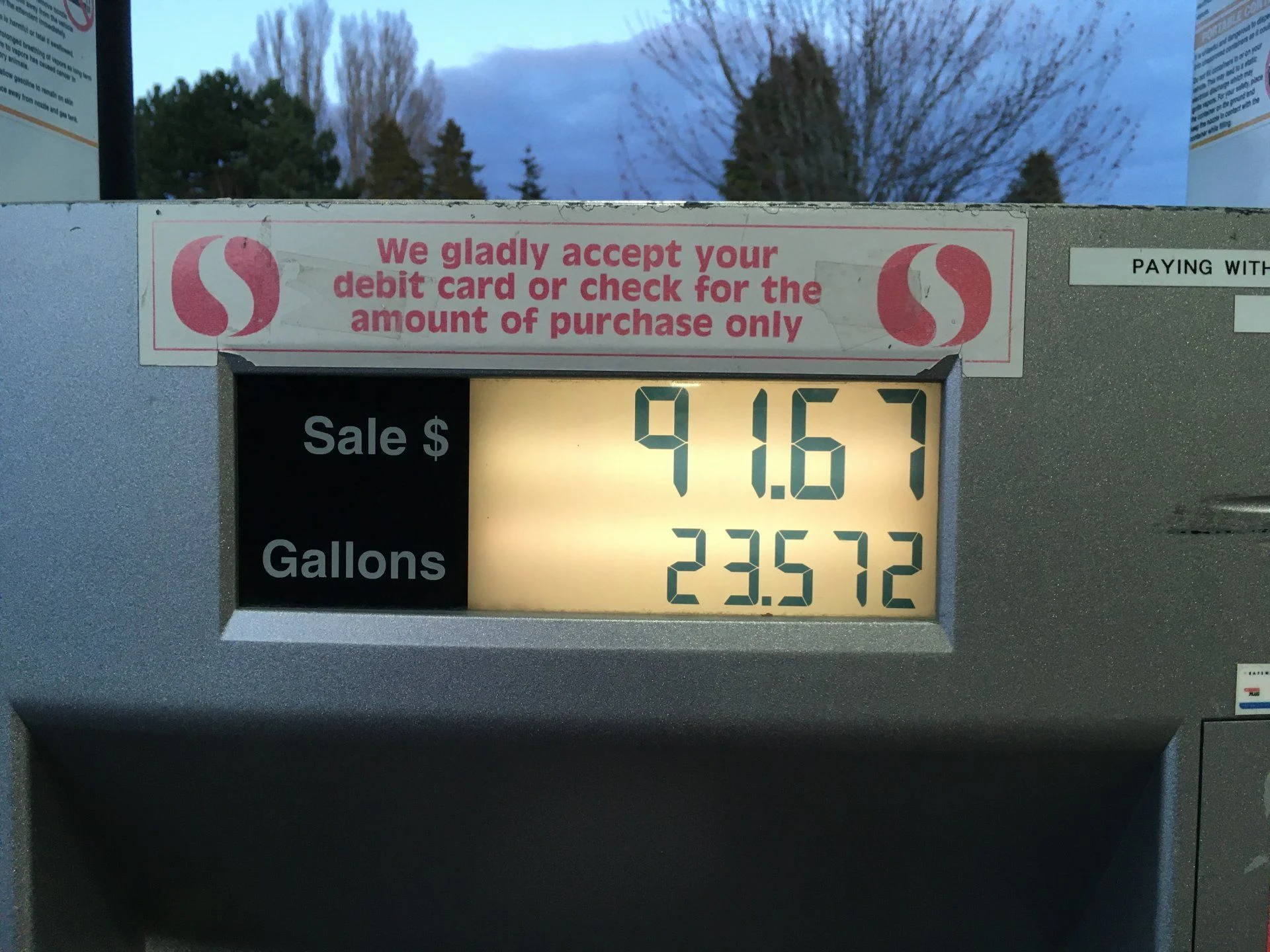

Fills up good.
No click offs in 23 gallons delivered.
Sub tank Sender isn’t measured. 🙁
No change in full range calculations and gauge was at half full before adding 23 gallons. Total Capacity Around 36 gallons confirmed.
price of gas is up!
