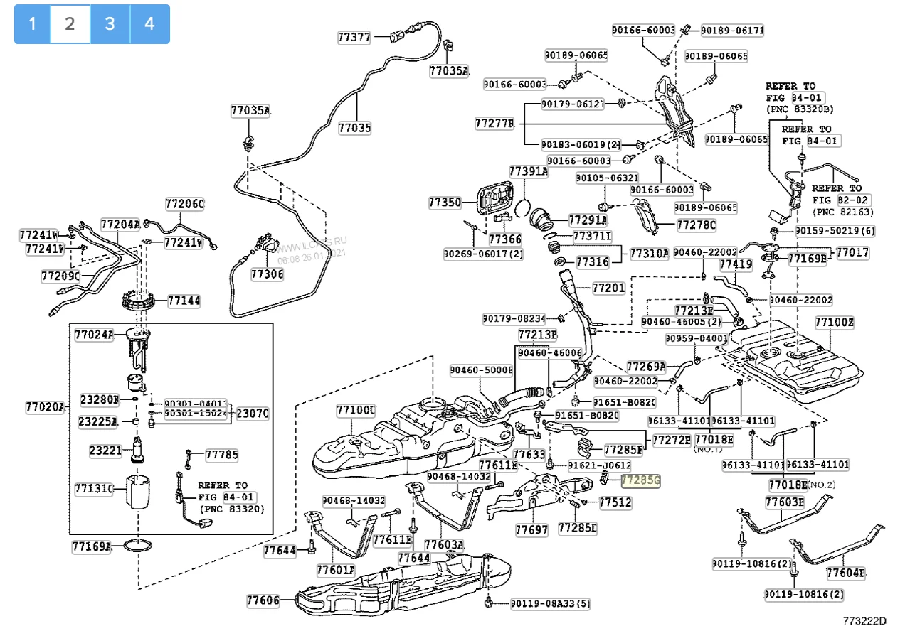

Here's the relevant picture, I believe from PartSouq
Of course the little yellow clips, a new gasket, etc as well, these are on the parts list I posted up.

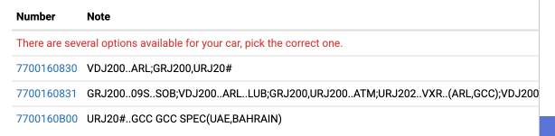

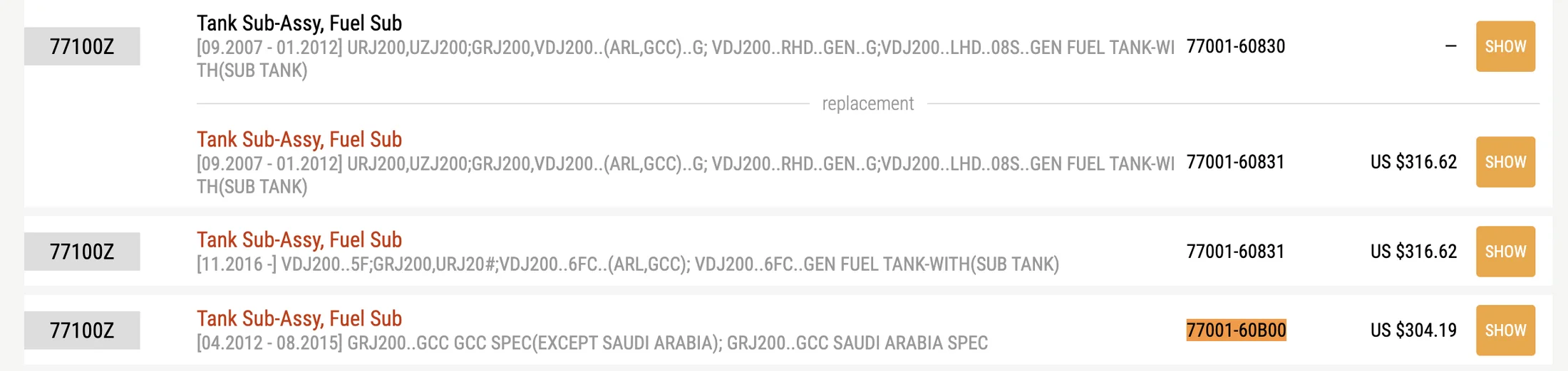

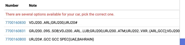

@grinchy Any idea on the sub-tank part # 77001-60B00?? In post #18 you are referencing it. Per some parts catalog it is "GCC SPEC".
And Partsouq does not indicate it interchanges with 77001-60831, one you got. On the other hand 77001-60831 is indicated as subtank for both diesels (VDJ200) and gas V6/V8 (GRJ200/URJ200).
Please use post #213 for the parts list.
There are various regional part numbers, particularly around the fuel and evap parts, for all the various regional EPA type laws. I can’t say what the differences might be , but they’re likely small and won’t matter for our installs, as long as you are keeping to the same region. For sure the ROW evap canister and evap flow is different than the US flow, but we can make do by manual connecting the evap piping to create a grand loop thru both tanks before heading out to the evap canister.
As far as sub tank part number, I suggest the one for the model year you’ve got. I have a 2009, and got parts/supersessions from that model year.
