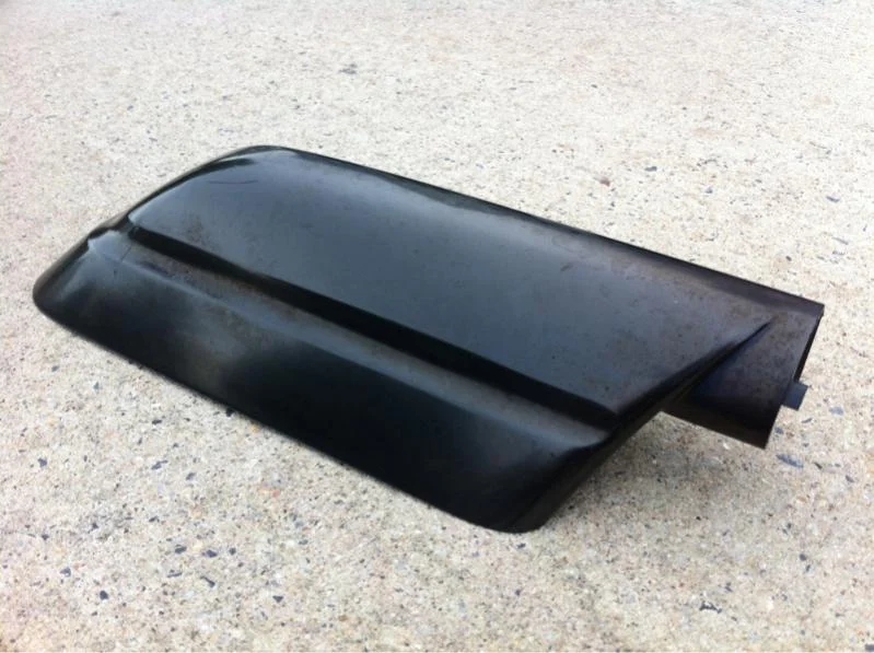

Unless I misunderstand, no it's one big long cover, with multiple rectangular openings cut into it. On some trucks there are 2, others 3, but I haven't seen any 4's... you can't piece meal the cover pieces between the towers though, as it's all one unit- sheet metal on the bottom, some type of thin plastic on top.

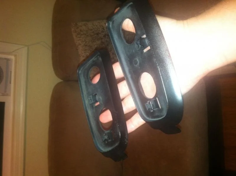

The rubbery-plastic-ish bottom foot on the roof racks... is it the same on the LX to the LC? Also, anyone have the Toy PN's for this? I need the 4 corners if it's the same and in black.
Painted my LX feet and they look great in terms of color but in general the parts are old and decrepit.
